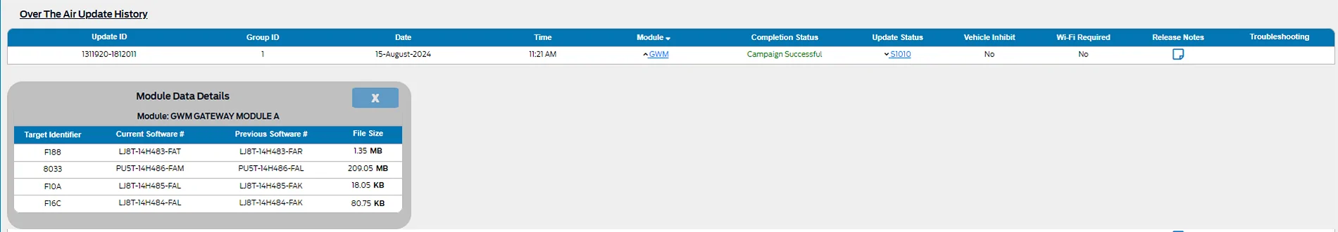

Mike, I’m trying to keep these OTA issues straight in my mind. By bricking the car, are we talking about 12v drain, or lock out, or both, or neither, some other fault? I’m curious, what persuades you this ECG is the fix? Thanks
This relates to '23 and '24 models with lockouts as a result of a previous OTA for the gateway module. This is the corrective action, either by your car receiving OTA ECG-24.2.4.10.2 or getting somebody with FDRS to update your gateway to the "-FAT" software revision.

Thanks. My impression is the 12v drain issue may affect all model years and is unrelated to the lockout issue. Do you know if that is correct?
Is the -FAT update the first on this list?
When software module revisions are discussed (with the exception of the APIM) the F188 DID is used as the reference designation for the revision. So most of us just refer to the last three characters to denote what update we’re talking about. And the -FAT is the first file in that list.
