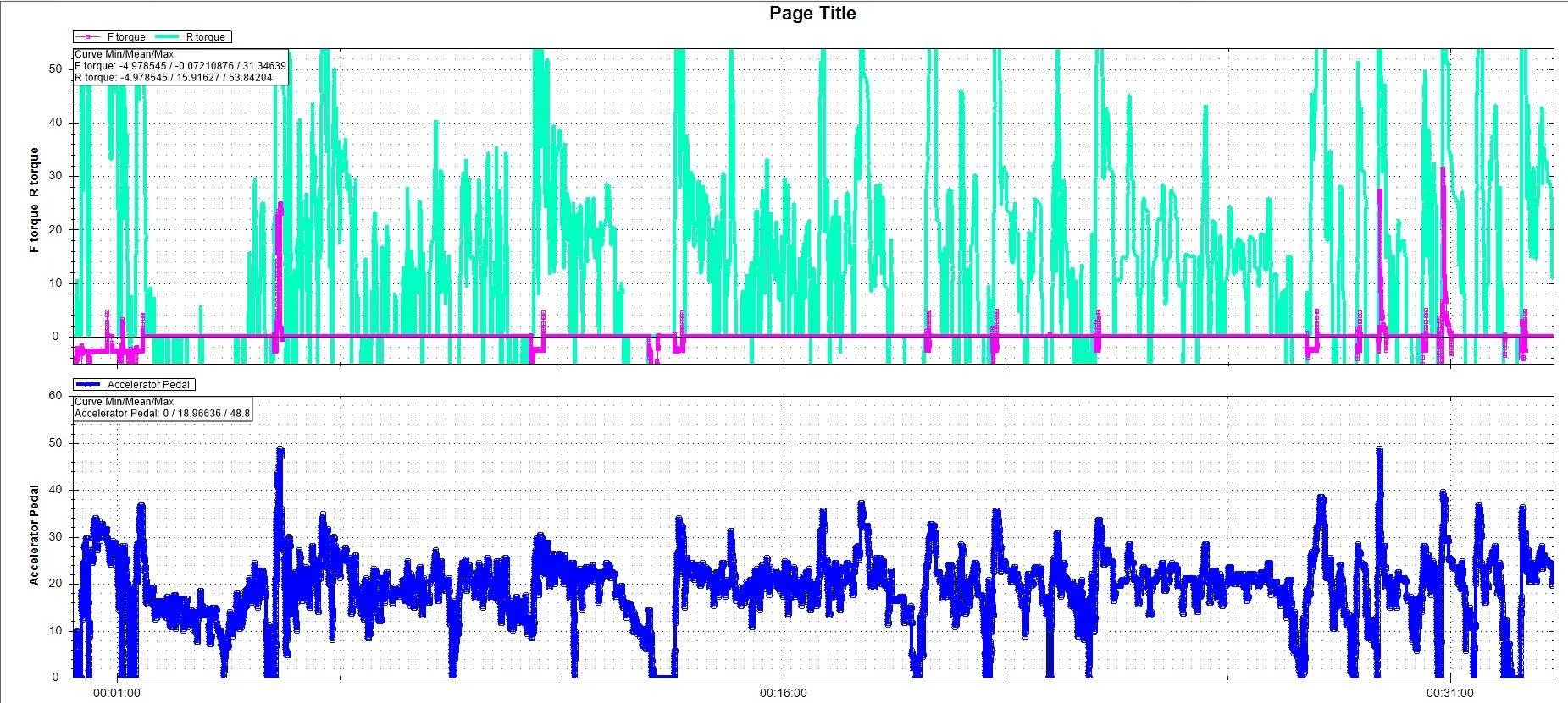

the 3 and Y are 100% RWD unless there's traction loss to the rear tires and/or more aggressive throttle is applied. Generally the front motors aren't generating power until 20-25% throttle and even then, it's minimal.
Below is a graph showing when the front motors are active (pink). Teal is the torque from the rear motor. Blue is the throttle position percentage. This is a 33 minute drive, normal driving. Ambient temp 26F, motors and batteries are pre-conditioned for 18 minutes and were at normal operating temps for winter. Over 33 minutes, the front motors activated 15 times. Of the 15, 12 they barely made more than 5 lb-ft torque. The other 3 times were accelerating from a complete stop from 0 to 55 mph.
One thing going against the Tesla 3 and Y is how aggressive the stability and traction control is when traction is lost. This will be fixed on the MYP once they release track mode, but long range owners won't get that feature.
That's actually a really smart feature for conserving range. I wish Ford did this. I think Hyundai (?) announced its upcoming prototype would have a similar feature, but the front wheels would be disconnected via a clutch so they'd completely freewheel unless more power demand or a traction loss was detected.
But again, to make a car RWD biased, you're not talking just about when each motor is active. To get into an oversteer scenario, you're generally way above half throttle anyway (so both motors would be active on the Y), and on a turn, where weight transfer, suspension setup, traction, and center of gravity all come into play to determine how the car will handle.
Until someone shows actual data on how the AWD functions in normal and aggressive driving conditions, no one knows on the MME. Pretty much everything is speculation at this point.
I don't think Ford can do this because of the type of motor it's using in the front.
We've seen a number of reviews, some by people with extensive experience with the MY. Perhaps not definitive but way more than "speculation".
