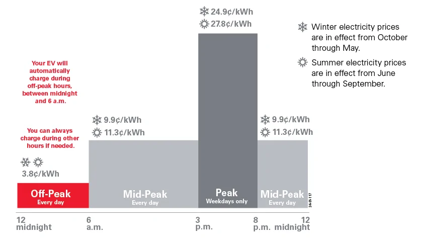

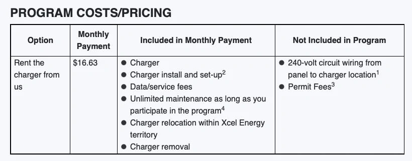

I live in Minnesota and am having my L2 charger installed tomorrow. My power company (Xcel) has an EV charging program for off-peak charging discounts. I was curious about what others thoughts are on these rates and how they compare to others. Here is the plan:
Ford Mustang Mach-E EV home charging programs 1719409311769-nr
Without this plan, energy is $0.13/kWh for reference.

At some point I'll probably buy my own charger and bring the program cost down to $6.73 a month. I'm currently renting my home and new to this whole thing so figured to start I'll just rent the charger.

It all depends on how much you drive monthly. The differences between $0.13 and $0.038 is $0.09. Monthly cost of $16.63 divided by $0.09 is about 184.77 KW. Use 185 KW multiply by 3 miles per KW, it’s about 554 miles that you would drive just to break even by signing up the monthly plan. If you drive more than that, then it’s worth it.

Something to consider is the required duration of the plan. I would certainly look into it as purchase and installation can easily run over $1,000 and can approach $2,000. At $16.63 per month you may be getting a bargain especially when the energy savings are also factored in along with the time value of money.

It's simple math to figure out what makes the most sense. Depends how much you drive.
Let's assume you drive 500 miles a month.
500 / 3 miles per kWh = 167kW / .9 (for 10% loss) = 185kW.
185 x .13 = $24.05
Or
185 x .038 + $16.63 = $23.66.
About the same cost, but you didn't have to buy a charger.

Looks like they have a rent to own option involving paying off the remainder of the cost to lower the monthly down to that $6.73 so I will absolutely take advantage of that. Plus they also will have someone uninstall it and reinstall it at my new place as a part of the program!

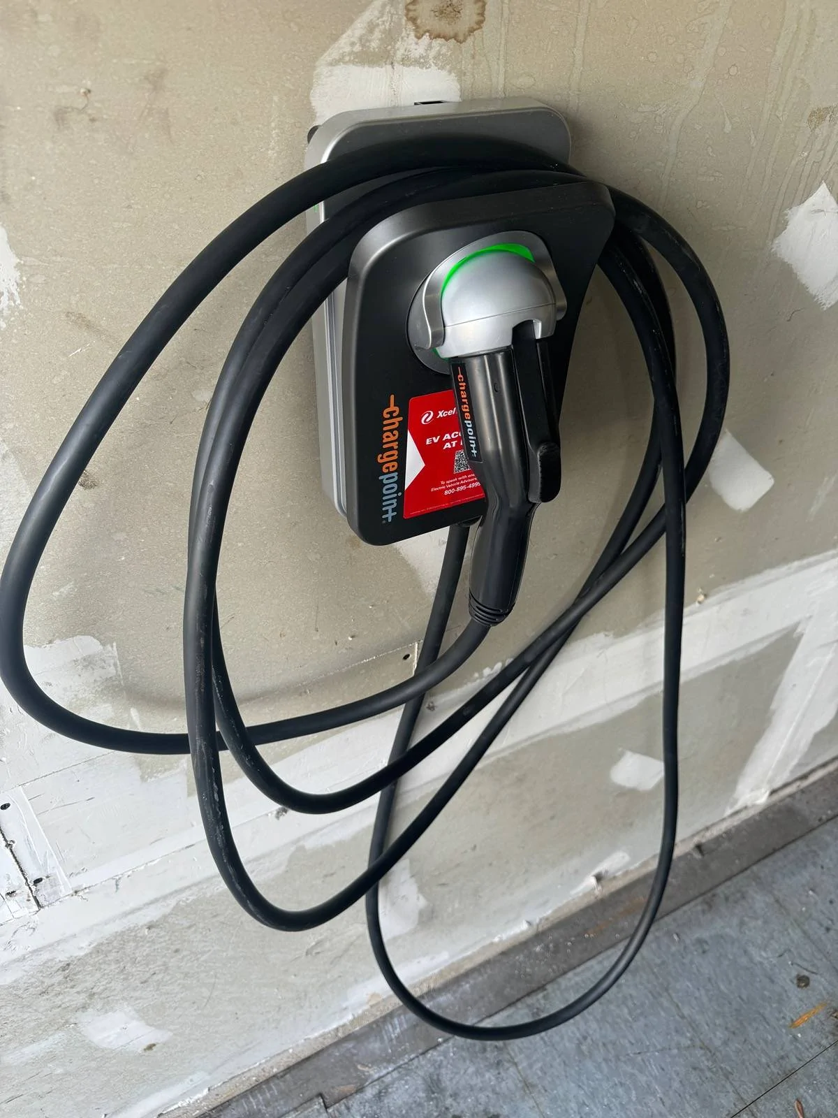

installed and ready to go as of this morning!
