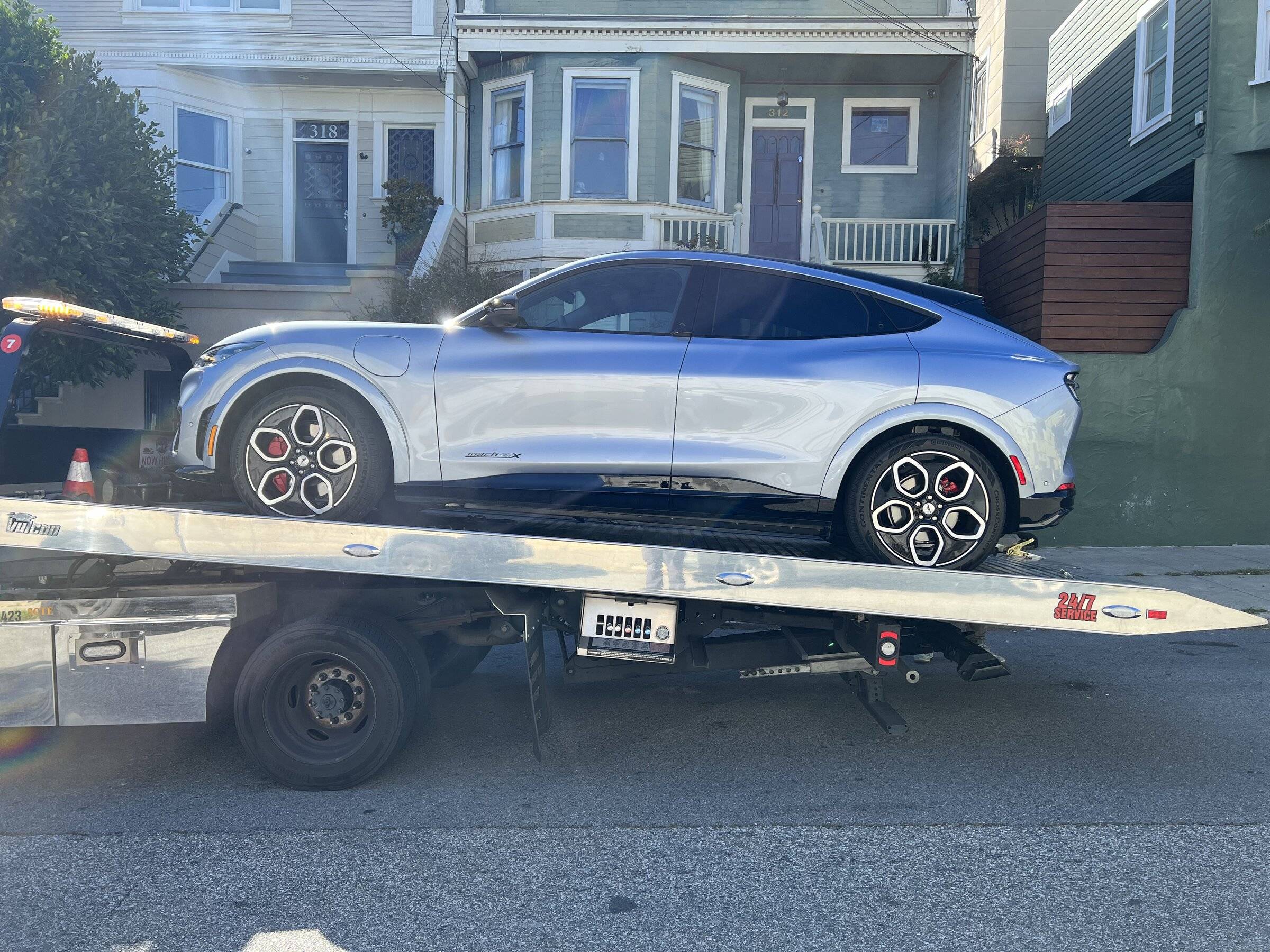

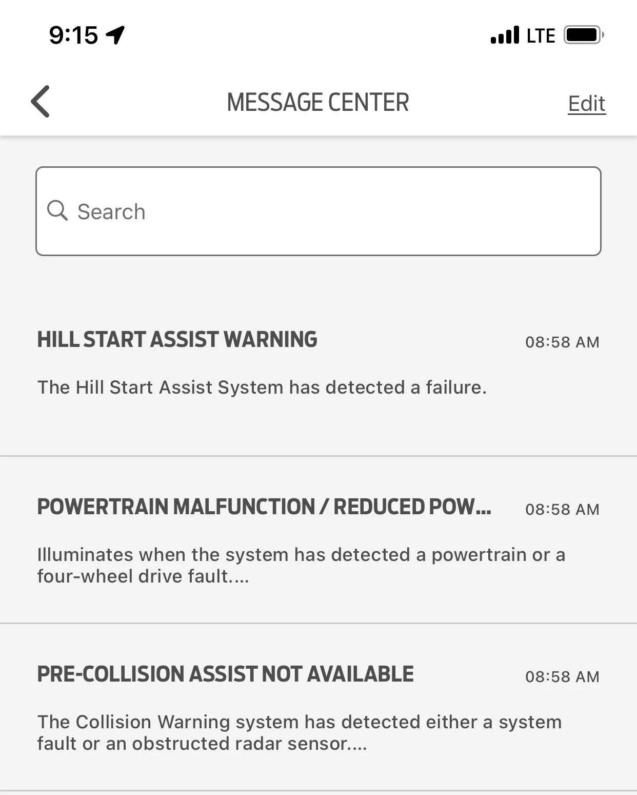

Today was not a good day. My wife and I were about to head out to run errands when I pulled out of the garage and my two and a half day old Mach E GT threw up literally a dozen serious errors:
Hill Start Assist Not Available
  • The anti-lock brake system has a communication problem
Pre-Collision Assist Not Available
  • The Collision Warning system has detected either a system fault or an obstructed radar sensor
1 Pedal Drive fault / Press brake pedal to reduce speed
Service AdvanceTrac
Antilock Brake Fault
  • The anti-lock brake system has detected an issue with signal from Front Wheel Speed Sensor LH
  • …issue with signal from Front Wheel Speed Sensor RH
  • …issue with signal from Rear Wheel Speed Sensor LH
  • …fault with the Street Wheel Position Sensor signal
Blind Spot Detection with Cross Traffic
  • The side obstacle control module has received invalid data from engine control/powertrain module
  • …received invalid data from anti-lock brake system control module

So the car was flat-bedded to Dealership #2 that Ford CS found and will be looked at first thing Monday. Ford Roadside Assistance did their job, was able to switch the car delivery from Dealership #1 to Dealership #2, and overall were helpful.
The service manager (literally the best I've ever dealt with anywhere) at Dealership #2 was able to look at my car's computer in realtime while it was being taken to the dealership, confirm the problems, and immediately authorized the car rental and got it set up. And since the car rental was closing soon, he called them to confirm I'd arrived, and he also called me to let me know when my car arrived. And he'll be taking care of a cosmetic issue with the car that I discovered after delivery, coordinating with the selling dealership (100 miles away) to get it all done.
