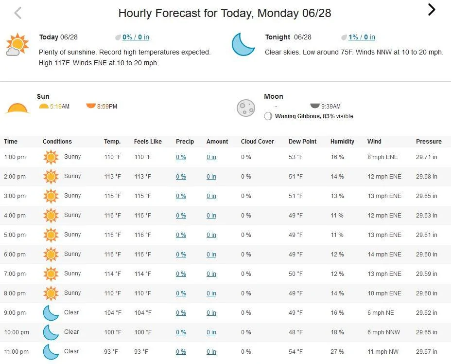

We cooled down to 104F at 10 PM Should get down to mid 80's or low 90's tonight. If I didn't have a heatpump in my house I would be sleeping in the car. ;)

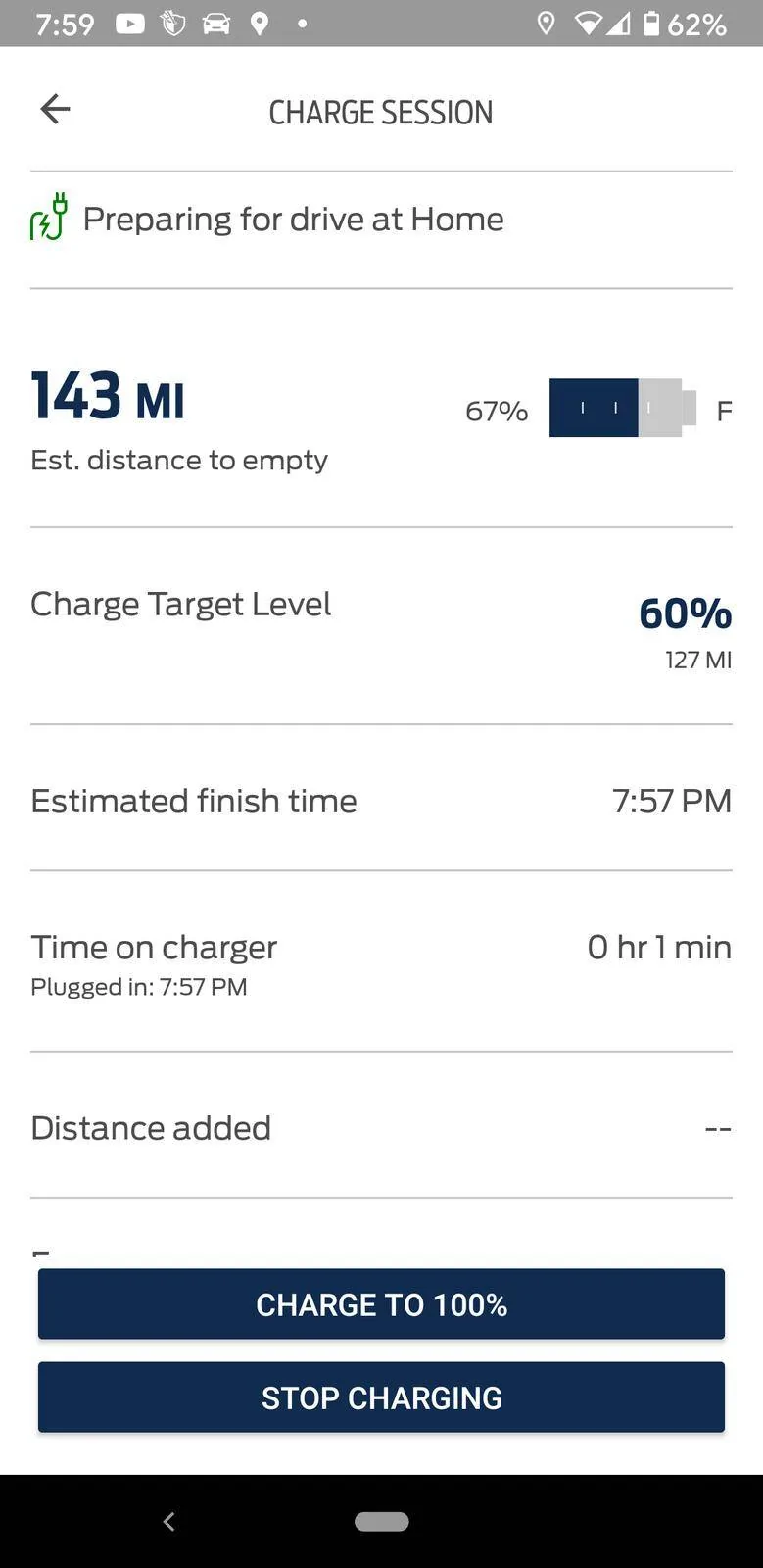

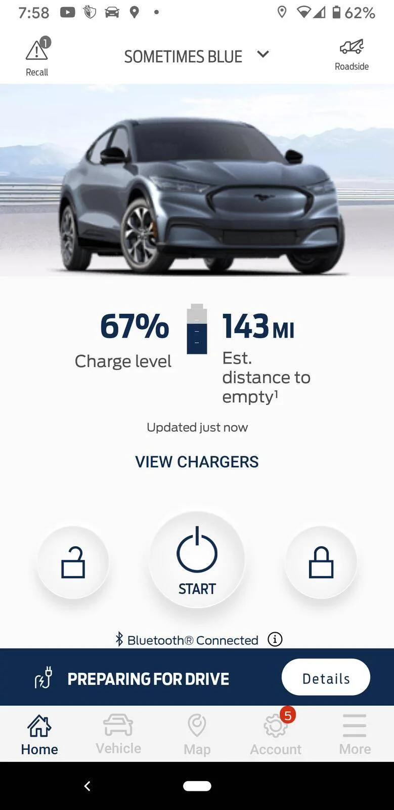

Today I arrived back at the office with 36% SOC so I decided to charge at work. I opened FordPass and it said "Waiting to Charge" which would be correct since I have a schedule set at work location. I pressed "Details" and was presented with another screen that had a choice to "Charge to 100%" so I made that choice.
After a lot of spinning circles....I got a screen that showed the car should be charging. Actually, several screens had that info. The Charge Session Screen and the home Screen both said the car was now charging.
A couple of hours later I went near my car (without the phone or the fob) and it was dead silent. The EVSE was in the "Ready to Charge" state and the ring of lights at the charge port door were off. I went back inside to get my fob and when I got near the car it woke up and started charging.
Weird. I lost a couple of hours of good L2 charging time because the car didn't start charging when I requested it via FordPass. Maybe someday I will figure this EV stuff out..... ?
