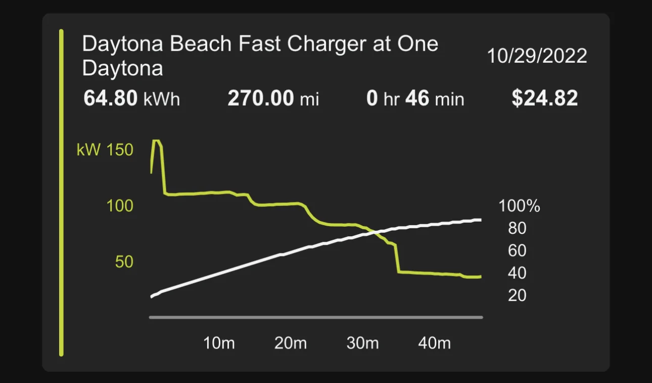

Here’s one for me from the FPL charger in Daytona Beach
Ford Mustang Mach-E Fast charging performance curves 1669256754737

this is great info but yeh not great performance, maybe i dont know enough but seems like they advertise this as a 150 when really it uses that for a few minutes then trends 100 and drops. not what i would call great performance

Hmm, fast enough for me, all vehicles have charging curves, I wouldn’t worry about it, the difference in time saved is minimal
