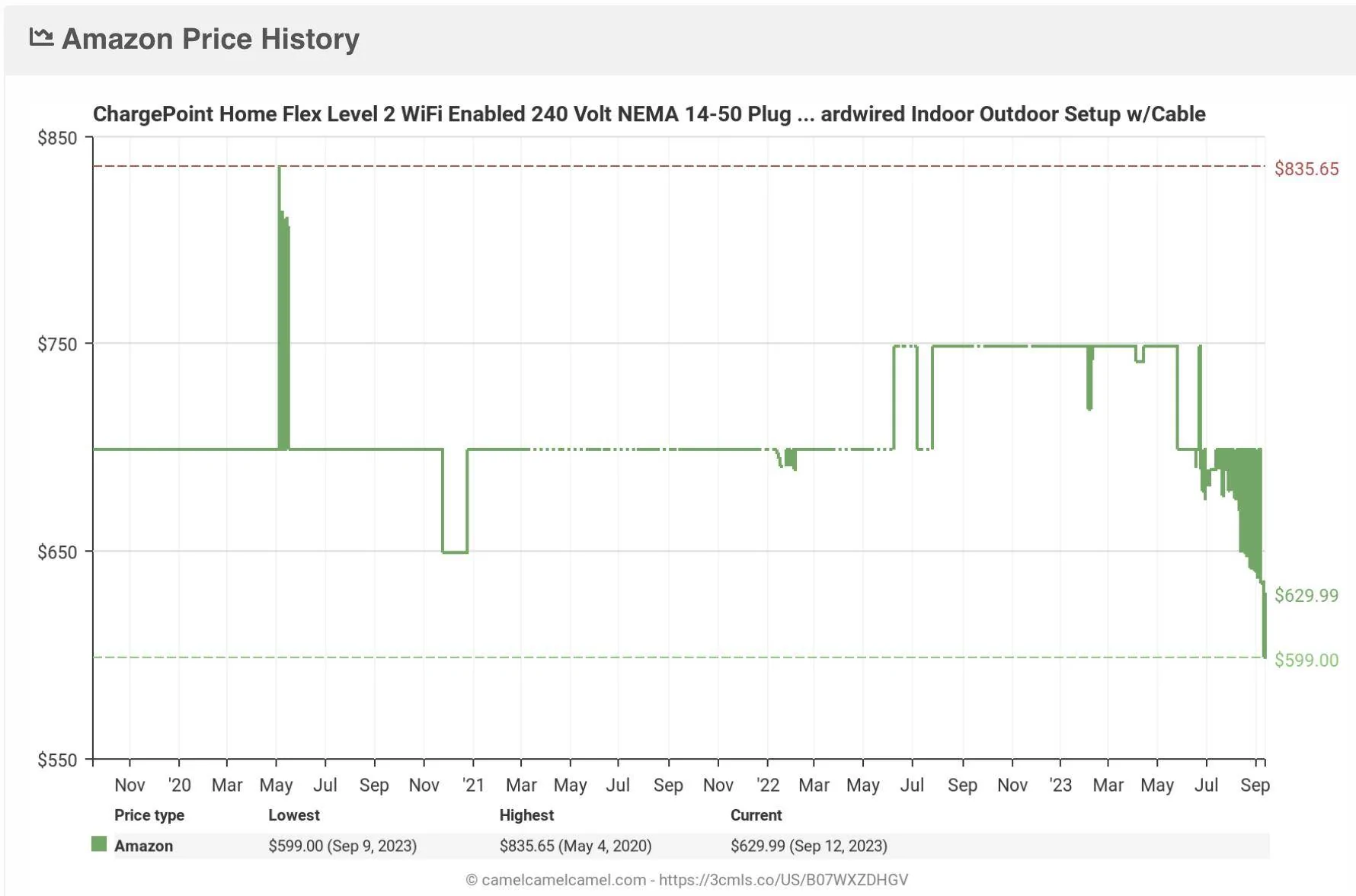

Why was the ChargePoint so expensive? They retail for around $600.
I bought it from Xcel Energy, the local utility through their EV charge program. There were only two models that you could choose from through their program, and the Chargepoint Home Flex was the more powerful of the two, which was what I wanted. Retail was more expensive than $600 when I looked a few months ago ($725 maybe?), but I decided this was easier

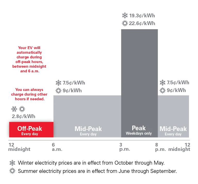

They're providing me electricity at 2.8 cents per kwh when I charge between 12 a.m. and 6 a.m., so I'm not complaining. I could have rented it from them, but I chose to buy it. I suppose I could have bought one myself, but I was socking away money for the downpayment on the car at the time, so I didn't. They will also maintain it if it ever needs anything, so I suppose I'm paying for that since I didn't rent it from them. My choice. ?

while $850 seems high, last fall and early spring this year they were in the $750+ range. they've come down a lot since.
There you go! I thought I remembered seeing that price!

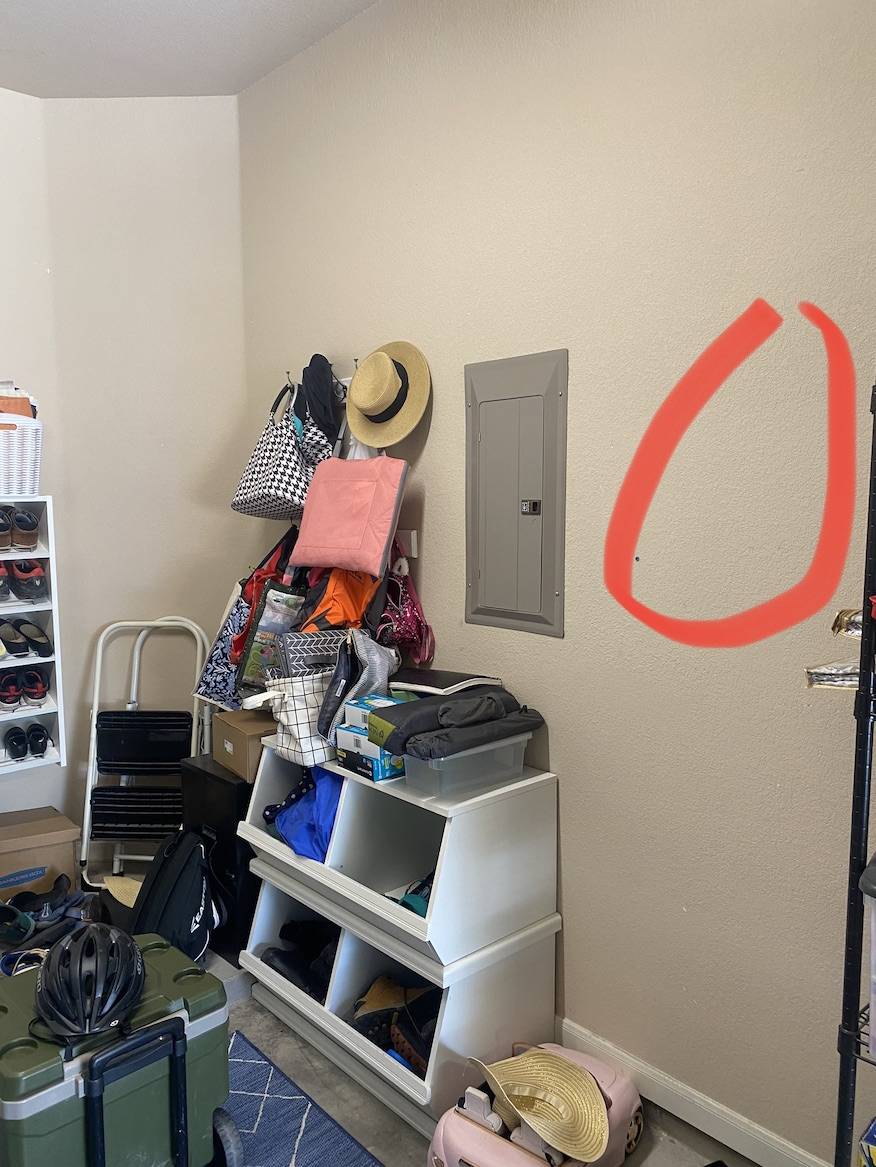

To answer an earlier question, the photo I uploaded is the sub-panel in the garage. The main panel is on the outside of the house, and unfortunately it's on the opposite side of the house from the garage.
To that point, I re-read the email from the vendor and they're proposing to run conduit starting at the main panel all the way across my front porch and through to the garage on the opposite side of the house. This is quite a long distance (50-60 ft) and also is going to look really ugly. I really don't want this on my front porch if it can be avoided. I'm guessing (but don't know) that the issue is what the poster above mentioned, which is the garage sub-panel can't handle the additional load. But I'm not sure.
Any advice here? If I went with a lower amp circuit, could it work (with a lower charging speed)?

Potentially dumb follow-up question: if I'm installing this right next to my breaker panel in my garage, does the electrician just have to run the wiring a couple feet (see image with red circle for the approx. installation location)?
The company I solicited the quote from wanted pictures of the garage and the location of the breaker panel, but also wanted to see the location of the main electrical panel located outside on the side of the house. In my case, the main electrical panel happens to be on the opposite side of the house from the garage. I don't really have a good understanding of whether part of this process requires some sort of change to that panel.
Ideally, but it depends on if there is room in that panel for a 50A breaker and overall capacity of the panel. There may be room for the circuit but you may already be tapped out in terms of total capacity of the sub-panel, and they would have to run it from the main panel. A good electrician would talk through those options and recommended approach. Good luck!

Impossible to say for sure without knowing all the details about that subpanel. If the person quoting did it based on solely those photos, he probably used worst-case and figure a run back to the main panel.
