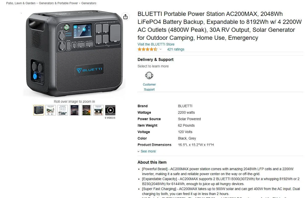

This works also. Was slower than your results but doesn't require gas as it's powered by solar panels. We've used it to top off while staying at airbnbs that didn't have a plug:

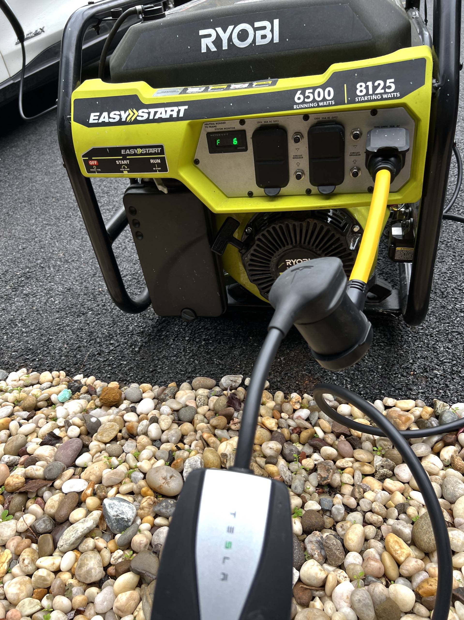

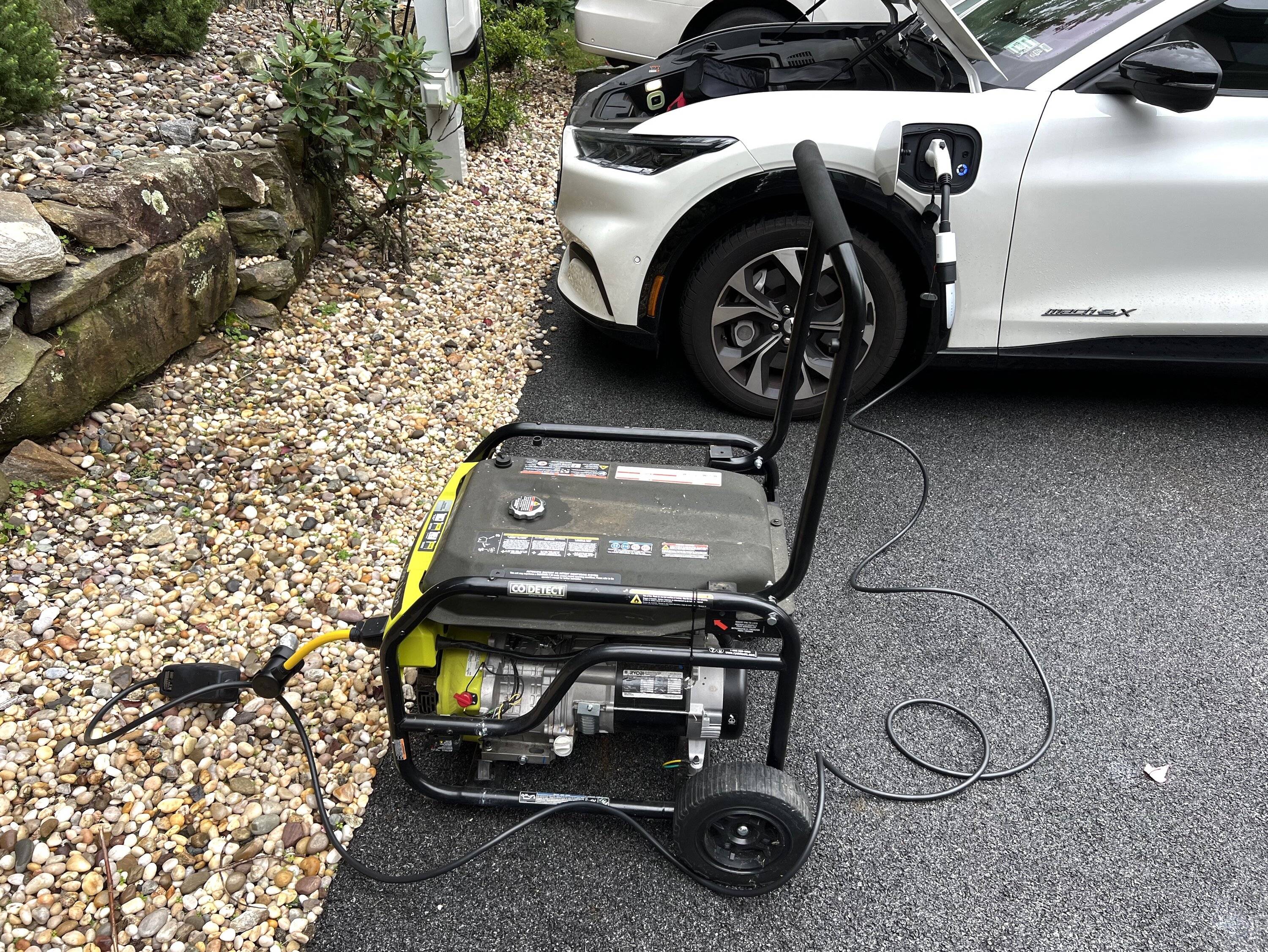

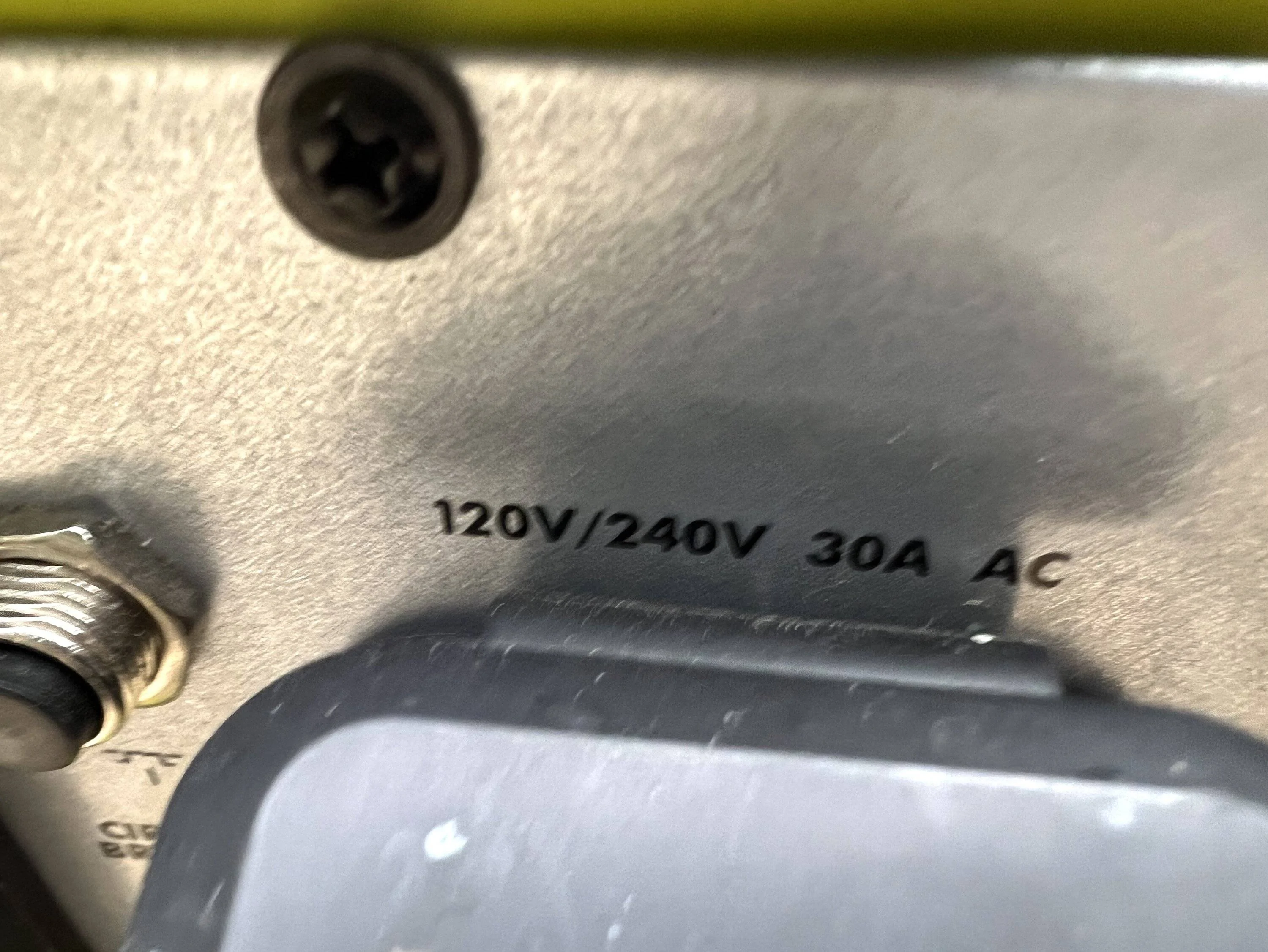

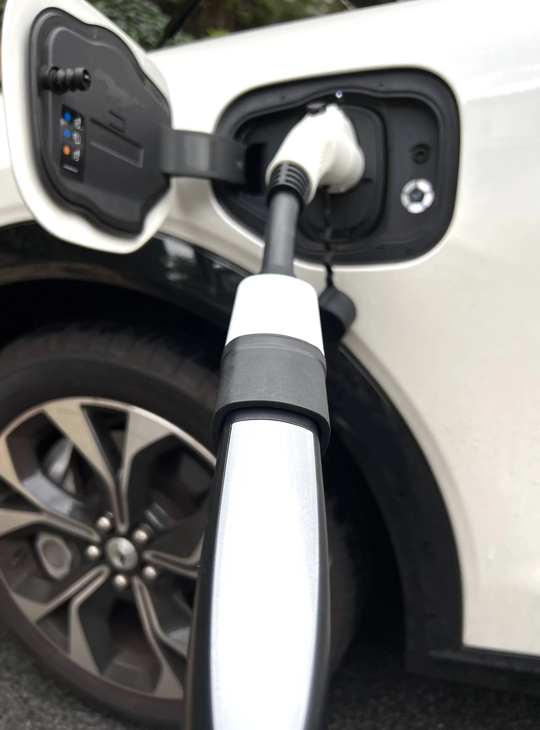

So the other day, just for sh*ts and giggles, I wanted to see if MME would charge on gas.
I have a Ryobi gasoline generator in my garage which I seldom use. It has a 220V 30A outlet. Now unfortunately, the Ford mobile charger that comes with the MME will only work on a 50A circuit or higher, so no bueno. Luckily, I also have a Tesla mobile charger, which comes with a variety of power connections, and DOES work on anything from 120V -> 220V, (30A and 50A). Thank you Tesla, and Ford - you should be integrating this flexibility into your mobile charger as well.
With that said, once the generator was powered-up, I connected the Tesla mobile charger into the generator's 220V 30A outlet. Now, this being a Tesla mobile charger, the plug wouldn't actually connect to our MME. This is where the Tesla -> CCS adapter comes in handy. Not just for my little experiment, but anytime you're left stranded, and the only charger nearby is a Tesla one.
So on those occasions when power does go out, and you need to charge your MME using a gasoline generator, the process does in fact work. If I had purchased a more powerful generator, it probably would have offered a 220V 50A plug, making this process relatively simpler.
However, make no mistake about it - this is an utterly wasteful (and loud) way of charging your MME. Still, if and when the need arises, the possibility is there. I was able to charge at a 24-amp rate (toughly 12 miles/hr) while annoying the heck out of my neighbors.
Items used:
Ryobi generator Model #RY906500S
NEMA L14-30P to 10-30R 240V 30 Amp adapter
Tesla Mobile Connector
Lectron - Tesla to J1772 Adapter
Cheers

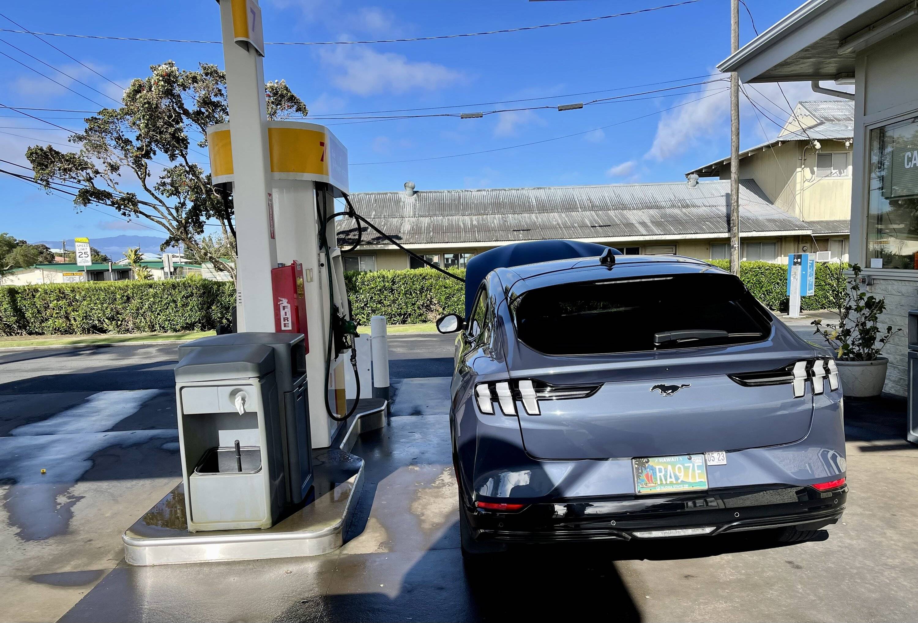

The last time I filled Otto up with gas.
Gas cans for the mower and brush whacker. That is what you meant right?
How did you avoid having ELECTRIC VEHICLE on your license plate? Is the Hōkūle'a plate EV only?
