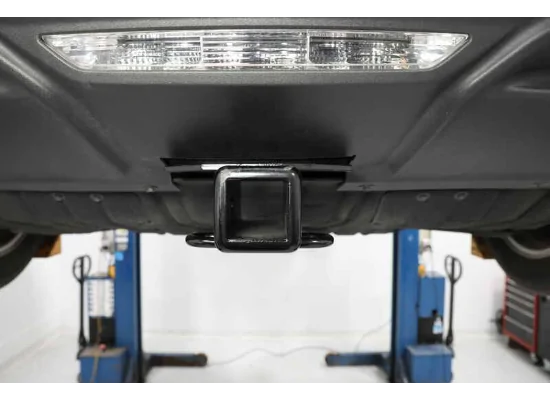

looks like it uses the same bolts to chassis locations.... but the drop down to below the facia reduces the clearance more than I would like. Also, having a ball hitch only rather than an easy 2" receiver makes it harder to slip in a bike rack.
I'm very happy with the Torklift installation and weight capacity, and don't need the electrical kit for the bike rack.

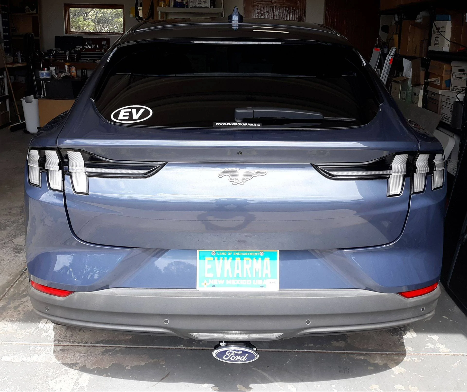

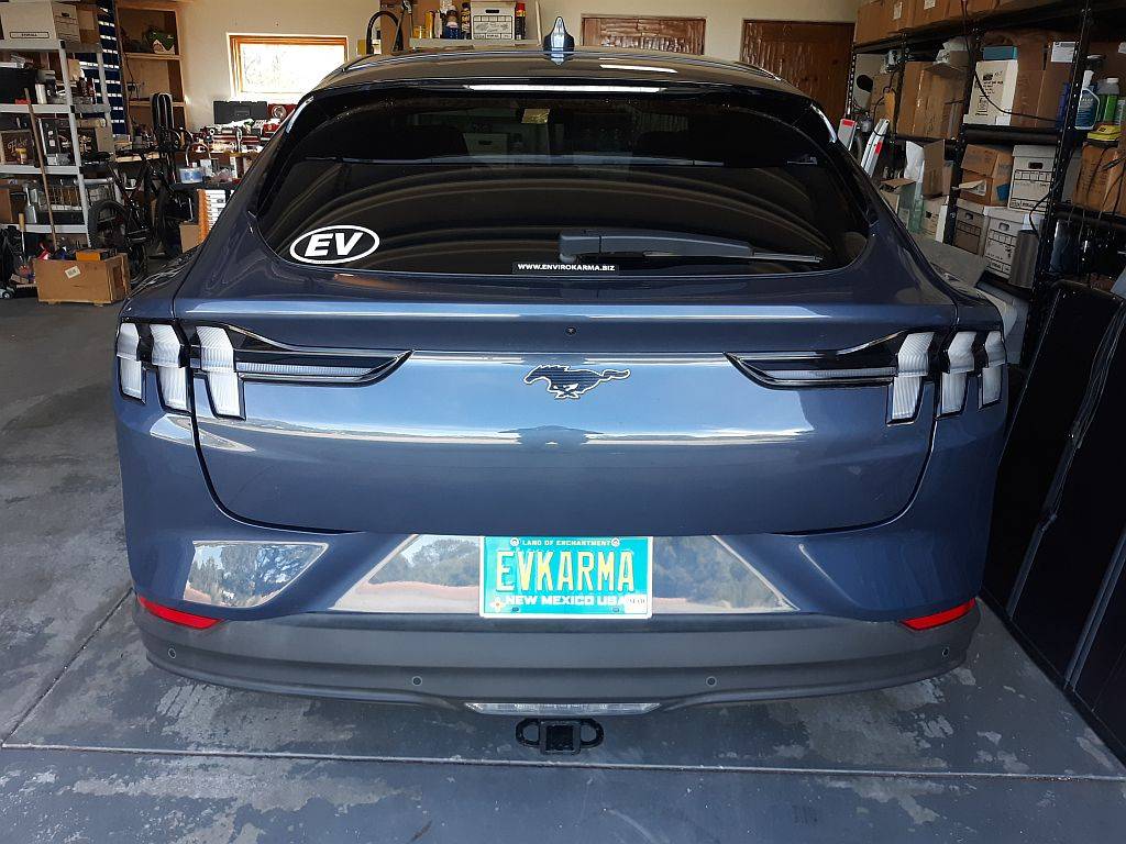

cutting a slot in the bumper facia is super easy and the hitch receiver give opportunities for fun covers....

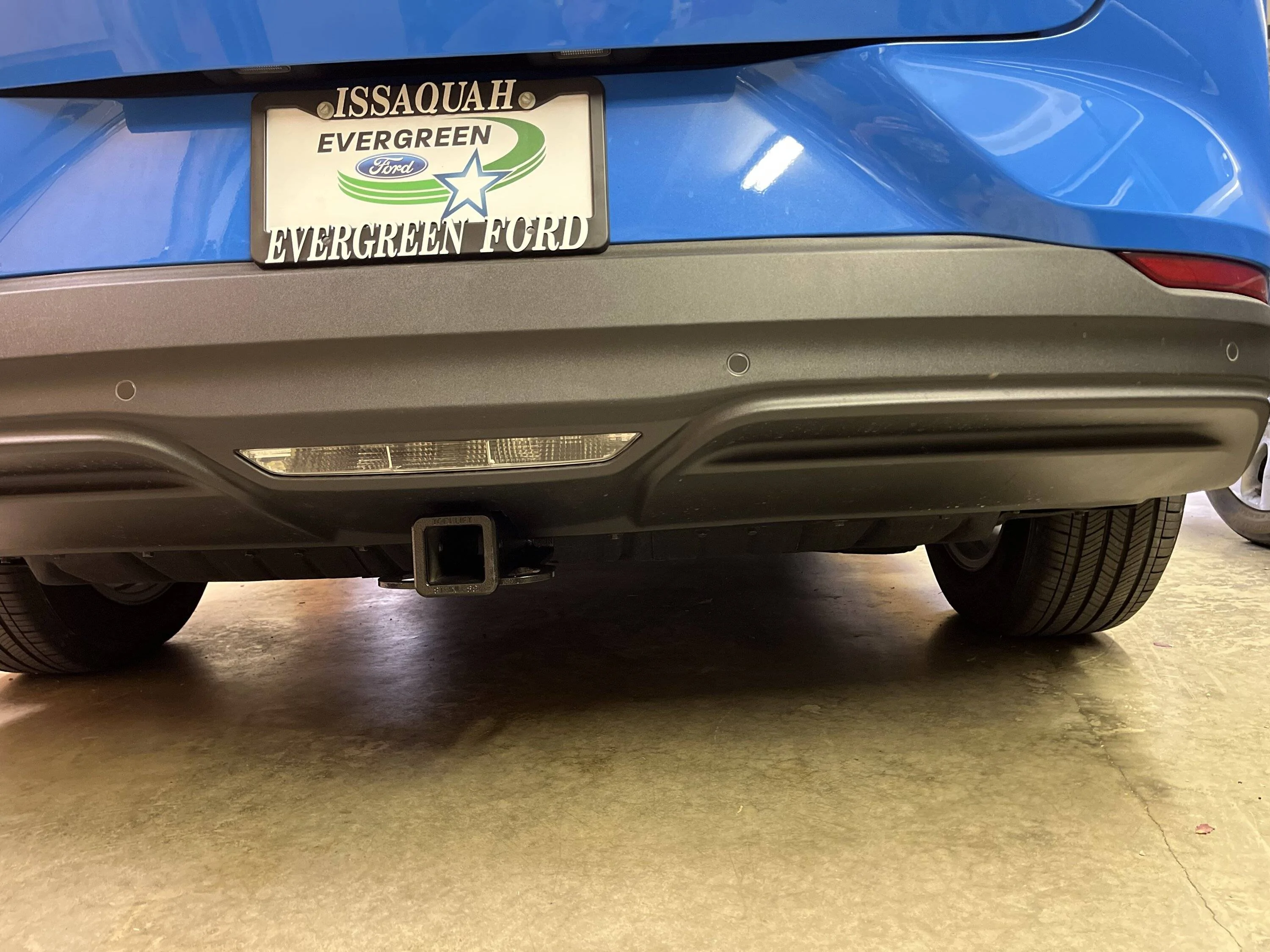

I managed to install the eco hitch on my Mach E without lifting the car. I cut the bumper using a Dremel. The four bolts threaded through head first using the wire. Lifting the hitch with my floor jack worked pretty well.
