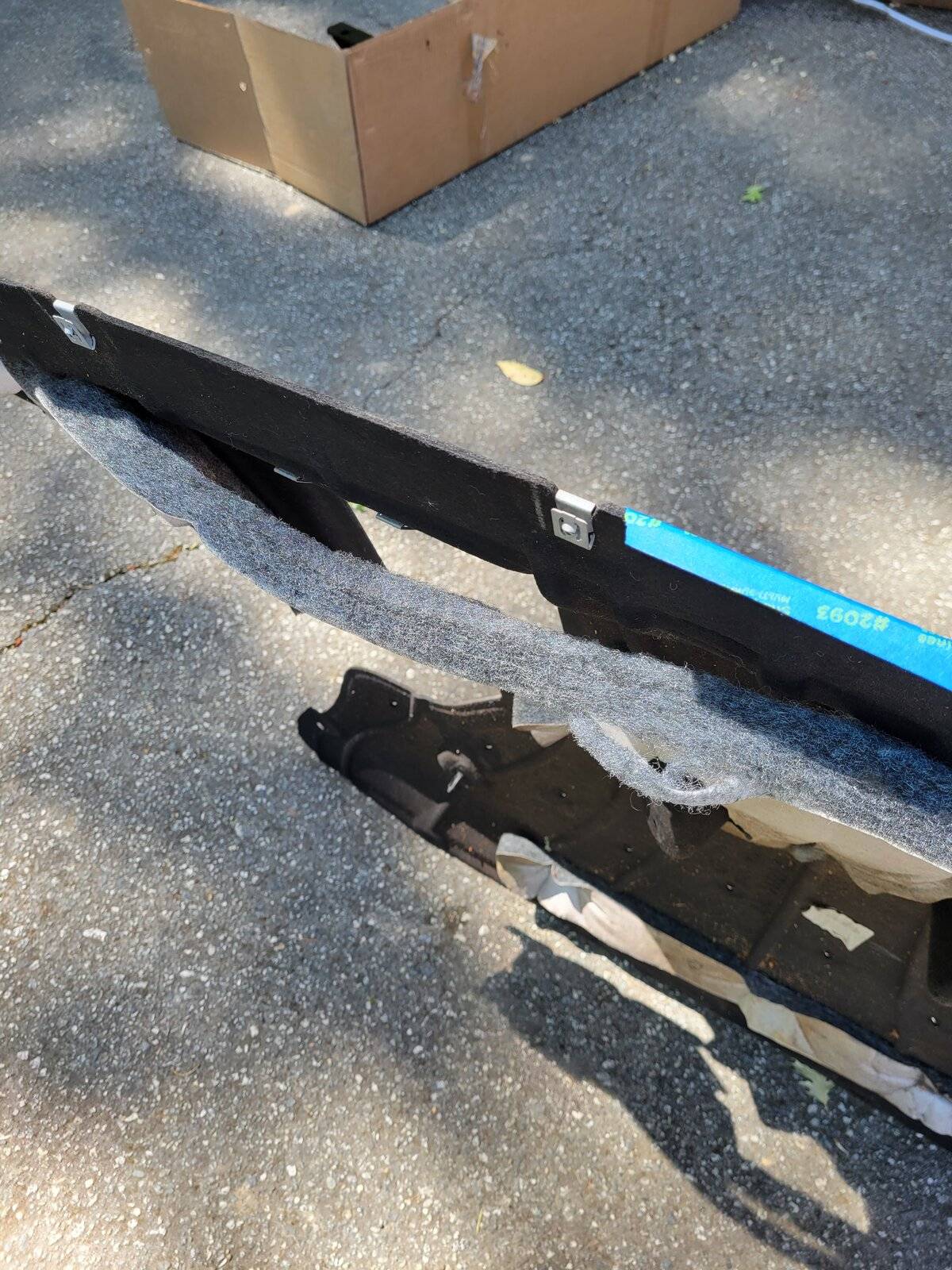

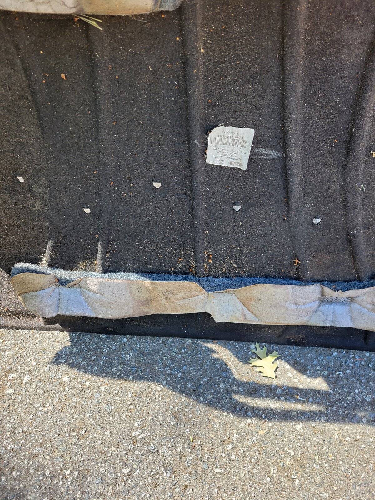

I'm also finding some stuff I think Ford could have done better:
The batting above the under body tray isn't real good. Looks like it will be a moisture trap and a place for mold to grow in the future.
And making it out of what feels like fuzzy cardboard grabs dust and debris. Should have been had plastic and no carpet pad-like stuff.

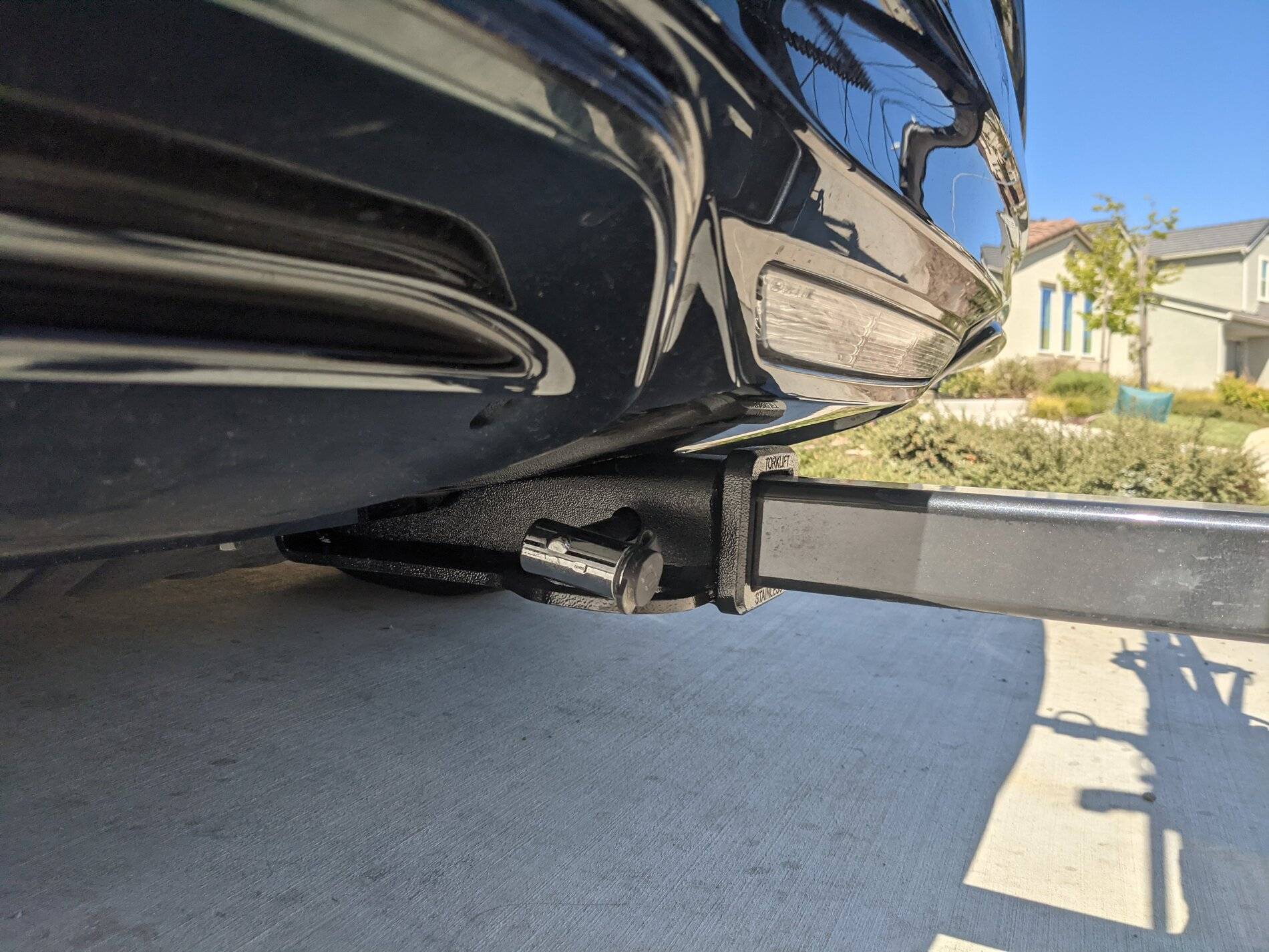

If you are one of the many SE Michigan Mach E drivers, I highly recommend Hitch House USA in Livonia. They ordered me a hitch last Thursday, called me on Tuesday to say it's in, and had it installed in less than 2 hours. About $330 out the door. Just be prepared to have the "do you think that's a real Mustang" conversation.
Foot activate lift gate still works and now I can haul my bikes!

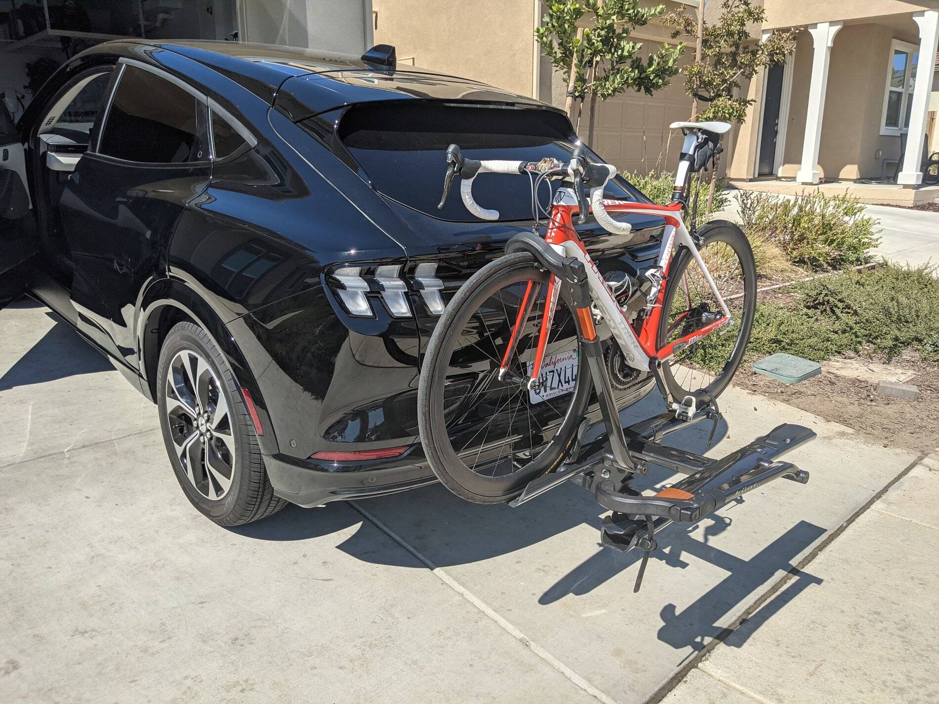

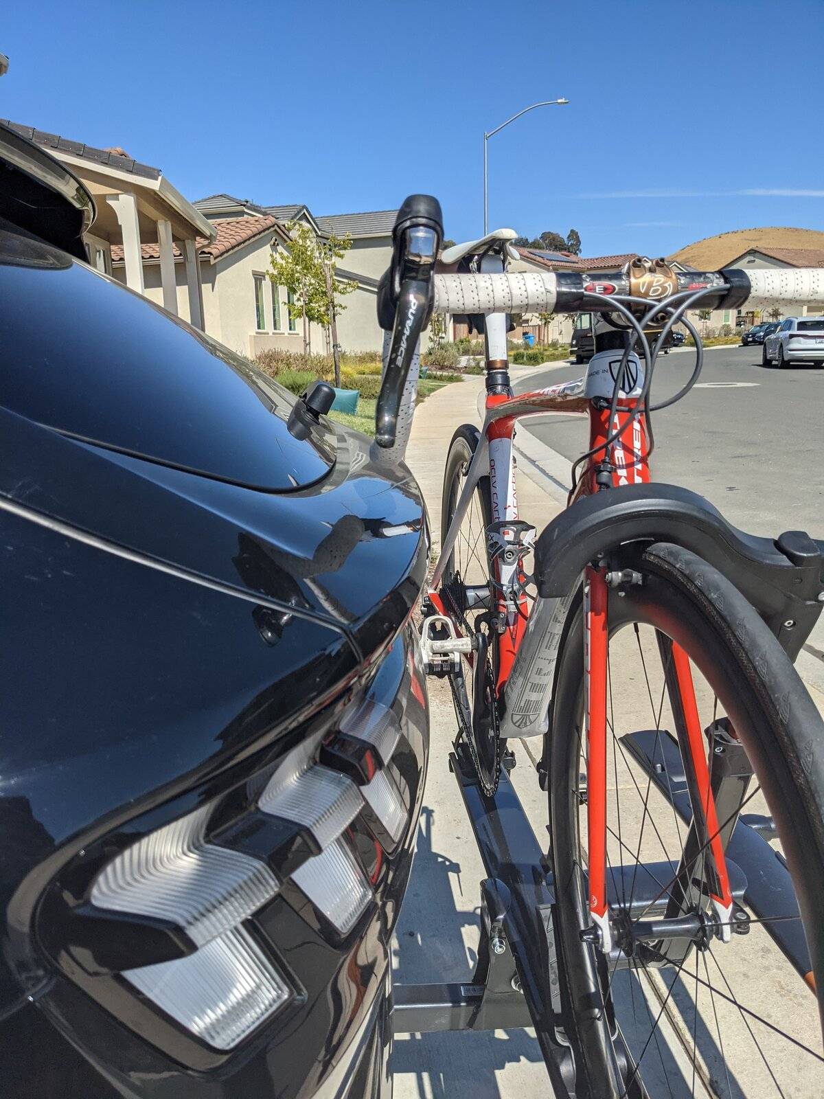

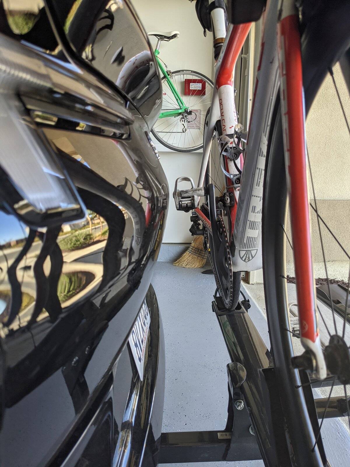

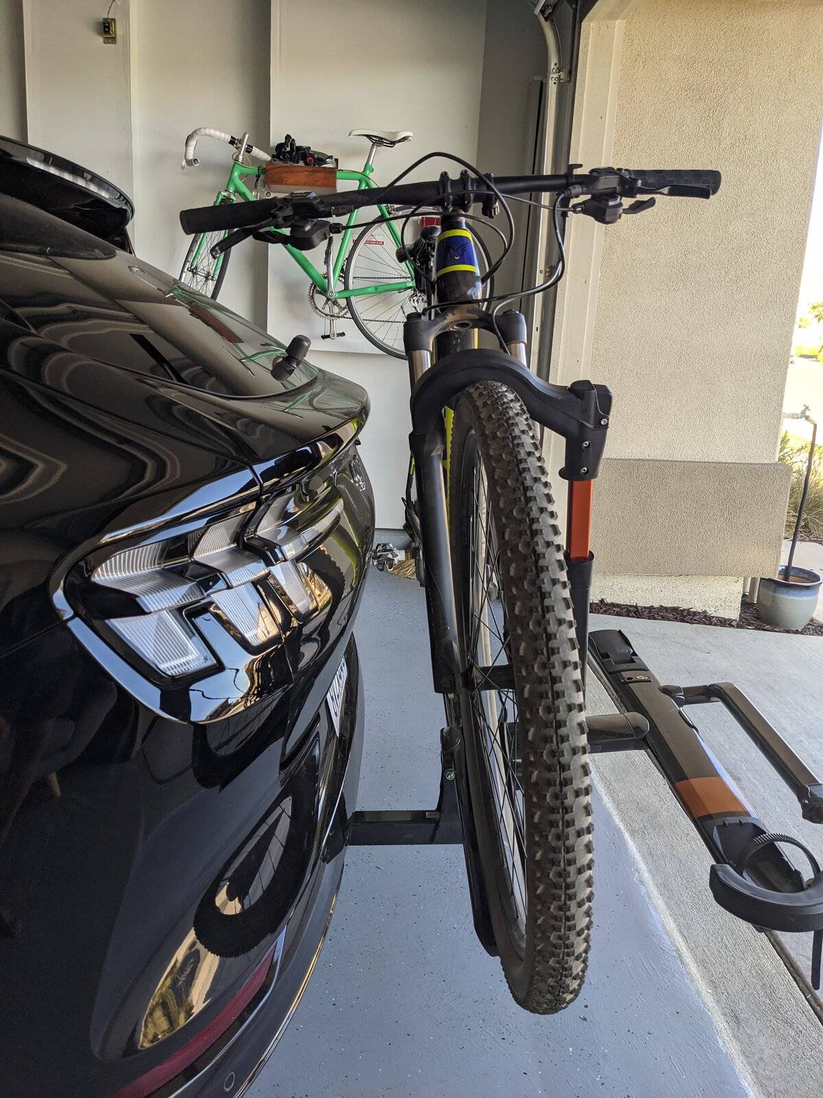

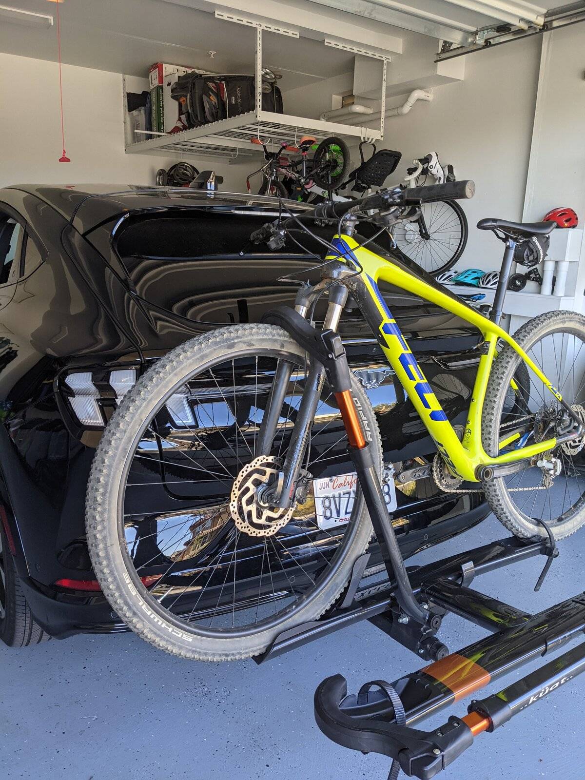

I installed the ecohitch at ABC MUFFLER & HITCH in Benicia, CA. It cost $250 (2 hours). I like those guys, very fair. He said the ecohitch was really nice and sturdy. I paid $1,000 over MSRP back on May 31st with the agreement that the dealer pays for the hitch plus install. They wouldn't give up getting something over MSRP and I got what I would have paid for anyways. Dealer was Marin Ford in Novato, CA.
I put on a Kuat Sherpa from my other car.
*Looks great
*Road Bike is close to the car but there is clearance without attachments. Pedals and handlebars don't hit.
*Folding up is close but doesn't touch by about .25 in
*I need to test my MTB on the hitch...coming soon.
(By the way, I put limo tint over factory tint on the rear)

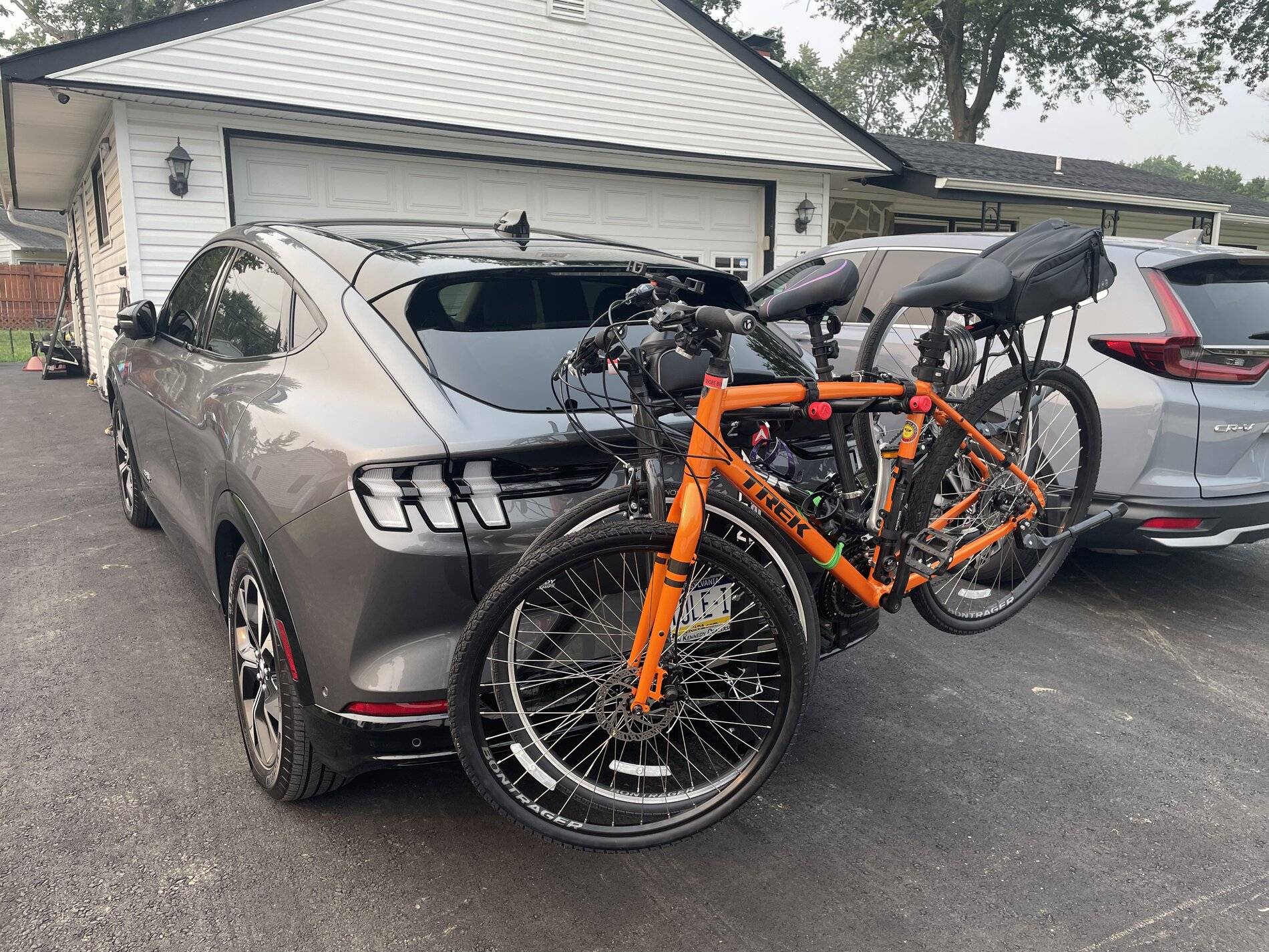

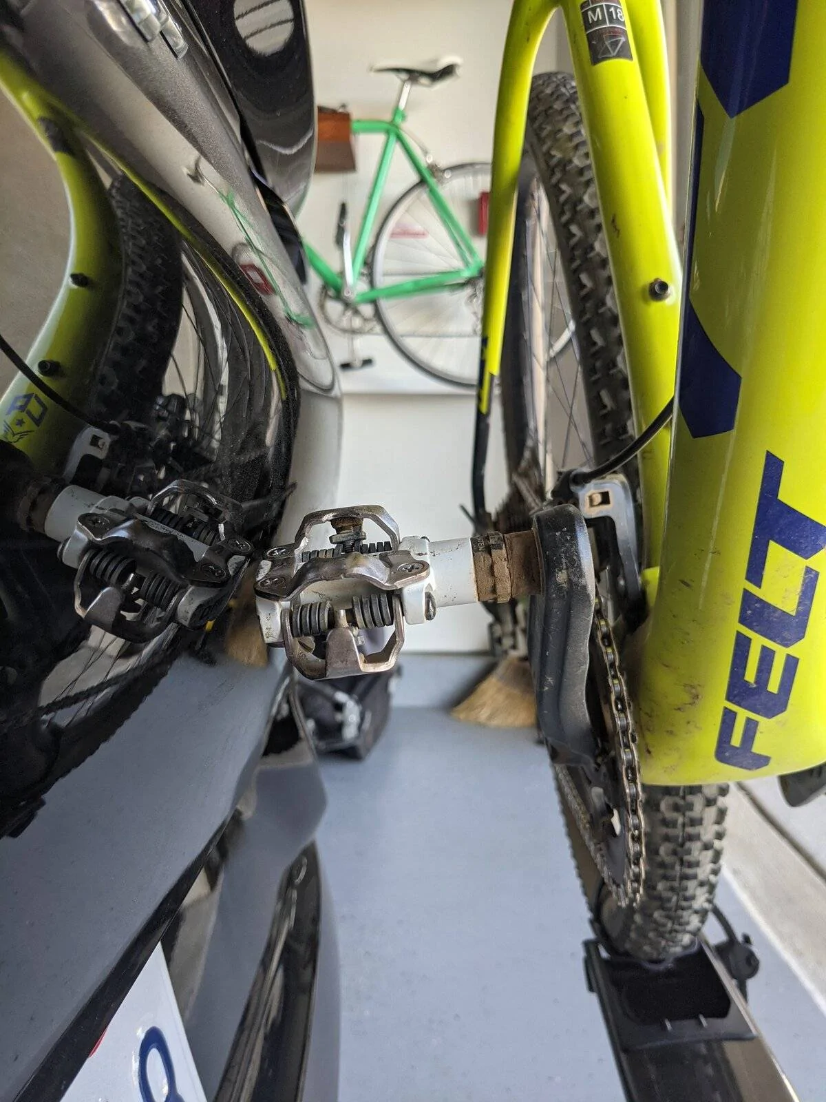

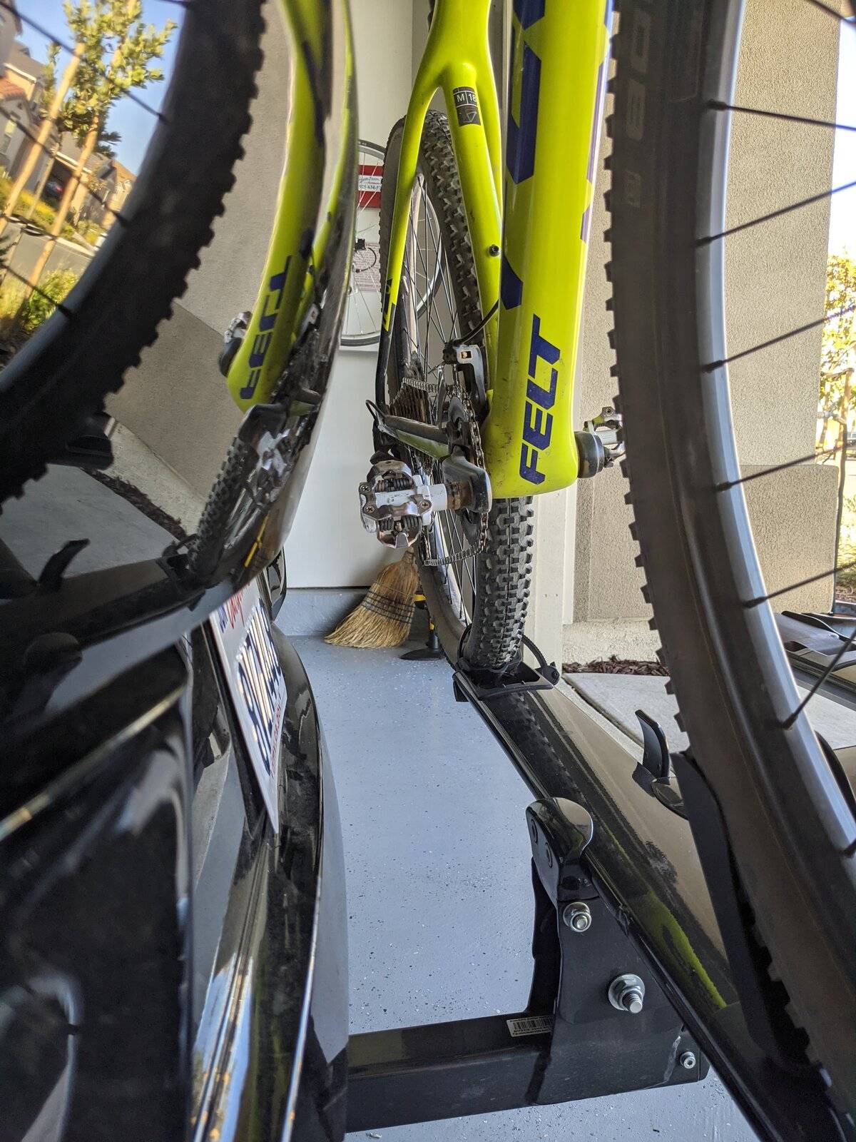

MTB fits fine. The pedals can't spin fully, unlike the road bike, as it hits the trunk. That isn't a problem because the pedals don't just spin once attached.
I could see someone with flat pedals (which are bigger than clips) needing to be a little more careful when mounting their bike to mind pedal position.

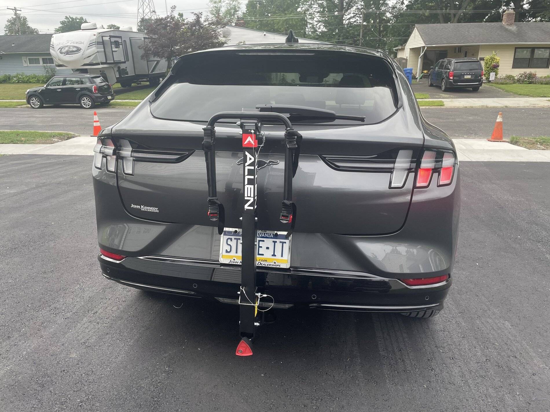

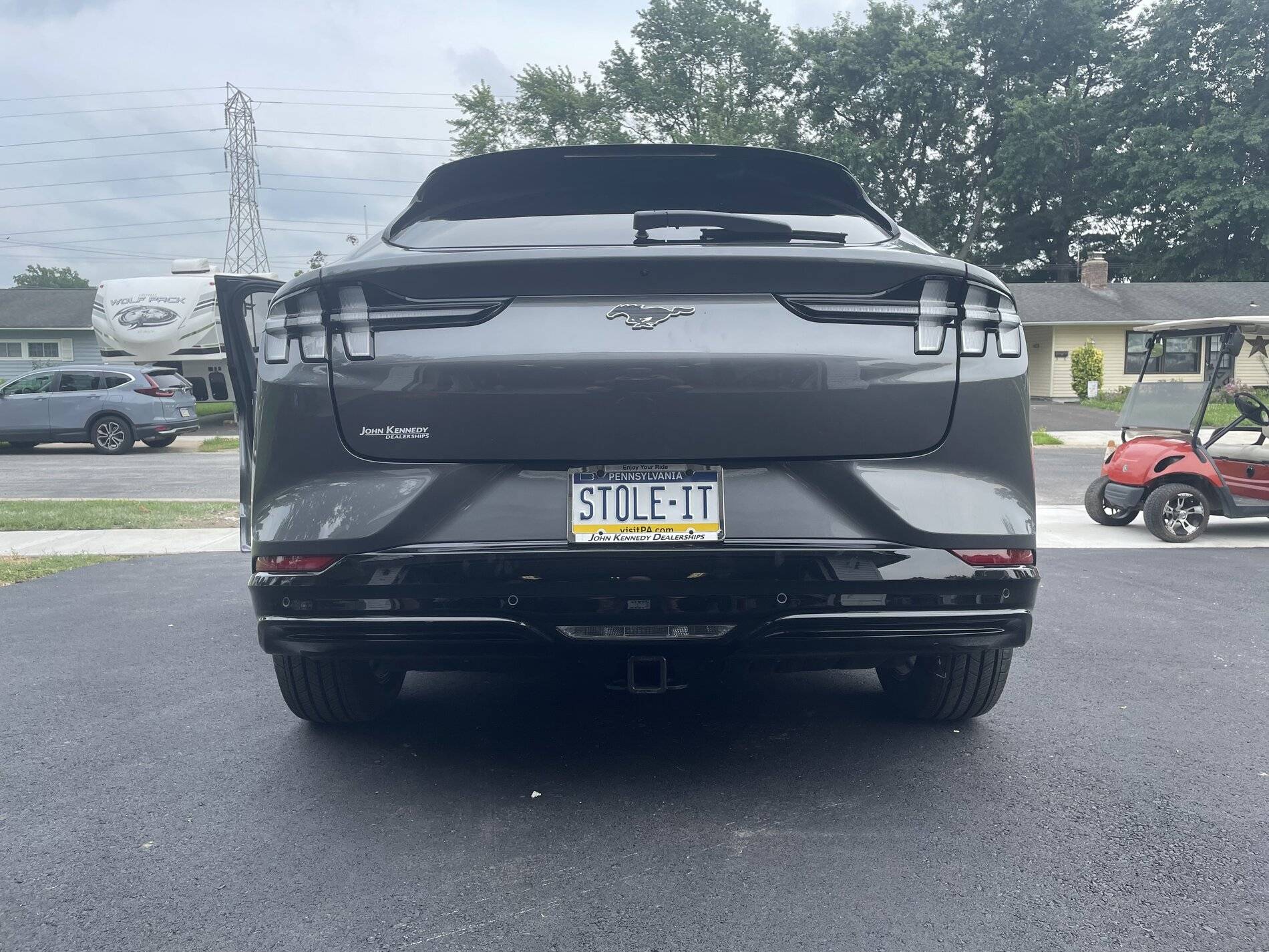

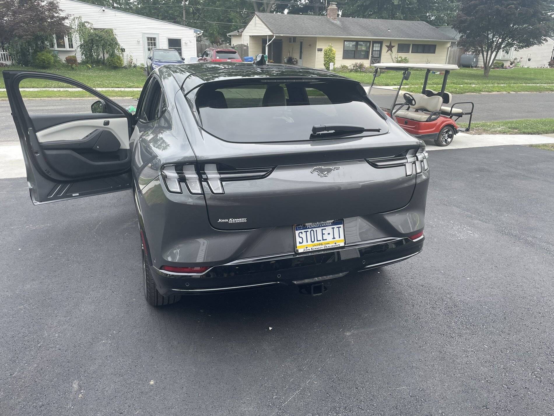

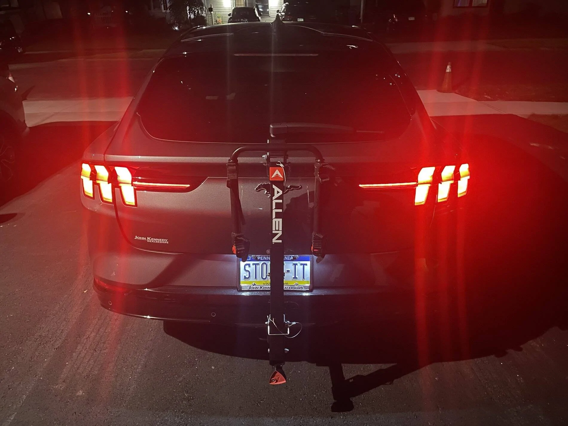

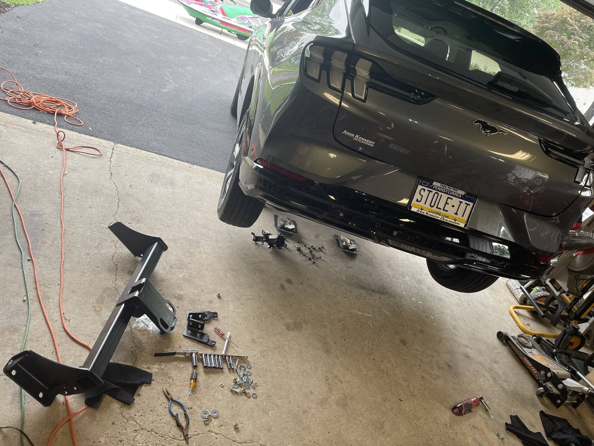

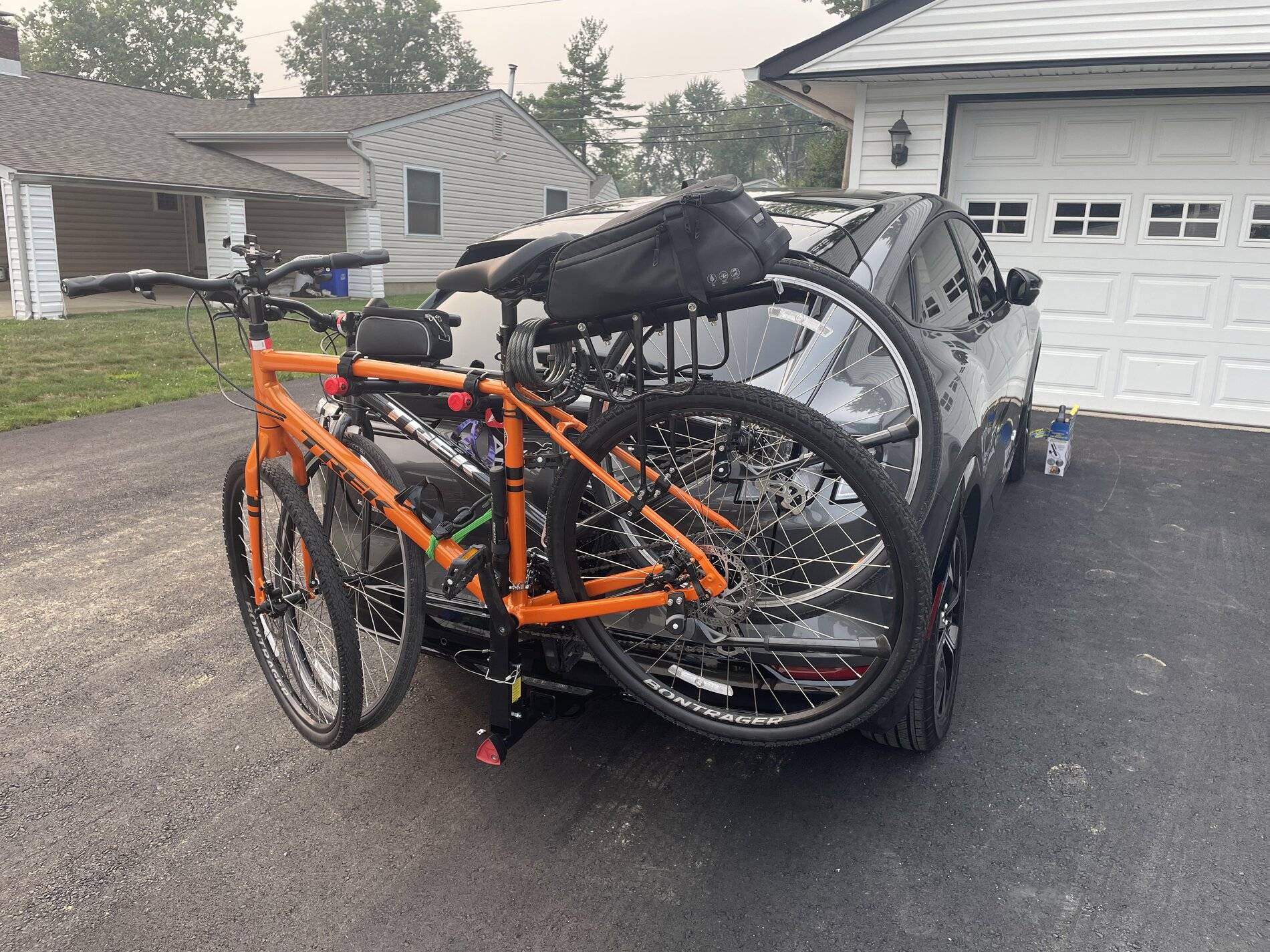

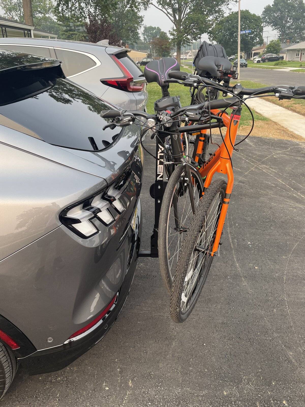

I installed this hitch a couple days ago. Its pretty straightforward.
I am going to tackle a wiring harness for trailer lights next.
theoretically, if the supply for turn signals and brakes is 12vdc, it should be quick and easy. I am a little nervous with the sequential turn signals though. I will report back once done.
