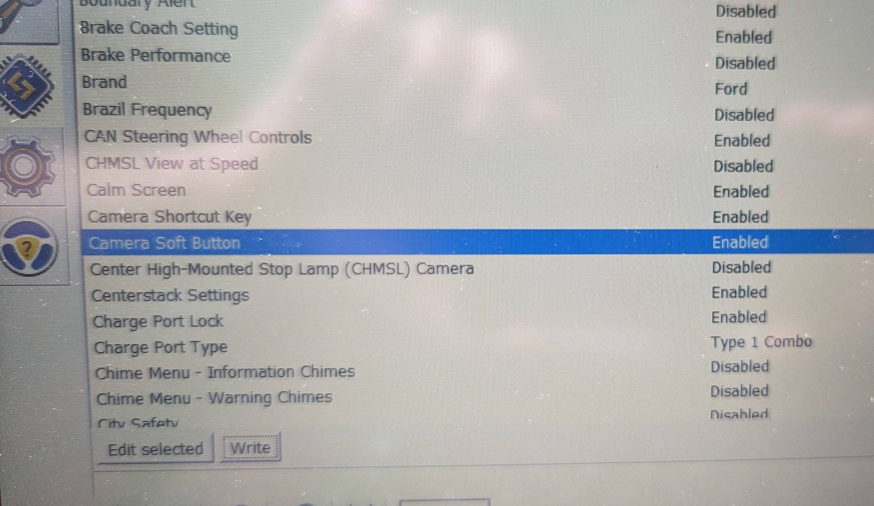

FiXED!!!
I decided to see if there was anything forscan could do to solve my missing camera button issue. I re-upped my forscan license and connected my OBDII interface. The APIM has a setting called "Camera Soft Button" that was disabled. I enabled it, wrote to module and once Sync reset, the camera button appeared!!!

Ford Mustang Mach-E FiXED...No way to access the camera?? PXL_20230128_192703641
Now that I have a valid forscan license again.....time to see what else I can enable......:cool:
