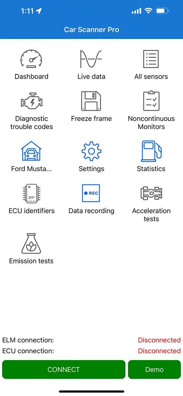

So buy a good dongle (like OBDLink MX+) and download the carscanner app for free. With these two things, you’d be able to read the SoC of your 12v battery and many other things related to the vehicle.
I was looking for help in how to look up that specific variable. I can’t find it
GreaseMonkey
Oct 3, 2021
3,233
5,173
Chicago, IL
24 Mach-E GT
It’s in the Dashboard on the top left of the menu. You have to scroll through a few pages to get LVB SoC.
Do I need to purchase an OBD? I just ordered my first EV.
GreaseMonkey
Oct 3, 2021
3,233
5,173
Chicago, IL
24 Mach-E GT
Yup. If you order the one I speced, you can also get acceleration figures and a lot of other useful data. There’s so much to monitor in an EV and ford didn’t give us easy access to that info.
