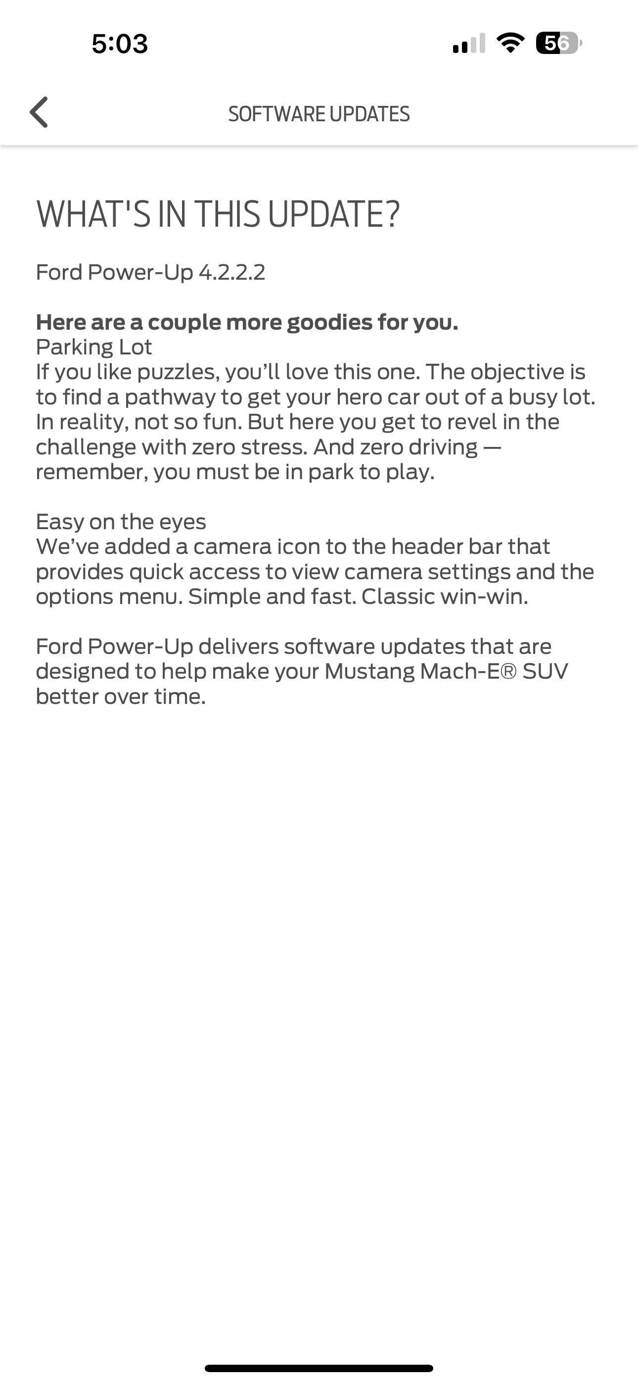

Wow that was quick, 23MY now has camera button and this update.
Ford Mustang Mach-E Ford Power-Up 4.2.2 55DC6245-B778-45CB-B834-E7252D80CFE4
