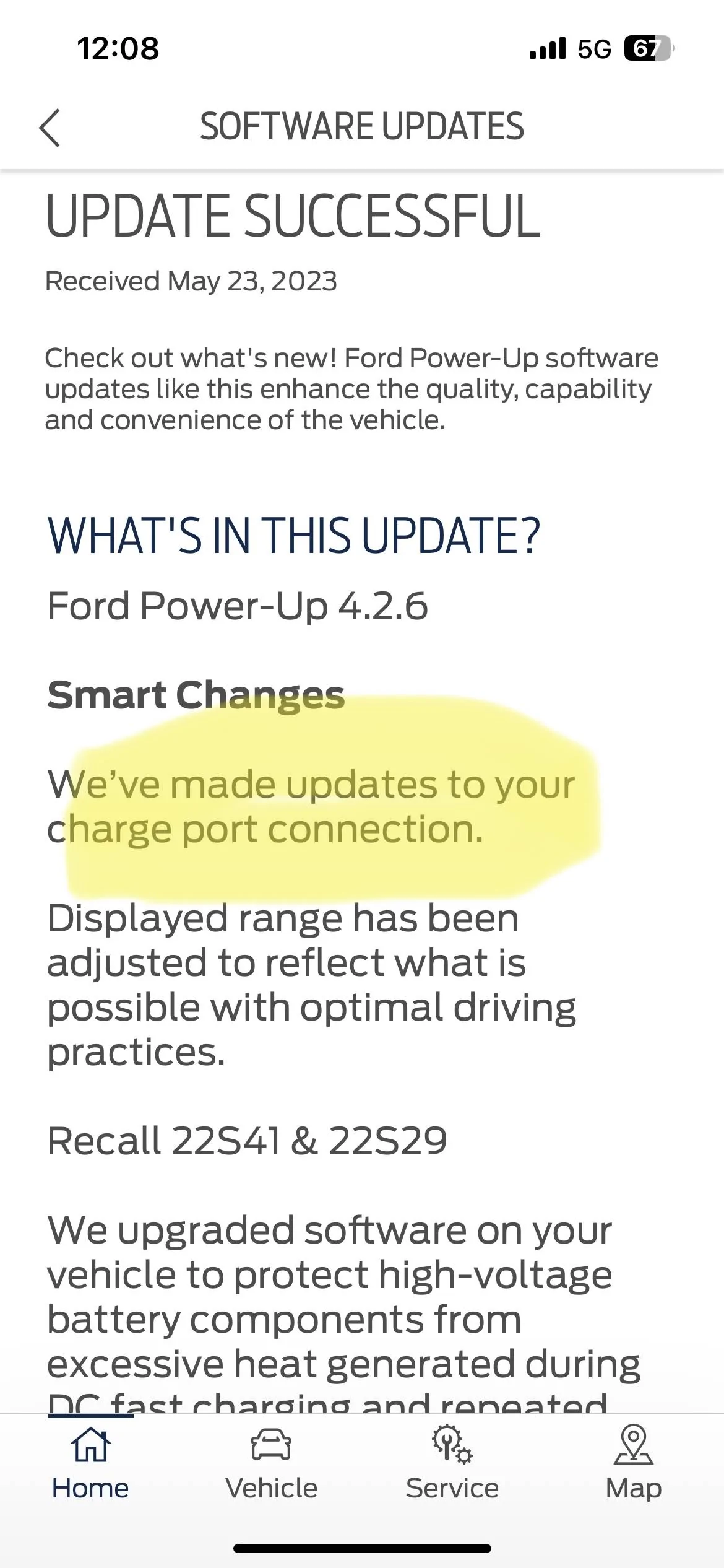

Ok, a forum member (who shall remain anonymous unless they choose to step forward) messaged me privately with a suggestion that I throttle my ESVE down to 32 amps. This seems to be working well as evidenced by the fact that my current charging session is currently at 38 minutes, and 5kwh added. Both those numbers are orders of magnitude better than yesterday and I can live comfortably with this option until my dealership can get the parts needing to be replaced in.

I got 4.2.6 on Tuesday afternoon, and then Tuesday night I spent over an hour trying to get the car to charge. It would charge for about 2 minutes then give the red ring of death and stop charging. I finally ended up rebooting my ChargePoint home flex and that seemed to get it to charge. I got home from work yesterday, plugged in, and got the same behavior except that rebooting the ESVE didn’t help. I’m heading to the dealership this morning as soon as they open… will update y’all as information comes in. I’m just glad in retrospect I didn’t get the update sooner as I was on a 1200 mile road trip until Tuesday. I literally got the update the minute I got into my driveway.

Exact same thing happened to me a while ago. Had to lower the amps way down to avoid the orange ring error. DCFC always worked fine though. Replacing the charge port fixed it and I’m charging at 48 amps at home again.

4.2.6 has tried to install nearly a dozen times. Every everyday scenario imaginable. Plugged in to the home charger, not plugged in, driven for an hour beforehand, scheduled initiation, manual initiation... It always fails. Absolutely maddening.
Now I'm wondering if the fact that the charge port was replaced (under warranty) has something to do with the 4.2.6 install fail.
Same exact challenge here with L2 charging after 4.2.6 with the red ring.
Ironically I also have a 2021 Job 1 FE. My wife has a 2021 Job 1 FE that did not yet receive 4.2.6 and charging worked fine.
FWIW I went to the area Electrify America to test DCFC charging and it did charge. Went from 41-80% last night.
Will attempt to throttle down the ChargePoint in the am.

This is the part that has me concerned… they mad changes to the charge port, and now I can’t charge.

This is the first I’ve seen of the “throttle down the charger” hack. I wonder what’s going on that makes it work?

Did you get the “priority update”? It should have come in almost immediately after 4.2.6 was successfully installed.
I did, but I got 4,2,6 on Tuesday, and the follow along one didn’t show up until yesterday (Friday) evening.
The direction to try it came from someone I trust due to their job, and it does seem to be working. It

@JoeDimwit not seeing how you can change the amperage in the app. Any direction?
