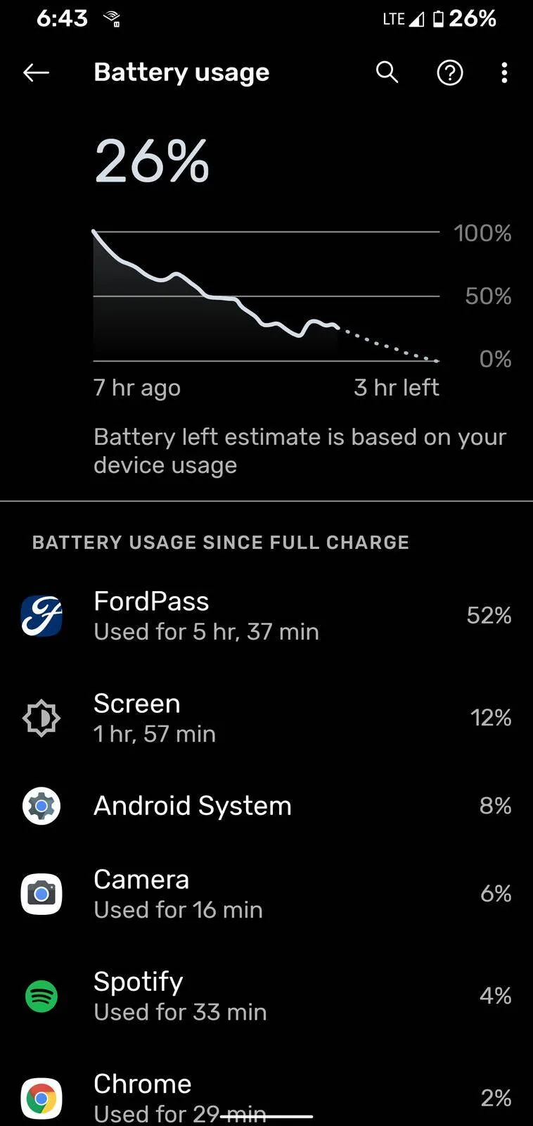

Me as well. My battery life has gone to nothing. I'm at 25% now at 3:10. This phone usually goes all day and then some. And that is 25% with plugging it in periodically. This version is a battery killer.
I literally logged on just to see if I was the only one having this issue. PaaK is working better, but not at this trade off lol
Ford Mustang Mach-E FordPass 3.24.0 rolling out Screenshot_20210616-184330

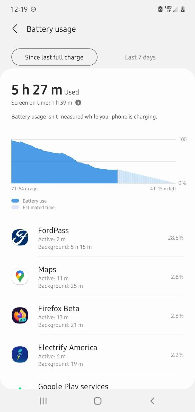

Uninstall and reinstall worked for me *until* the next time I drove, then battery drain was back. Ironically it drains faster than the built in wireless charger can charge, so watching battery drain *while charging* is pretty wild.
Ford Mustang Mach-E FordPass 3.24.0 rolling out Screenshot_20210617-001919_Device car
