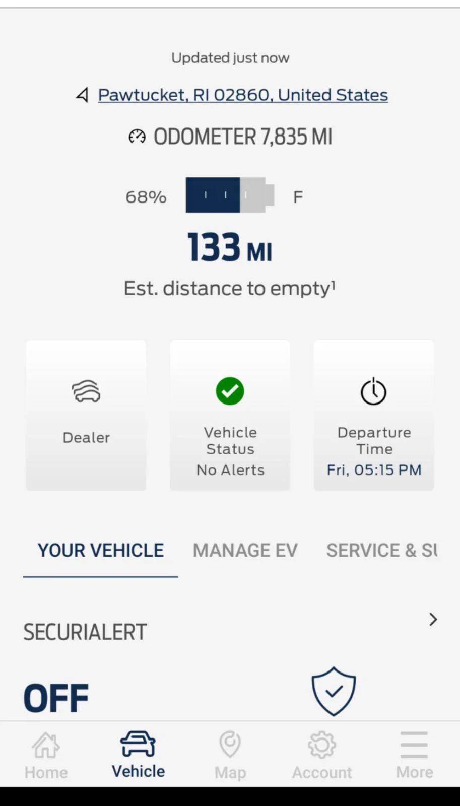

They changed the button layout and now it doesn't show the next scheduled departure time. ?
I don't use departure times so I'll admit this is a dumb question - was it on the top-level screen before (rather than behind the Departure Times button)?
