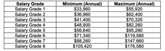

I found their pay/benefits guide. Here are their salaries:
Ford Mustang Mach-E FordPass and many other irritating Issues AF4D77E3-92F4-4248-B4FE-42038FB065FA_4_5005_c
