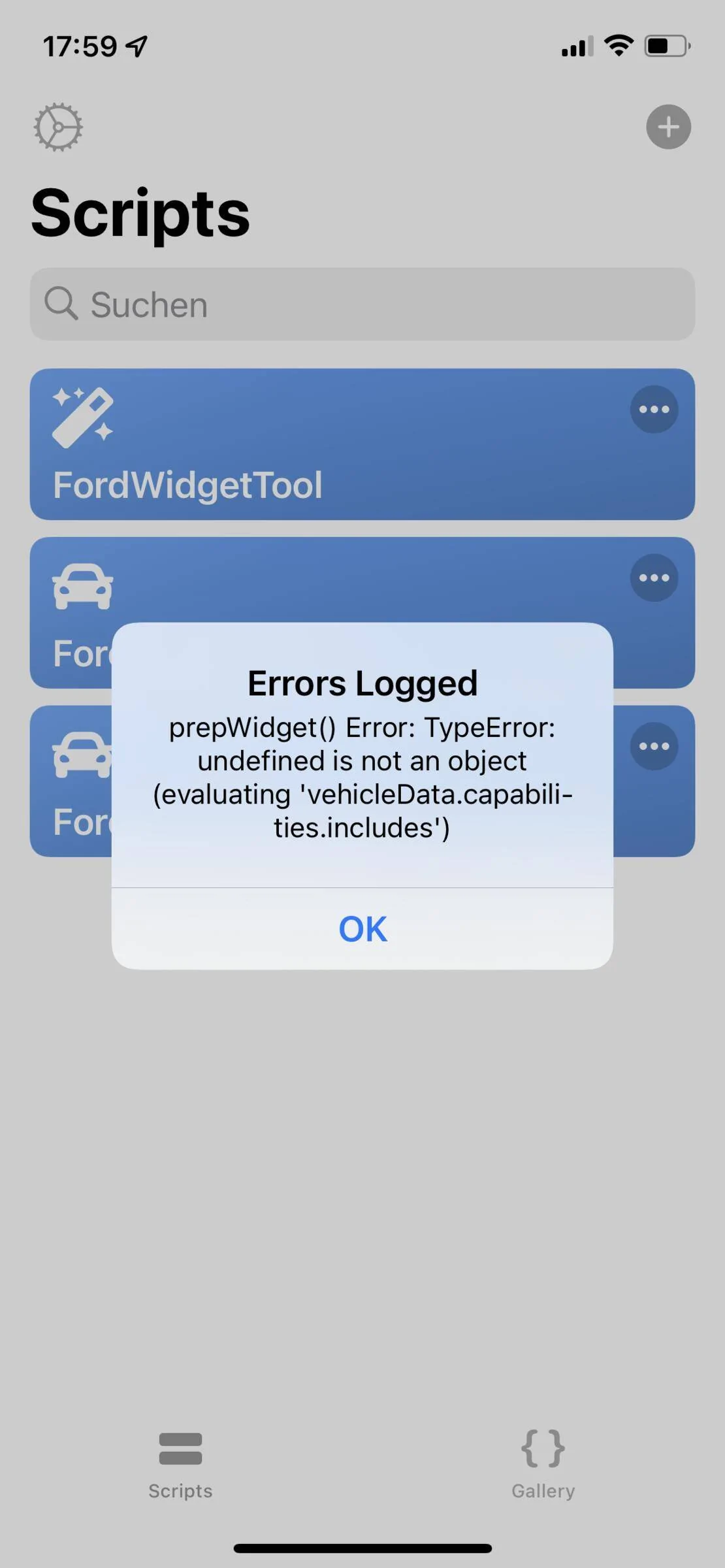

Hi @tonesto7 . Great work on this app! After the update I get an error:
this.FPW.valueChk(lvlValue, 0, 100) is not a function.
That problem seems to come from this line:
https://github.com/tonesto7/fordpas...431a6950e845ec2a2ab8b/Modules/FPW_App.js#L671
Indeed, that function does not seem to be defined as a member of FPW. Do you see the same problem? The fix should be easy (remove the check), but I was not able to figure out how to hack the code in the loaded modules.

Nothing has worked since yesterday. After creating the widget again, you will always get this error message.
looks like your stored vehicle data was corrupted in the widget state...
You will likely need to use the widget tool to reset the data and force a refresh.

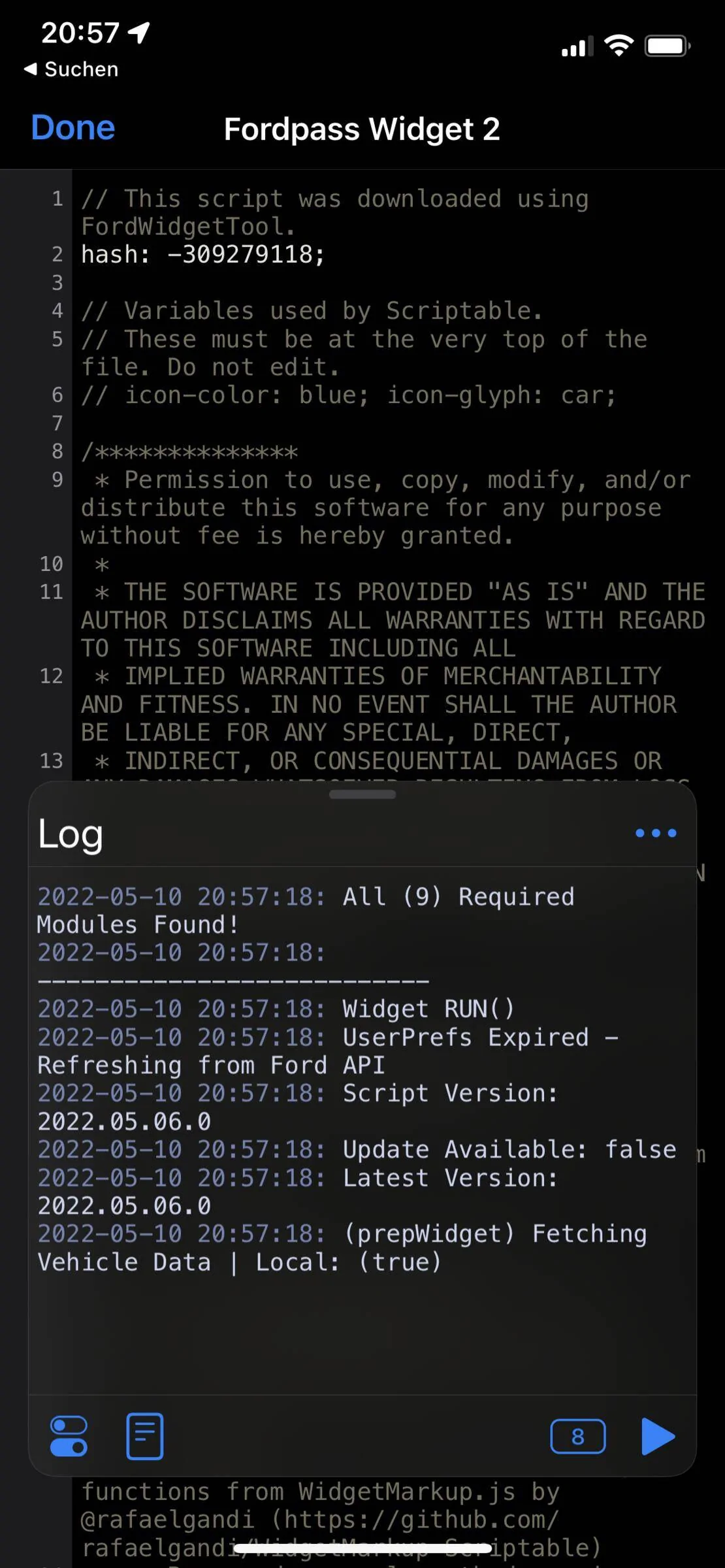

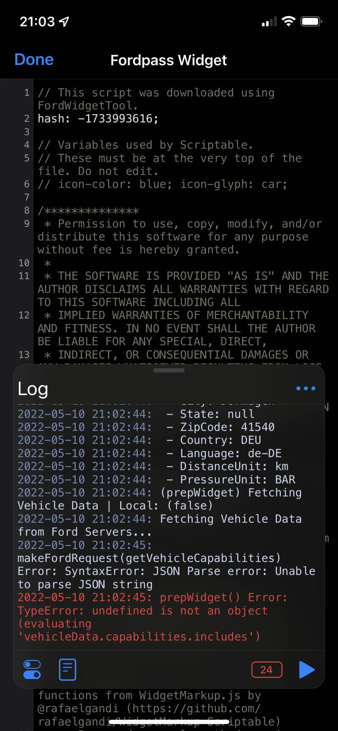

Please follow this video and open look for any errors in the console after you try to get the data.
FYI... There will be a lot of HTML text because I forgot to comment out a line.
I will make sure that's handled for the next release.
Code:
2022-05-10 12:27:14: All (9) Required Modules Found!
2022-05-10 12:27:14: ---------------------------
2022-05-10 12:27:14: Widget RUN()
2022-05-10 12:27:14: (prepWidget) Fetching Vehicle Data | Local: (true)
2022-05-10 12:27:14: Script Version: 2022.05.06.0
2022-05-10 12:27:14: Update Available: false
2022-05-10 12:27:14: Latest Version: 2022.05.06.0
2022-05-10 12:27:15: (mainTableRefresh) Refresh Timer Fired
2022-05-10 12:27:15: Fetching Vehicle Data from Ford Servers...
2022-05-10 12:27:15: (Main Menu) Advanced Info Page was pressed
2022-05-10 12:27:16: makeFordRequest(getVehicleCapabilities) Error: SyntaxError: JSON Parse error: Unable to parse JSON string
2022-05-10 12:27:16: (Advanced Info) AsBuilt was pressed
2022-05-10 12:27:16: AsBuilt File Modified: undefined
2022-05-10 12:27:19: (Dashboard) Get Module Data Button was pressed

I am getting the same error and have reset it, removed and re-installed
im getting this same error. Have tried resetting and reinstalling the widget and it still pops up
Dito, same error.
Also the data weren't updated since yesterday.
That's the reason why I tried to reinstall the widget.
