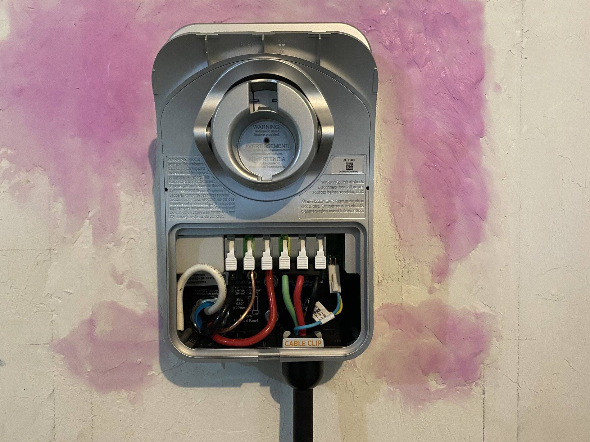

You do not have to use the Ford EVSE, It's standard SAE J1772 with CCS for fast charging.
The Mach-e will charge at 48A but you do not have to charge it at that rate. You can pair or set an EVSE for the capability of the circuit it is wired to. A 60A line is really heavy, gauge 6. Not handy by any means.
Your car would charge at about 28 miles per hour on a 40A EVSE. If you drive 100 miles per day and charge daily it will take 3.5 hours to replace the charge at 40A. In my area it is difficult to get them to go more than a 50A circuit ( 40A EVSE ) because they don't want to muscle a 6 gauge line. The price would be more for that.

Just finished wiring 6AWG THHN in conduit for my 60A run, which was not bad at all. Still need to complete the circuit at the panel, but I’m not in a hurry, since my MME isn’t even scheduled for production just yet.

Just finished wiring 6AWG THHN in conduit for my 60A run.
A few genuinely honest questions, because I'm looking to use the exact same EVSE and copper as you are.
Doesn't 6 gauge copper only provide a 55 amp circuit? Since you've got four conductors in that conduit doesn't that derate the circuit to lower than 55 amps? Wouldn't the 20% rule have the EVSE outputting 40 amps?
To get the EVSE to output 48 or 50 amps, wouldn't you need to upgrade to 4 gauge copper, which provides a 70 amp circuit?
https://www.southwire.com/wire-cable/building-wire/simpull-thhn-copper-wire/p/BW1
Am I missing something? Just trying to understand all this. I will hire an electrician but just like to do my homework first. Thanks.
It may depend on your local electrical code, but mine indicates that 6AWG THHN inside conduit is sufficient for a 60A circuit. THHN is rated for 90°C, while 6AWG Romex is not.
I included a white wire only to future proof my installation…if I move I’ll be able to remove the ChargePoint and convert the wiring to a 14-50 outlet.
A small point of clarification: While THHN-2 is indeed rated for 90C, it must be used at its 75C ampacity. Even at 75C, it's still good for 60A.
