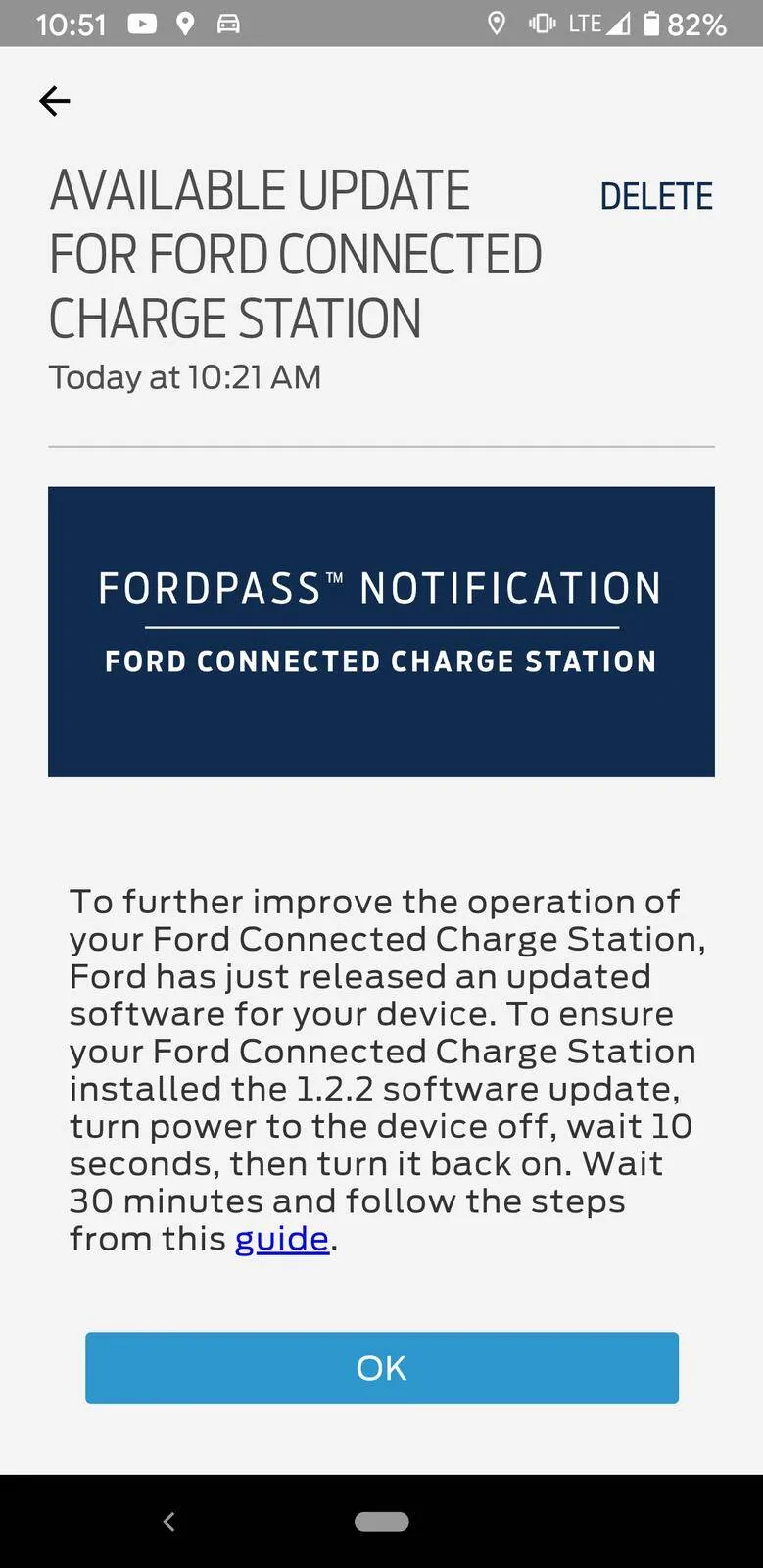

I received notification this morning of a software update for the Ford Connected Charge Station, to software version 1.2.2.
When I checked the version on July 4, it was already at 1.2.2. Prior to that, I was at version 1.1.7. All along, the Firmware Version has been 1.058.
Just passing this info along... Check your version before following the power reset guidance from Ford, as that may not be necessary.
To check your software version, you must be within Bluetooth range of the FCCS and then you can check the About page in the FCS Setup app.
And no, I don't know what changed. :)
Thanks for posting. My FCCS is connected and I previously paired it and went through the setup on my phone. Now when I go in to check the version the app crashes. I have to re-pair each time I go in to the app. I do not have my vehicle yet, which shouldn't make a difference. I'm also not sure my wifi connection is as strong as it needs to be in the garage although I'm not sure why that would cause the app to crash on my phone. Any ideas?

Thanks for posting. My FCCS is comnected and I previously aired it amd went through the setup on my phone. Now when I go in to check the version the app crashes. I have to re-pair each time I go in to the app.
Thanks for posting. When I open the app and click on About, it crashes the app. Then when I go back into the app I have to re-pair it to the FCCS. And if I try it again it crashes and I go through the same loop having to re-pairr it again...... Any ideas? I do not have the vehicle yet. I also wonder whether my wifi is strong enough in the garage and if that is a possible cause?
That was happening to me a lot on my Android phone, but not always... I submitted a complaint about it via an app store review. An update was published to the store on 6/17... Sometime before or after that point, I noticed that mine hasn't been crashing when I try to view the About page anymore.
Keep trying... When this problem was happening to me, it would successfully show the About page maybe 1 out of 20 times. :( Between attempts, I had to toggle my phone's Bluetooth off and back on in order to get another pairing attempt to the station to work.
