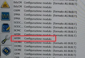

I do not see Walk Away Lock Audible Feedback in our current Mach-E Google sheet. Did you get some of these changes from elsewhere or from a different model, e.g. Lightning? Could you post the module numbers and values?
The settings to enable, editing in Forscan the APIM module (without as-built) are:
Ford Mustang Mach-E FORScan MME spreadsheet apim
- Walk Away Lock and Walk Away Lock Feedback
- Locking Feedback Audible and Locking Feedback Visual
These enable horn and lights with Walk Away lock and also with Key lock. The audible settings are not as-built in EU, maybe they are in US.
