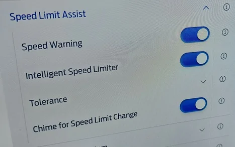

I enabled in Forscan the chime for speed limit but, after switching it on, it immediately turns off. Anyone tested this?
Adding the APIM change may only enable the toggle and not the feature itself. Some things require config changes to more than module for it to actually work.

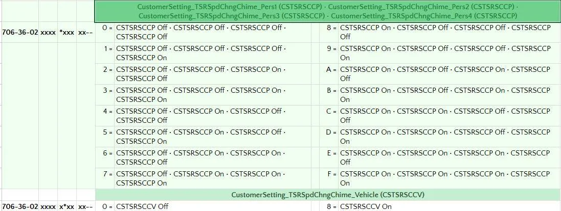

Maybe the key is in here?

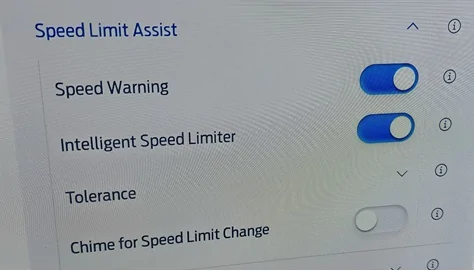

Right now, your car shows this:
Ford Mustang Mach-E FORScan MME spreadsheet 1731627486725-f
I would try xxxx F8xx xx--
Reboot the IPMA and test it. F8 there will turn everything on having to do with the speed change chime.

Thanks @rugedraw for your advice. I tried to set F8 but after saving the setting stays on 0000. I tried also to enable TSRS in the IPMA setting list but the chime toggle on screen always turns off.
Maybe try one independent of the other one. With my FORScan experiments, I've found that if you enable two events at once that clash with each other, FORScan will smartly revert the changes back. I would try just the 8 first and then just the F. If none of those work, I'm out of ideas for now. I'd have to dig through the spreadsheet to see if I find anything related to that.

No way unfortunately. The setting always stays on 0000. Maybe that setting is not for our MME or the module software version is not the right one.
Not sure. I did find that in the MME spreadsheet though.
