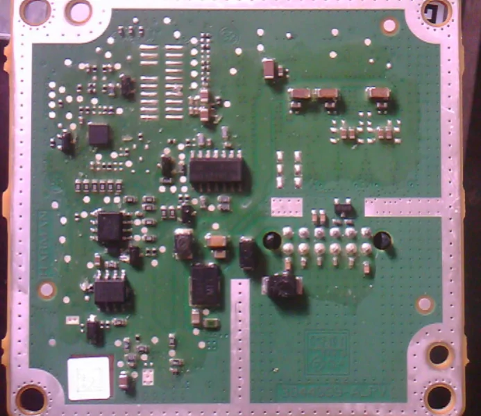

I would be more into disabling UFO sound than backup sound. Is it the same speaker?
Hello
It is the same sound system. In the trunk PACM module there are two samples, the humming sound and the garbage truck reverse beep sound.
The drive mode and speed determines what sound goes out to the speaker line.
Long story short, I have disabled the beep beep stuff on mine but kept the hum.
The sample data is in serial flash rom and while it cant be freely manipulated, it is possible to corrupt it so one specific sample is not used at all.

Whould you be willing to share how to do that?
ave
Feb 21, 2024
Finland
Mach-e GPTE '21
I have been considering publishing all the findings, haven't done so yet.
It is a bit involved process, for now you have to take the module out, take it apart, clean off some protective coating, dump the rom contents using debugging tools, alter the data, then flash the new data in
