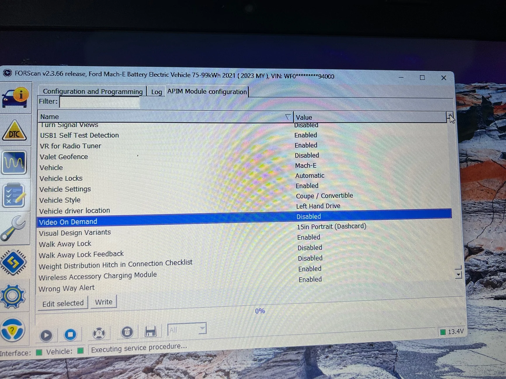

Hello. What doest Bideo on demand do ?
The only post I could find says “It allows you to watch DVDs on the Nav screen while the car is in Park. Not so with the GT350. I enabled the parameter, but the DVD I inserted wouldn't play“. Not sure he is correct. If he is, not sure it’s useful or supported on the MME.
