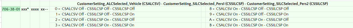

I don't know if the event for lane change assist is included in the 1.1E BC firmware, but check what you have here in the IPMA and change it so that ALC is enabled.
Ford Mustang Mach-E FORScan MME spreadsheet 1754665152710-4a

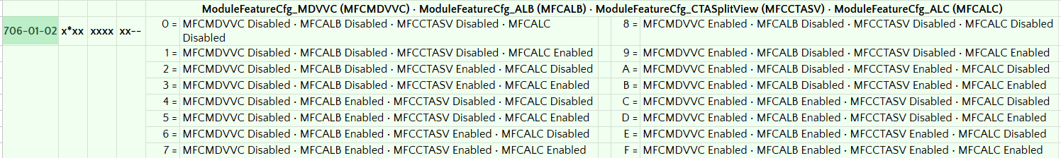

In line 706-01-02, x5xx xxxx xx-- is correct for US spec vehicles. FORScan will correct the checksum automatically to 0500 0000 0015 when you write the 5 in that location.
Edit: If you car shows 0600 0000 0016 from factory, you need to change that 6 to a 7 to enable ALC and keep ALB & CTASV enabled.
Ford Mustang Mach-E FORScan MME spreadsheet 1754665552622-wl
