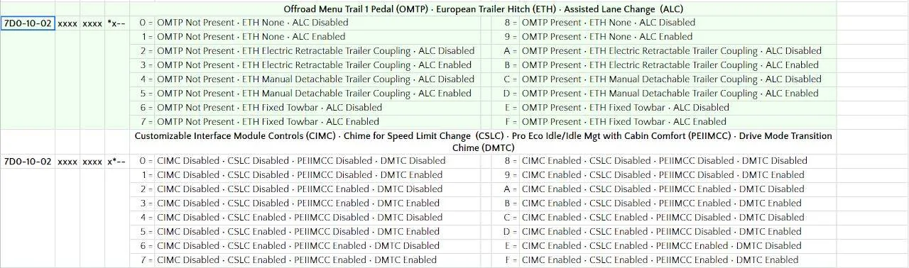

Going by an example I saw to enable BlueCruise, I turned on MFCALB and MFALC yesterday and got the Lane Change and Lane Bias in BlueCruise. Some of the other values were different since my car has GF High Beams. The spreadsheet was very helpful to sort out the differences.

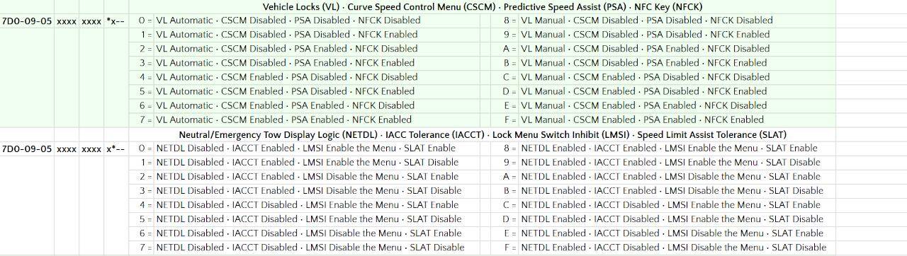

I noticed my 2021 Mach-E has parameters not called out in the APIM for the Mach-E, but are called out in the APIM for the 2024 F150. They are for the Predictive Speed Assist, Speed Limit Assist Tolerance, and the Assisted Lane Change features. I found it interesting that the BlueCruise example I saw had Neutral/Emergency Tow Display Logic enabled and it was disabled on my car. It was also interesting that a zero value does not always mean disabled.
I think it may have something to do with 2WD and 4WD models having a different value there, but cannot say for sure that's the case.
