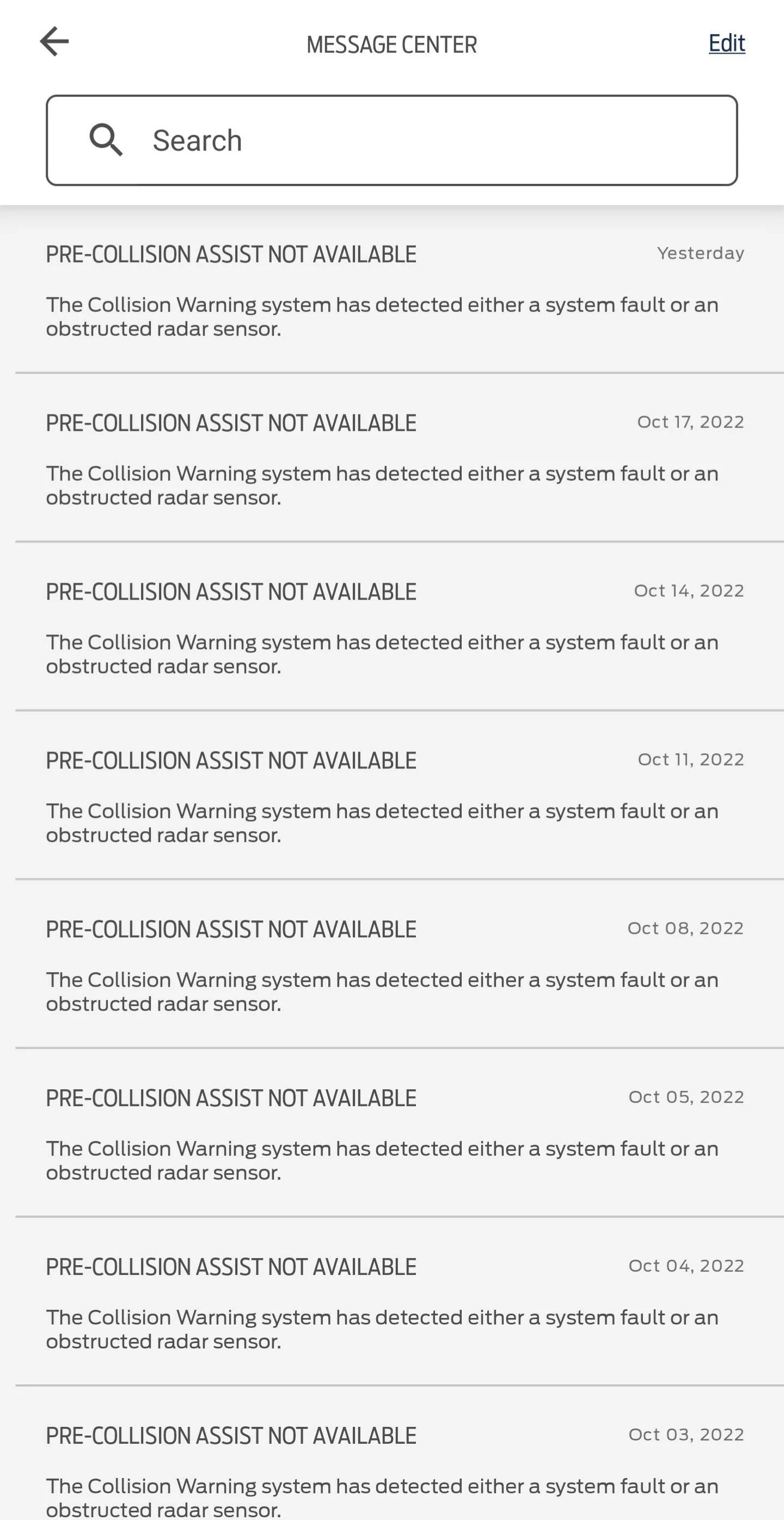

Mine have been regular. These days, it seems to appear when first starting the car in the morning. Here is a good snapshot of the frequency

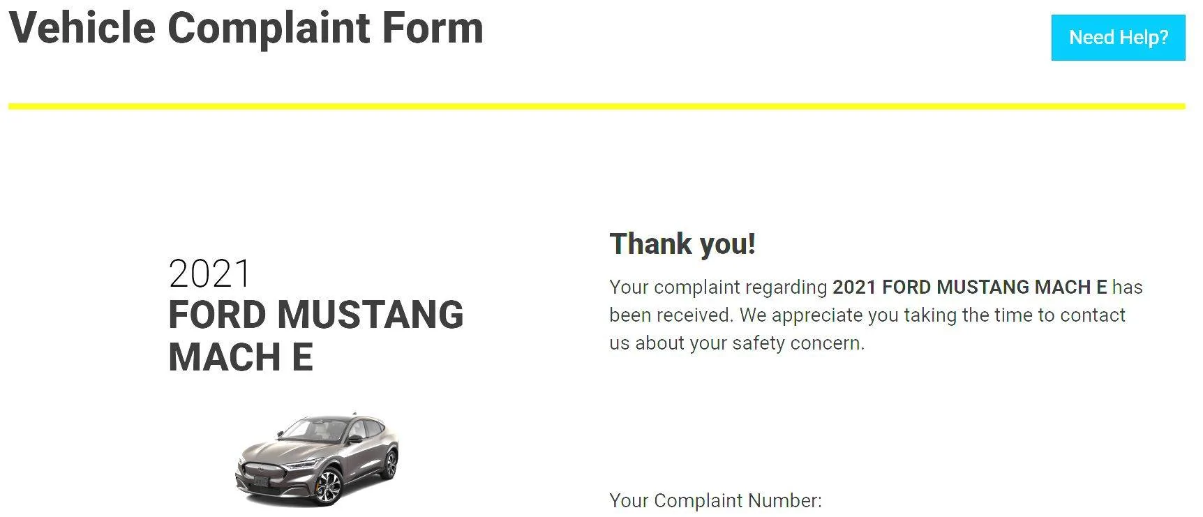

I just submitted a Vehicle Complaint Form to NHTSA, and I would strongly encourage anyone experiencing this serious safety flaw in the United States to do the same. Click here to submit your own report. It takes but a few minutes.

TheSteelRider
Dec 31, 2019
57
1,296
2,309
United States
'21 Premium RWD
Doesn't Ford have enough information at this point to resolve this issue or provide an idea what is occurring?
That is exactly the part that bothers me the most, and ultimately drove me to submit the safety problem to NHTSA. Clearly, this is a systemic problem that is becoming more wide-spread with literally zero comment, acknowledgement, update, nor resolution from Ford. I'm not hopeful that Ford will make any concerted effort at this point to solve the issue unless the United States government becomes involved.
My FP looks similar. I get the error messages on the dash almost daily but only a fraction of the matching error messages in FP. I guess it is a good thing that FordPass doesn't send me a message for each occurrence or that mailbox would be full by now. :)
I’m very interested that I have no errors in FP… makes me wonder why…

I think there is a setting in FP to turn on notifications for various things. That is one of the choices. Hunt around for it.
I just realized that I only get the Pre-Collision Assist Not available messages. Never the Front Camera Fault or any of the other minor messages. To me that seems to indicate a fault with the Pre-Collision Assist system may qualify as a safety related item. Just thinking.... ?
Same here. Only PCA errors appear in Ford Pass for me, not the FCF. This (combined with the apparent wide spread nature, inability for my multiple dealer trips to fix) is ultimately why I reported a safety problem to NHTSA.

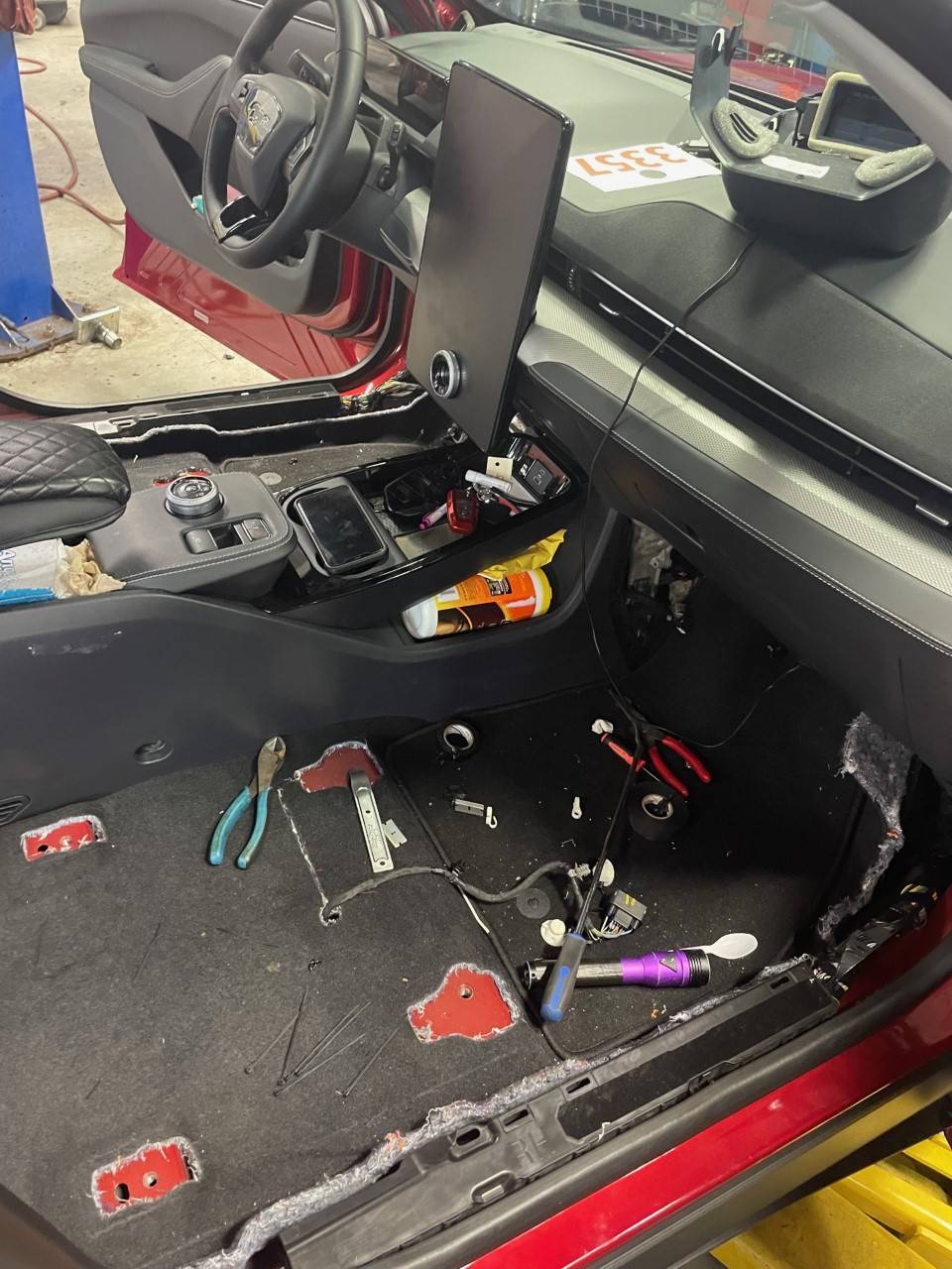

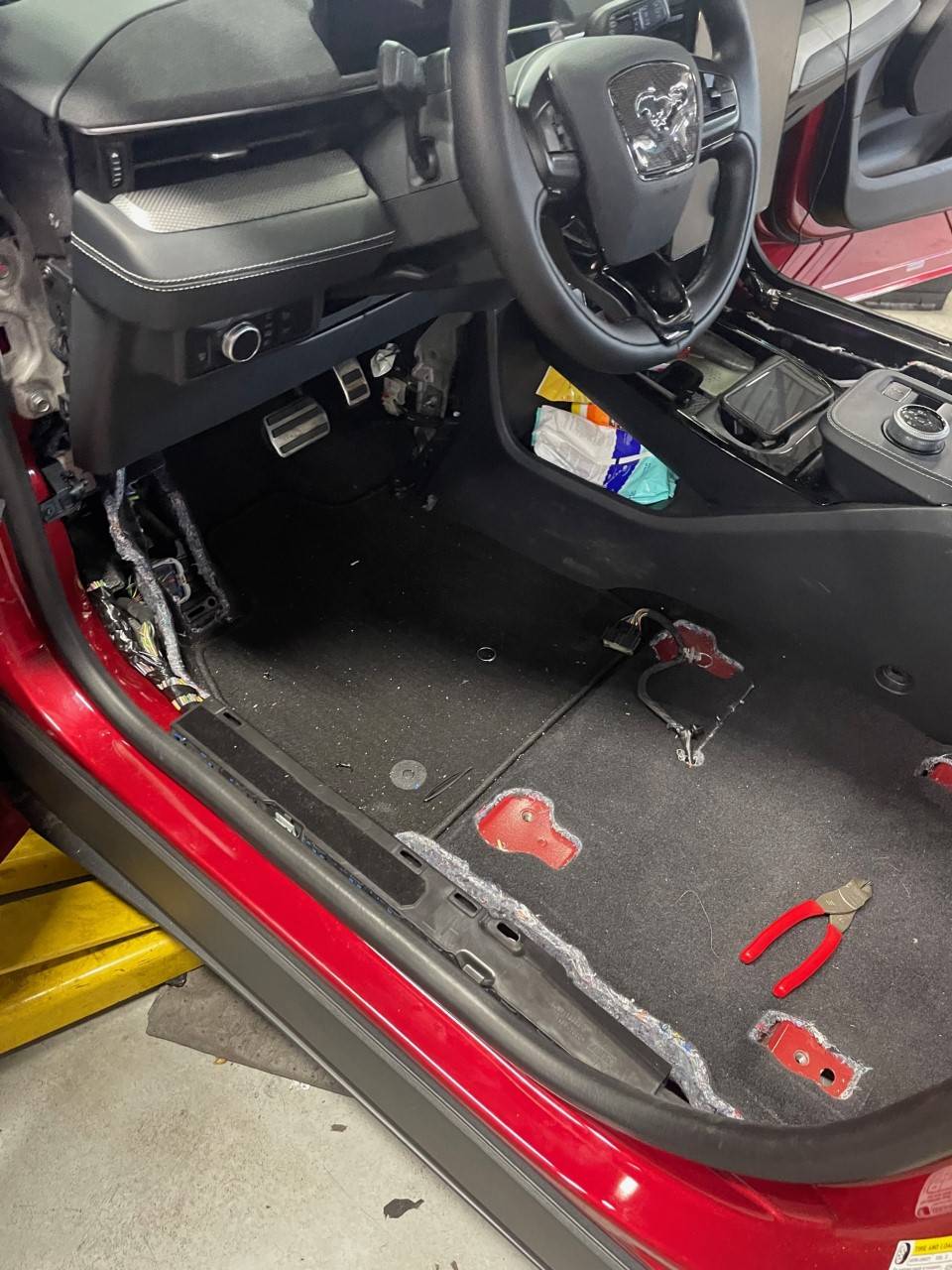

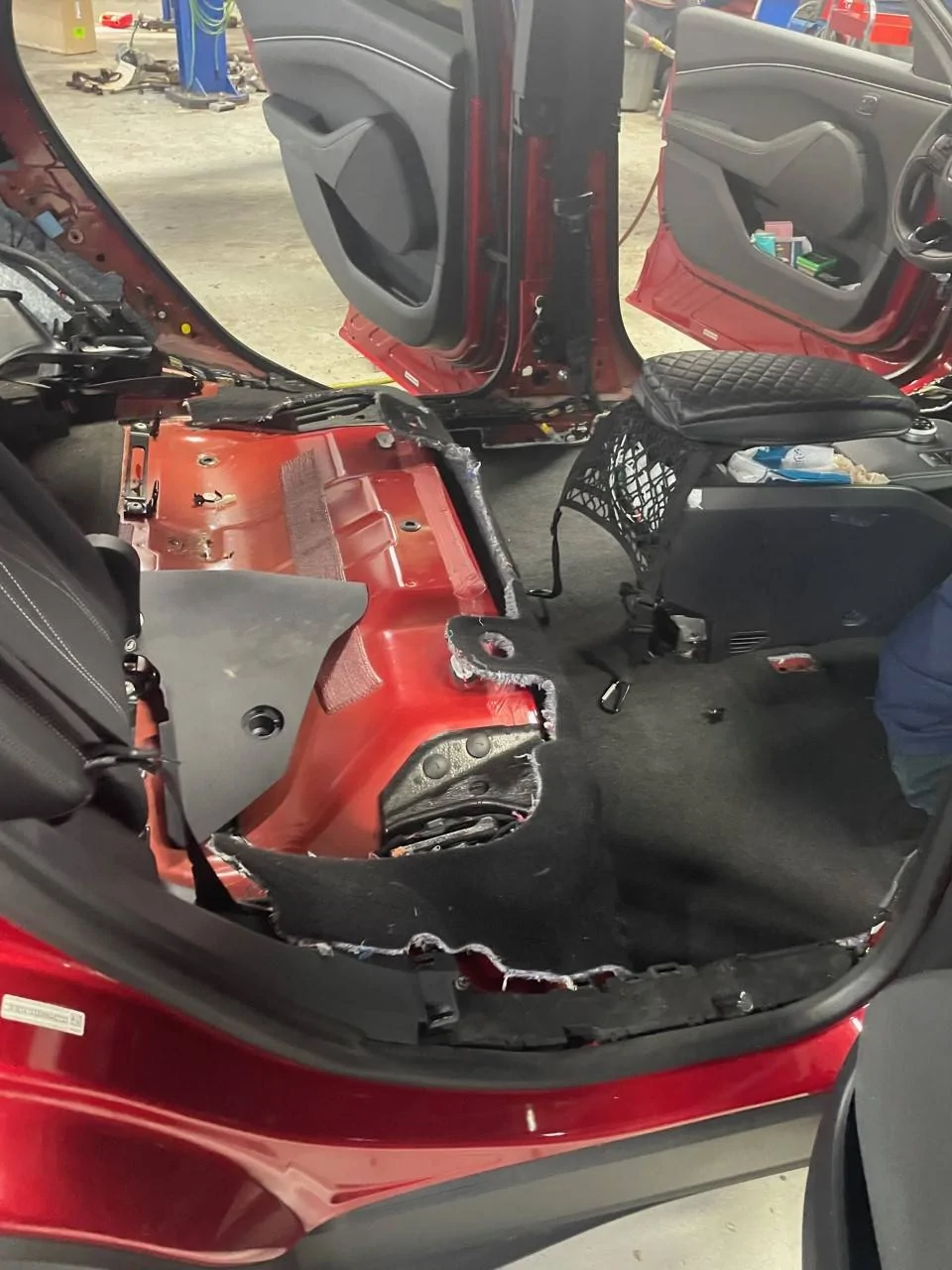

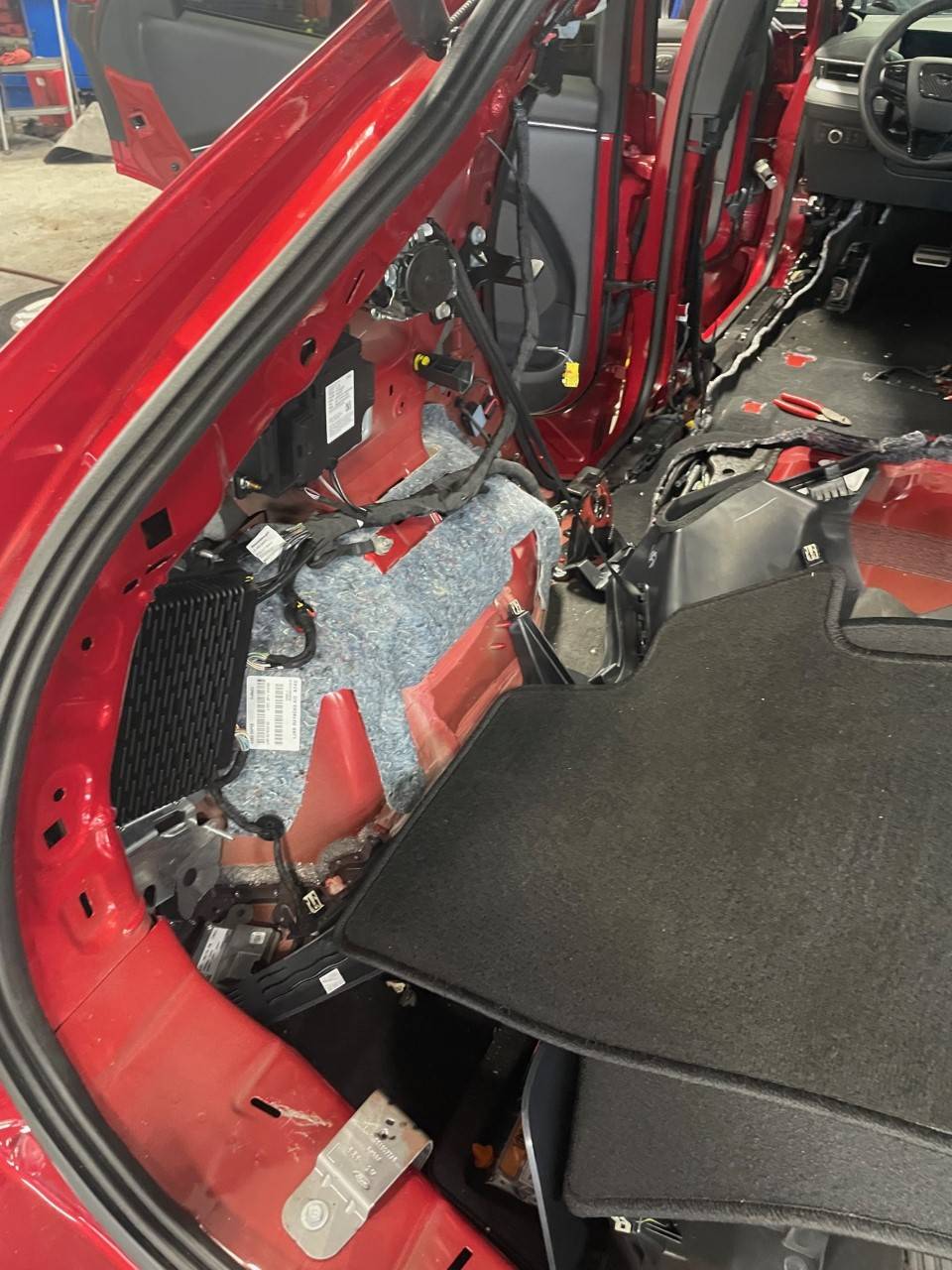

Kcko11
K
Oct 4, 2022
New jersey
Ford Mach-e 2021
Sooo….since June and multiple visits, they’ve updated and reprogrammed the software on the IMPA and PSC, replaced the IMPB, reprogrammed the SOBDM and BECM using FDRS, replaced the cables connecting to the modules/cameras. They showed me photos of all the work needed to replace the cables.
Nothing worked so far. The last fix currently, however, is they have replaced the camera on the windshield and that one is working so far. Crossing my fingers.
