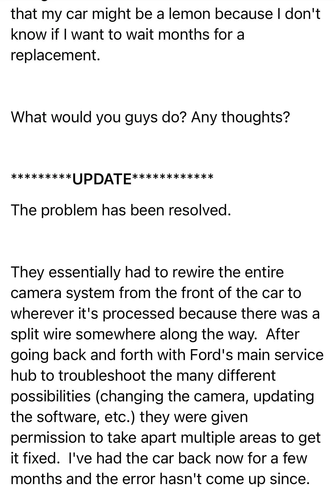

I saw this on a fb thread about the front camera. Do you think getting the camera rewired might solve the problem?
That interesting.
Can you post the link to that post?

I don’t have the link. It was in the group titles Mach E Owners. I’m not a member but went in and searched pre collision assist fault

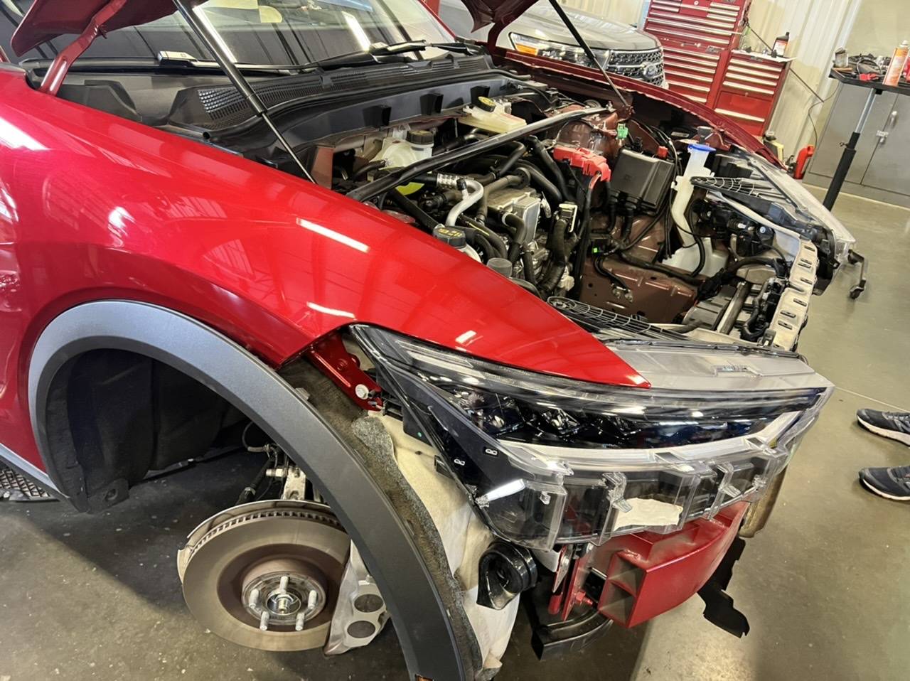

Mine is at the shop now. New camera… failed. New module… failed in 5 minutes. Now, a regional engineer is supposed to be working on it personally. They pulled the frunk out to get to the wiring.
No ETA on when it will be fixed. 8 months without a working camera. How do lemon laws work exactly?
@superwaddle Hey, any updates on the frunk teardown of your MME to find faulty wiring for the front camera? Did it get fixed? Or did you give up?

I ended up enacting the Ford Buyback, and they purchased the car back from me. As of the trade in date, they still had no actual way forward on a fix. The frunk tear-down allowed them to swap out the module, which promptly short-circuited and resulted in even more electrical issues.
I bought a used Camry that has no fun features and gets 40 mpg and gave up on EVs for now.
Hmm. So I can easily buy this as being some of our issues, especially us Job-1'ers who had the windshield recall, because they literally had to disassemble the interior to complete that recall.
But, it's strange that some Job-2s and GTs are hitting the issue. That would say there has been a manufacturing issue for almost 2 years on this vehicle that has yet to be fixed. It also would be strange to have such a problem on so many vehicles for the issue to all of a sudden show up regardless of build date.
I don't doubt that poster (although it is a random copy/pasted post from some random group page on the internet), but my gut tells me that's a one-off.
Ugggg. That plain sucks big time... nobody really wins here. You lost your sweet MME BEV and went back to an ICE. Yes, you got your money back, but the root cause was never identified or satisfactorily repaired by Ford. Environment suffers too. I'd only take a complete buyback with another brand new MME GT sitting next to my current one documents all ready to sign!
