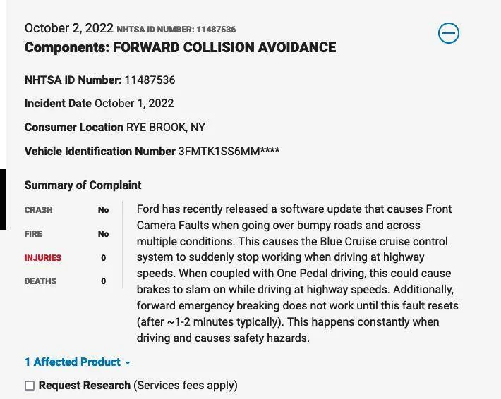

ha ha... sure... all better.... now i've got issues with BC not kicking in. It does, but it seems to be sort of sporadic when it actually fully activates.
I did get the fault twice today... and it did fully deactivate and 1PD "slam on brakes" on the highway... SIGH... though now it seems completely random. It didn't happen when going over bumps. I also had a few times when it just completely cancelled and didn't give any error messages at all...
