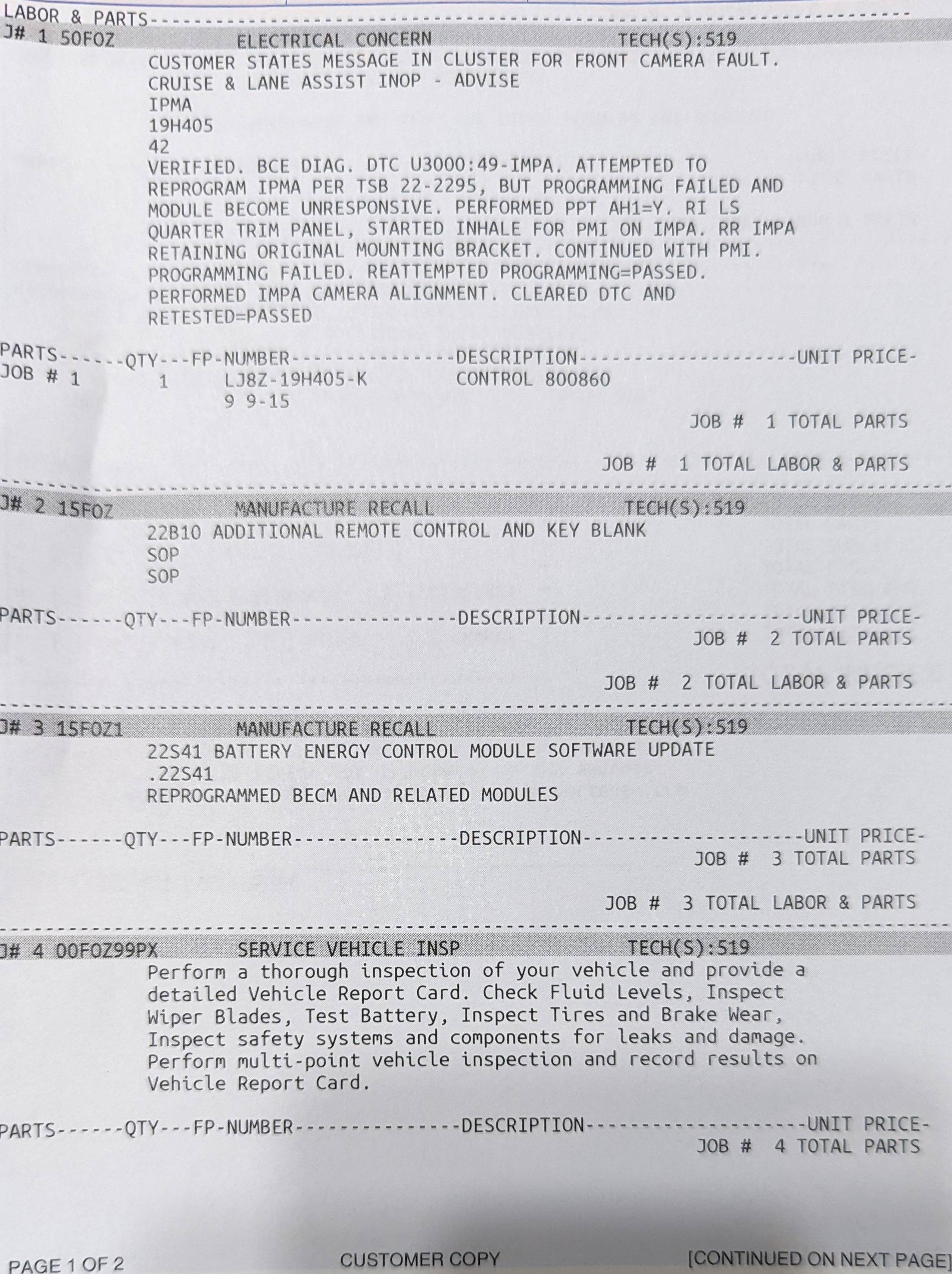

The very first thing tech should do is pull trouble codes (DTCs) and if you have the naughty IPMA ones, apply TSB 22-2295 steps exactly to the tee! My dealer's EV tech may have skipped part of the steps in this TSB! Thanks @Mach-Lee for assisting! I'll post updates ASAP.
Curious on exacting details here, if you have them; or if you don't have them attempt to learn them. In my case, my understanding was that the tech went through the TSB as stated, but I'm still experiencing problems.
Just got back home from picking the car back up ... For those following along, here is the invoice. Note the programming issues mentioned by other folks and some reset issues.
Here are relevant snippets of the invoice. Note this time, this dealer did reference and go through TSB 22-2295. They replaced the IPMA, then had some programming issues to overcome with the new module (I believe that's been reported elsewhere in the forum as well), and finally re-aligned the camera.
