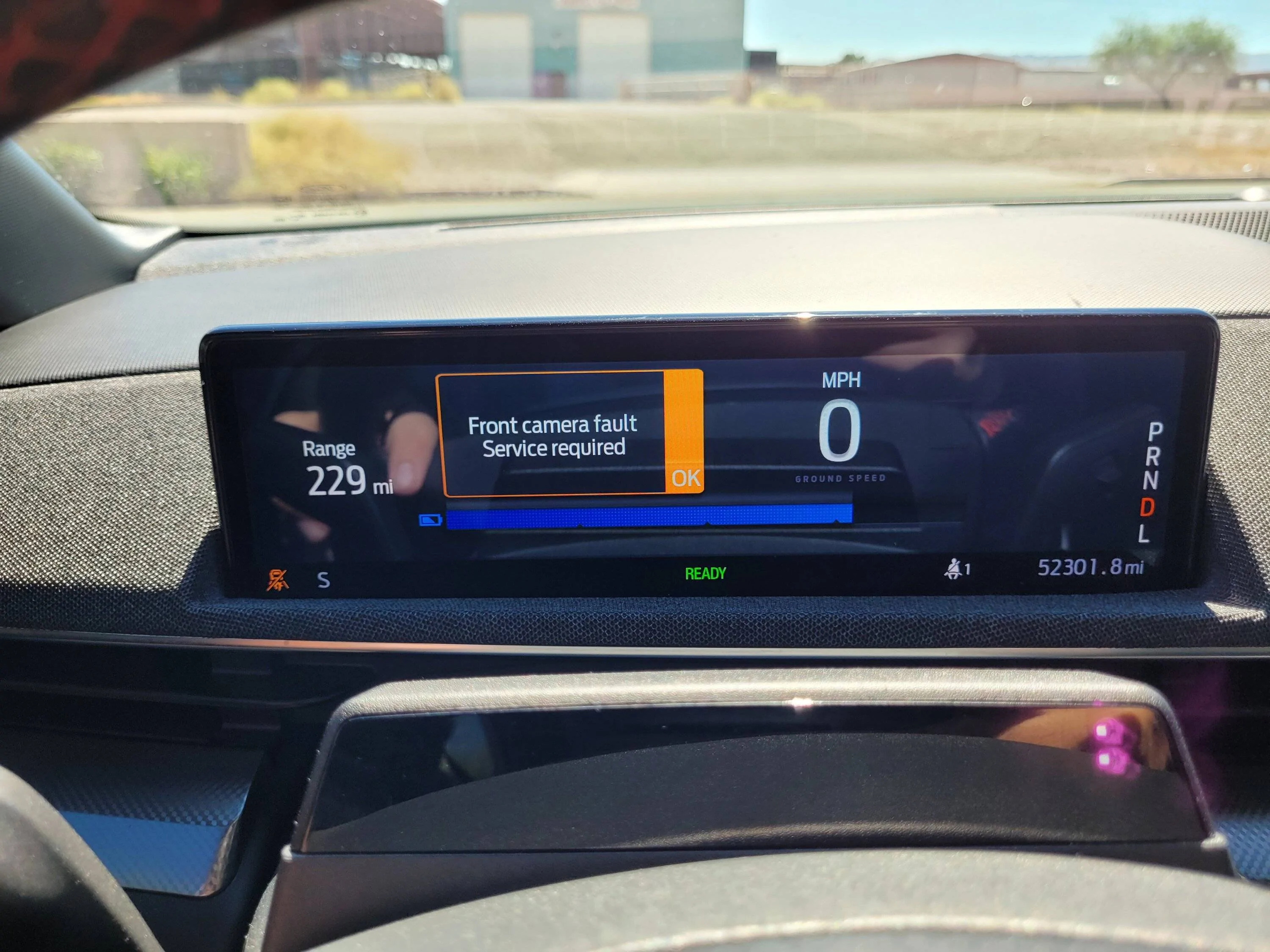

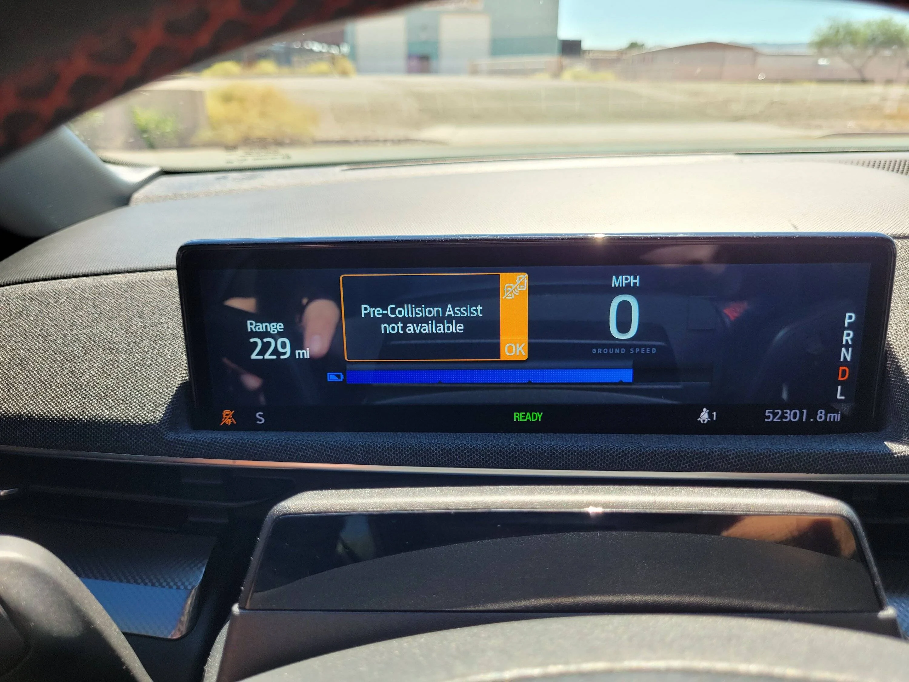

It could be hardware but I am doubtful. The two most common situations where the faults occur are at first start up from my parking space at work and the HOV ramp from 1-10 to US-60. In both cases, when the fault occurs the orange icon remains for a prescribed amount of time. I can literally predict exactly when the system will resume normal operation. As I approach 40th St from the office and before the Kyrene underpass on the freeway. If it was bad solder joints or loose connections then I would expect the faults and restore events to be much more random.
Leaving the office for lunch....
Interesting. Since my last long rant post, I've also been trying to pay closer attention, and a similar thing happens. About every 2 days, the fault occurs at first startup in the morning in the driveway. The other times it happens may be on certain stretches of a nearby interstate south of us, but we don't take it often enough on that particular route for me to feel confident in saying that as certain quite yet.

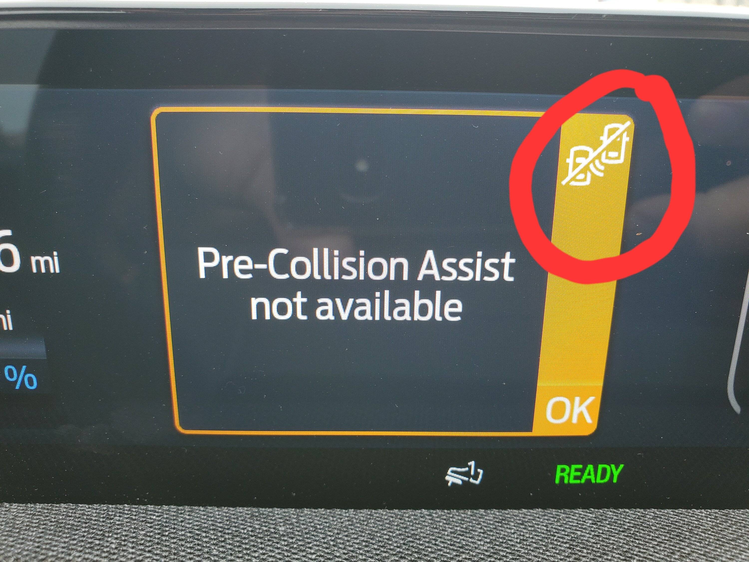

Ford Mustang Mach-E Front Camera Fault & Pre-Collision Assist Not Available Errors Pre-collision fault
I I just noticed an incorrect icon inside the "Pre-collison Assist not available" warning message box. Isn't that the symbol for cross-traffic alert?
