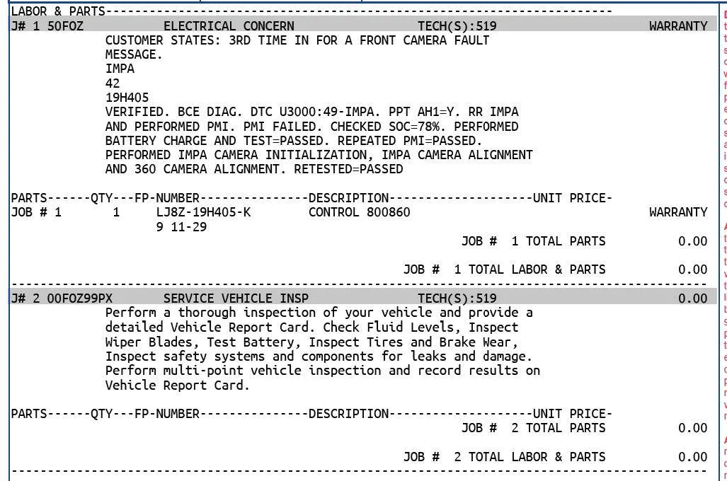

Just got the car back from dealership fix attempt #3. This time, they replaced the Control Assembly Audio Visual Unit LJ8Z-19H405-K. Did another 360 camera reset.
Ford Mustang Mach-E Front Camera Fault & Pre-Collision Assist Not Available Errors 1670373907291
So, to recap for those not interested in reading the first 37 pages of this thread,
  • June / July-ish started receiving Front Camera Fault sporadically
  • By August-ish Front Camera Fault turned permanent on, which brings loss of Cruise Control and other basic functions
  • August - Dealer trip #1 - Replace IPMB, perform 360 camera reset
  • Within 1 day, fault message re-appears, within a couple weeks becomes permanent again
  • September - Dealer trip #2 - Replace IPMA, perform 360 camera reset, reprogrammed APIM and TCU
  • Within 1 day, fault message re-appears, within about 4-5 weeks becomes permanent again
  • Late November - Dealer trip #3 - Replace Control Assy A/V unit, perform 360 camera reset
