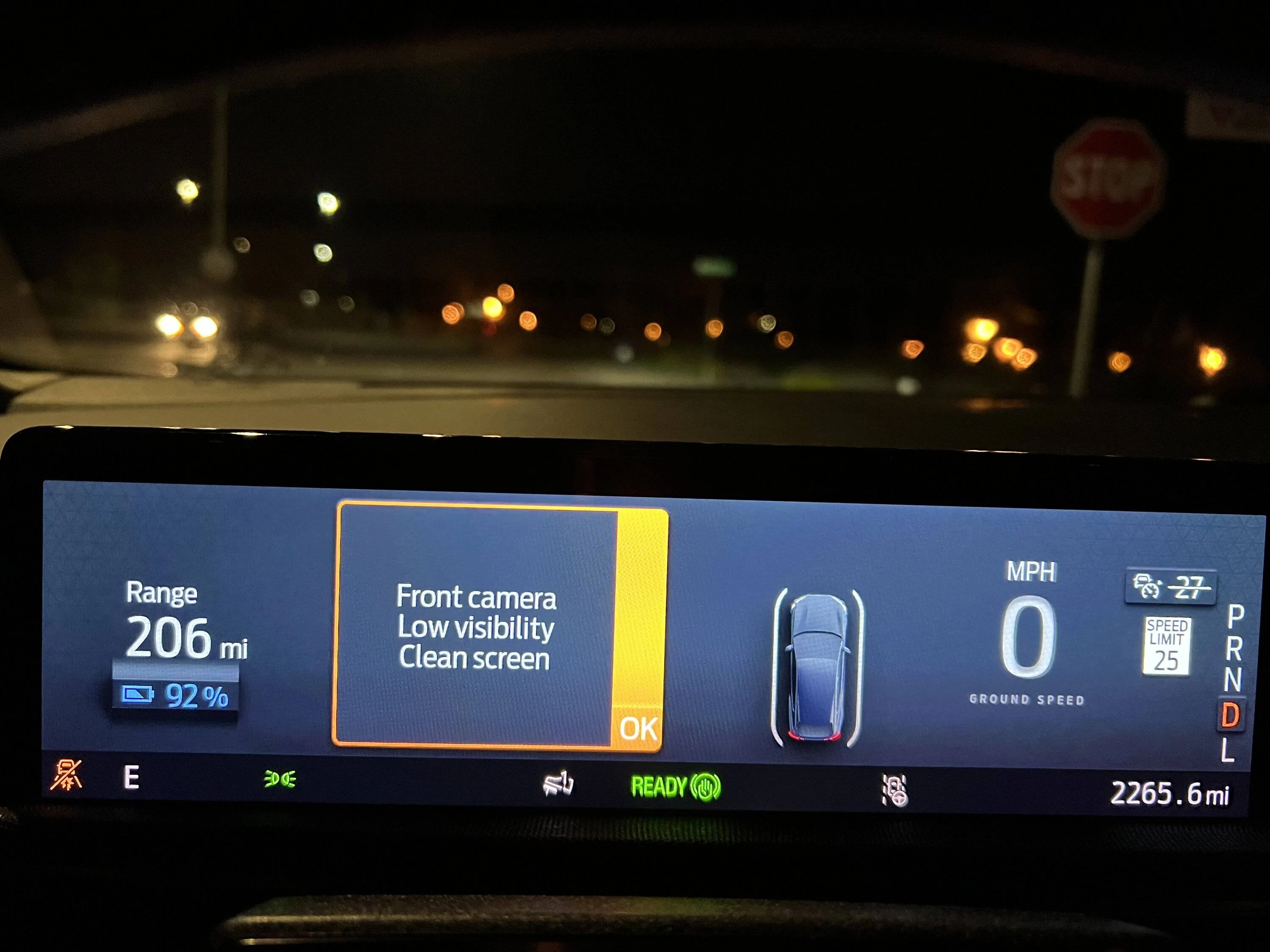

I’m on my second Mach-E (went from a new 2021 Select to a new 2022 CA Route 1) and this appeared today.
Second time in two week. I’ve got around 2200 miles on the car and in my second month of ownership. ?
I think I have to take it in for service this week to start the clock on recording when this issue started….

Uhh, I would start out by simply cleaning the windshield and front grill thoroughly as this msg is not what we all see with FC/ACC Not Avail faults.
