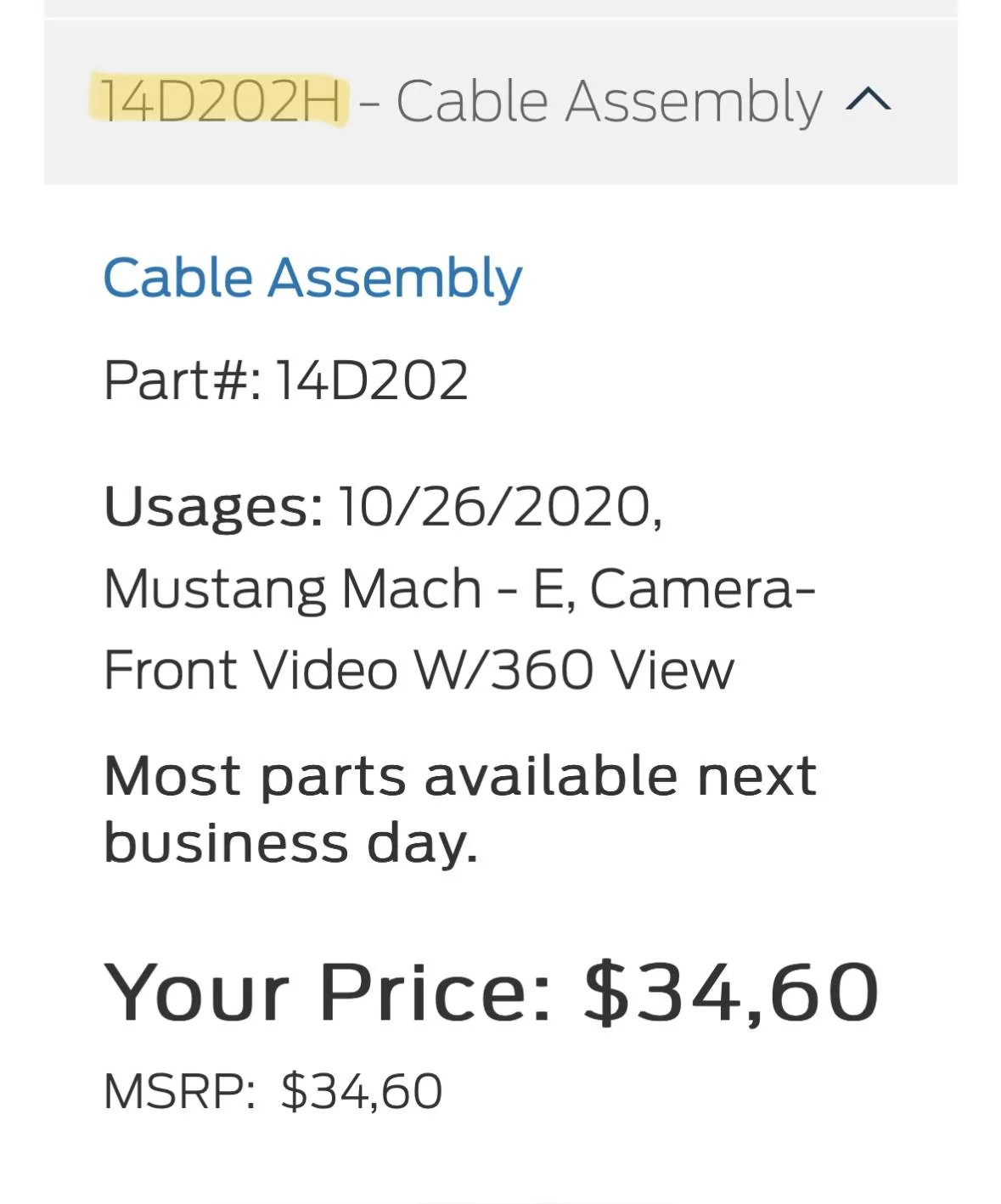

Nice! I might need to order the cable and install it myself. Do you have a part number from your repair ticket?
I am still getting the errors although much less frequent compared to the summer. I only see this about once a month now.
It may still be in my car. I’ll take a look when I get off of work.

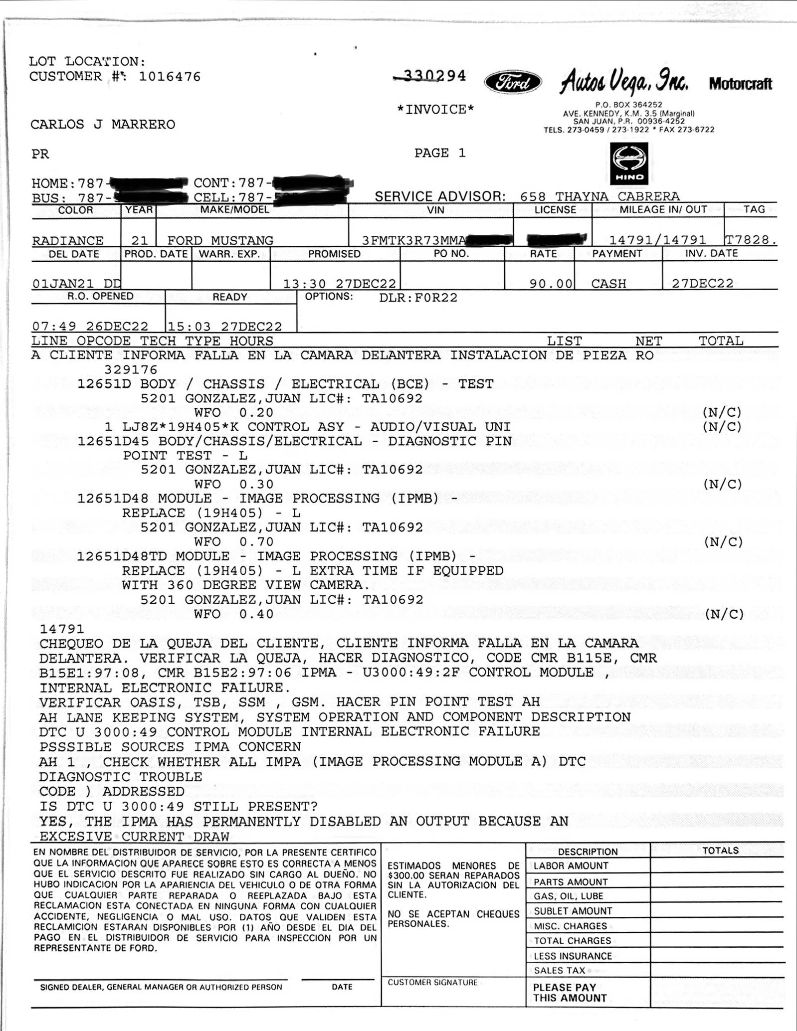

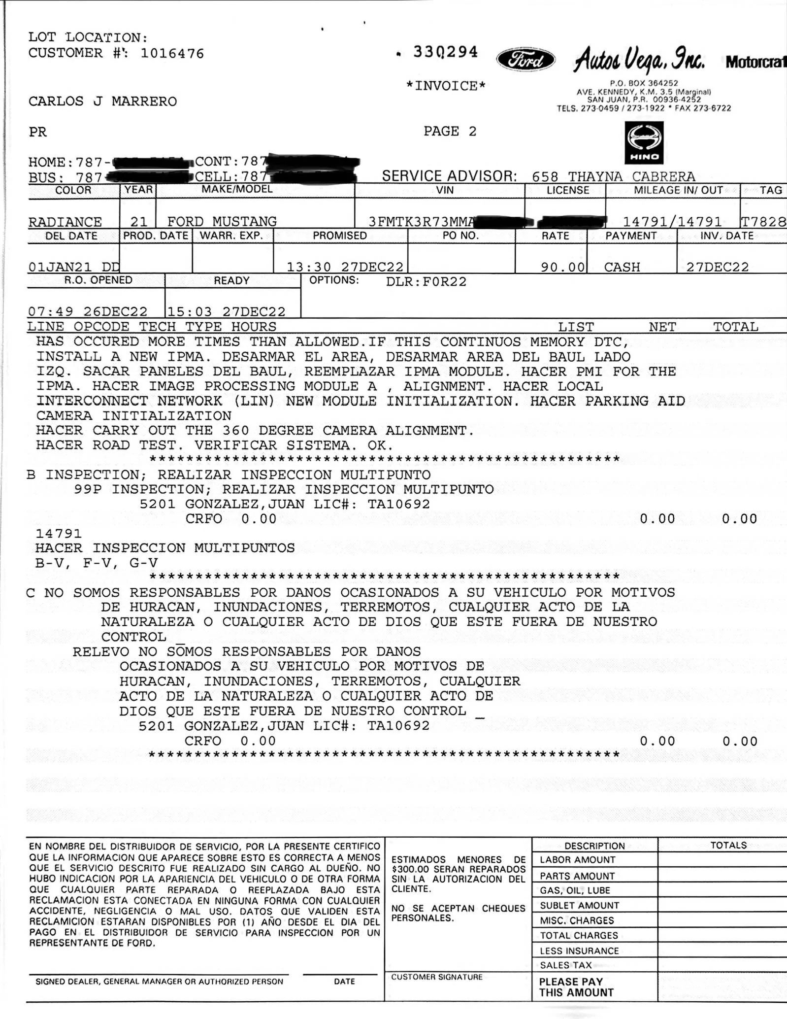

Hi from Puerto Rico. I have my 2021 Premium RWD job 2. The damn failure started around last summer. First, the error started coming out for about one to two minutes and then everything was normal. I did it every two to three days. Then he continued to increase the ruling until in October it became permanent. It is the same story of many here. I took it to the dealership the same month of October and on the same day they diagnosed the failure in the IPMB. I told them about the coaxial cable that goes from the camera and they told me that they were going to inspect it visually. However, they diagnosed only IPMB. They returned it to me the same day. They called me last Friday to take it last Monday to change it. They delivered it to me yesterday and at the moment I have driven 30 miles and so far everything is fine. I will make an update here later with the status of the pony. Here are the worksheets.
Ford Mustang Mach-E Front Camera Fault & Pre-Collision Assist Not Available Errors C680E5FB-ACC4-4E51-AC00-3AED7FCAD783
Ford Mustang Mach-E Front Camera Fault & Pre-Collision Assist Not Available Errors 342FBCD7-208A-4513-B2A9-04BDBA04AC0F

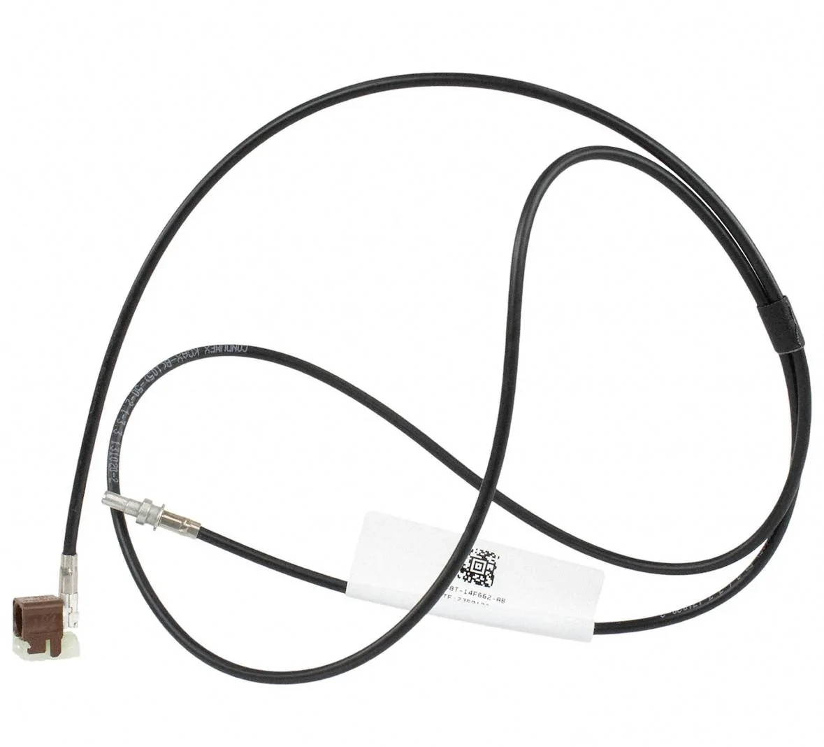

@SnBGC Don't forget the special glue to attach new coax cable to your headliner! Dealer had to order that too as part of the complete replacement.

@SnBGC Don't forget the special glue to attach new coax cable to the headliner! Dealer had to order that too inorder to complete replacement.
Thanks for the tip!
If possible, I would probably leave the original cable in place and sister the replacement along side with zip ties (or similar).

Thanks for the tip!
Remember that the coaxial cable is a fragile and delicate cable. Whatever you use to put them together don't push it too tight.

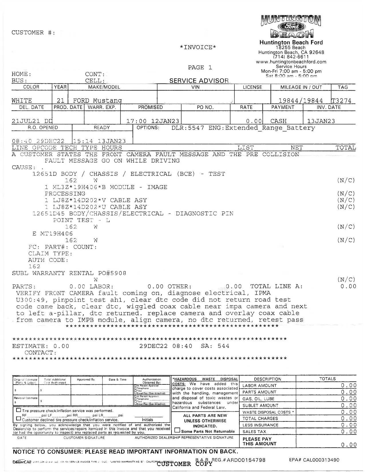

Well, sitting at the dealer for the third time reading all 42 pages of this thread!
they did the windshield/pano recall of my June ‘21 CA/RT1 and these 2 errors kept popping up until it just came on when I turned the car on
also an occasional “Reverse brake assist not available” error.
I’ll bring up the coax connector as it makes sense after they ripped that area all apart.
hopefully it’s as simple as that.
EDIT: Today December 30, 2022, the dealer told me that yes, the Coax was damaged and possibly the front camera as well. They've ordered the harness and the front camera. Should be in by Jan 3/4th and we'll setup a new appointment.
fingers crossed!
EDIT: Today Jan 11, 2023 brought the car in as they said the parts are here! They had her all day, but never go to her... I have a POS loaner now and hope they'll get it installed in the next few days.
/not impressed
EDIT: Toady Jan, 17, 2023. I picked up the MME on Friday 13th all finished and after 5 days no return of the error messages!
So the Coax was/is the problem, I see they also replaced the windshield camera, maybe due to the braking of the Coax also busted the connector? Don't know, but it seems to be working now!
There was also an intermittent "ReverseBrake Assist not available" that they were able to 'see' and fix. Said had to drive in a straight 'line' a few times to 'align' the steering. Yeah, I did it a few times too, but it still kept popping up. But no errors so far.
Enc: Invoice/what they did
Ford Mustang Mach-E Front Camera Fault & Pre-Collision Assist Not Available Errors CoaxCam
