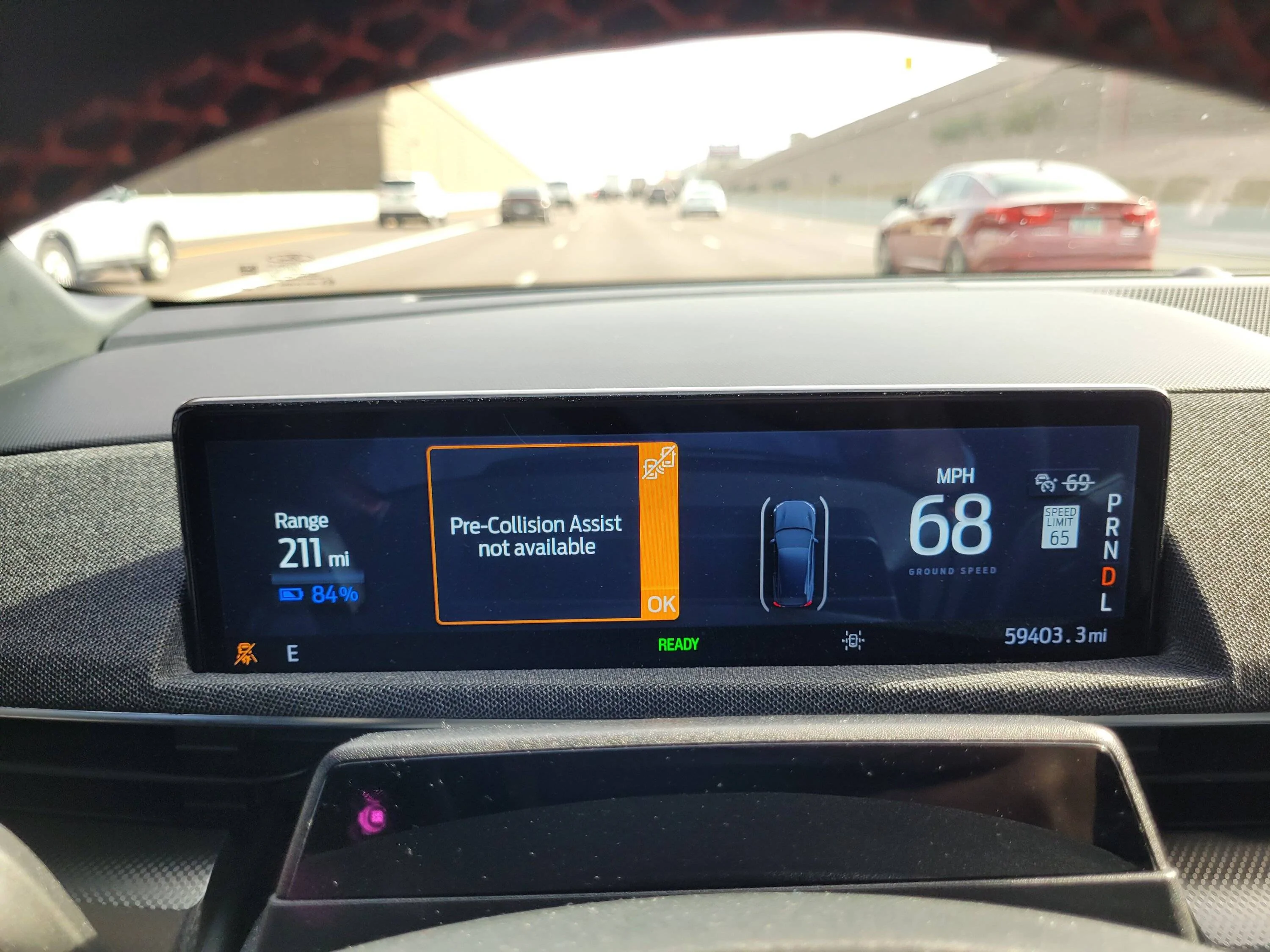

I am still getting the errors although much less frequent compared to the summer. I only see this about once a month now.
Ford Mustang Mach-E Front Camera Fault & Pre-Collision Assist Not Available Errors 20221227_112425
