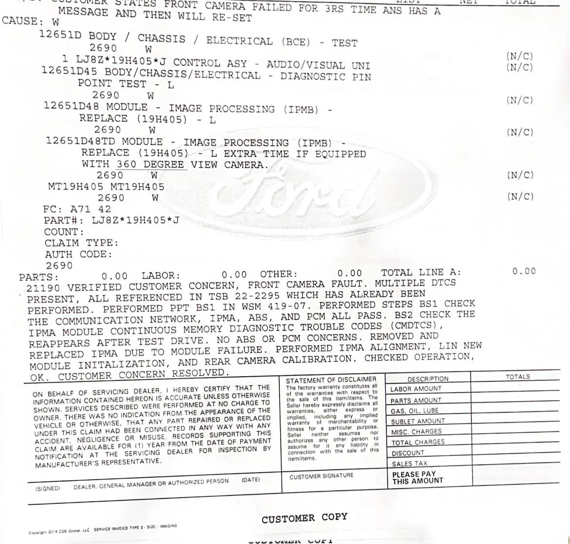

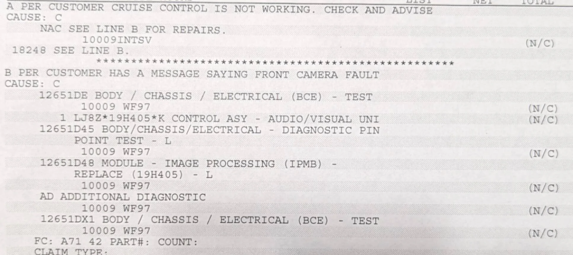

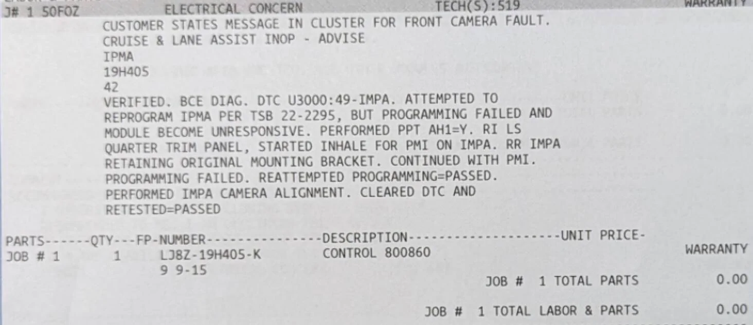

LJ8Z-19H405-K is the IPMA. So they replaced it a THIRD time?
TheSteelRider
Dec 31, 2019
57
1,299
2,314
United States
'21 Premium RWD
My earlier post in this thread includes shots of the other two invoices, but here is the relevant snippets. Hopefully someone can come back with a decoder ring and verify what parts were actually replaced based on these
(1)
Ford Mustang Mach-E Front Camera Fault & Pre-Collision Assist Not Available Errors 1670506298062
(2)
Ford Mustang Mach-E Front Camera Fault & Pre-Collision Assist Not Available Errors 1670506345112
(3)
Ford Mustang Mach-E Front Camera Fault & Pre-Collision Assist Not Available Errors 1670506389963

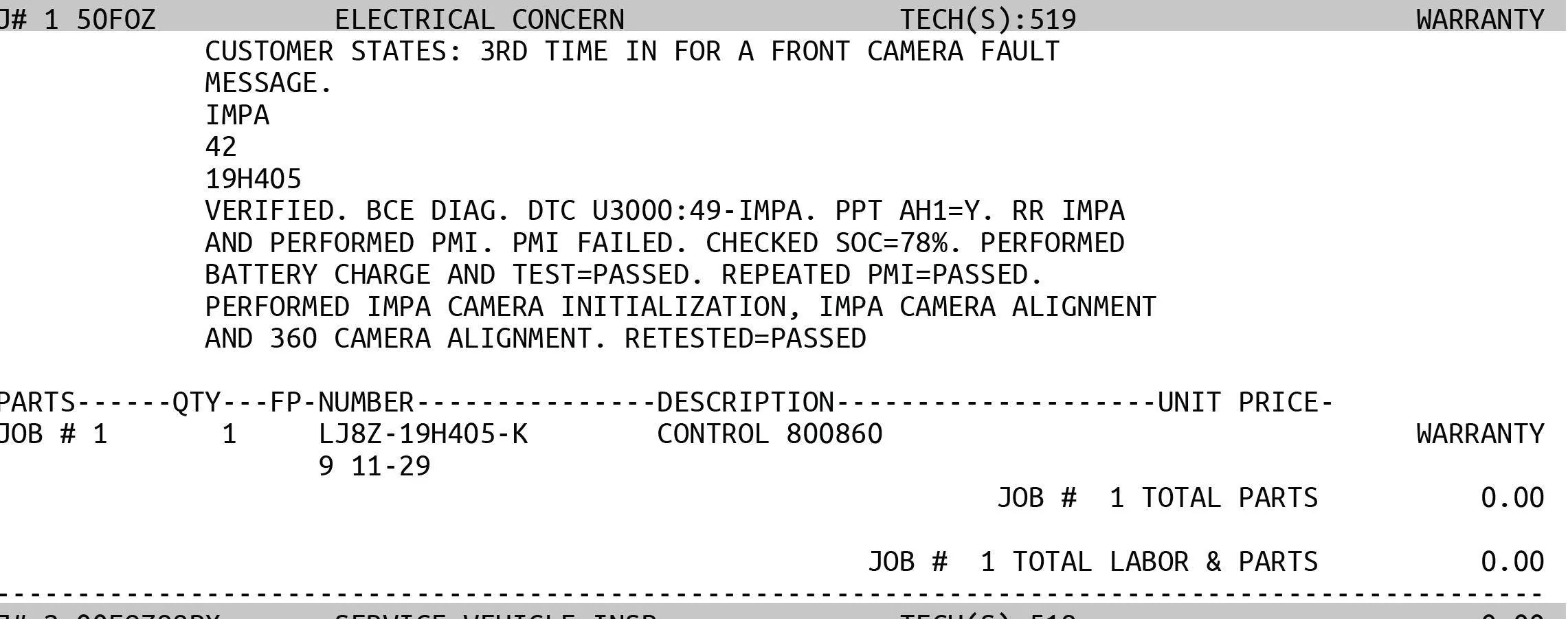

Third attempt : things are working again - not sure from attached report exactly what was done. It says the IPMB module but then the IPMA module replaced. ?‍♂
