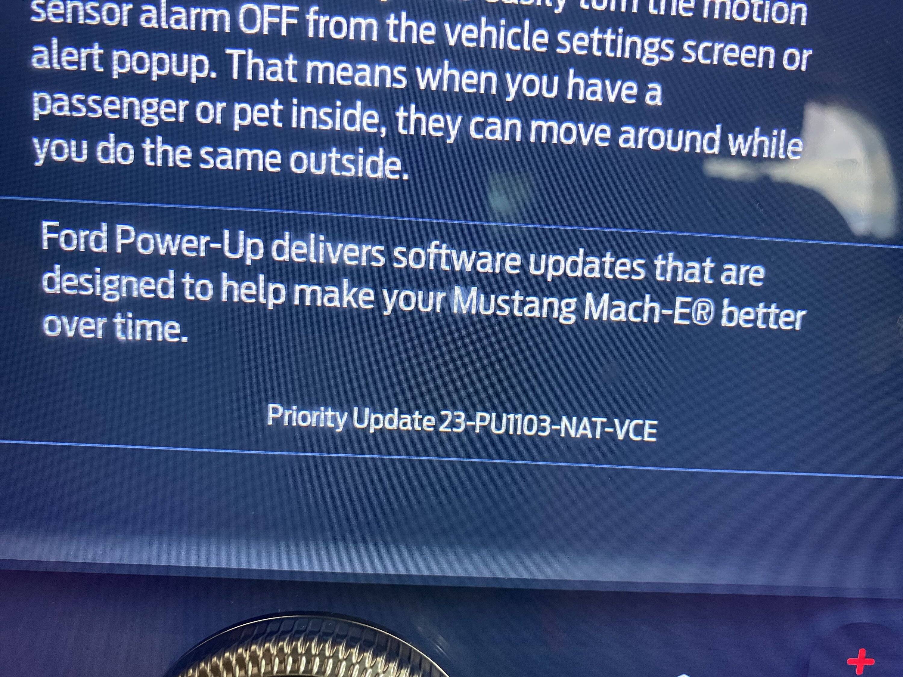

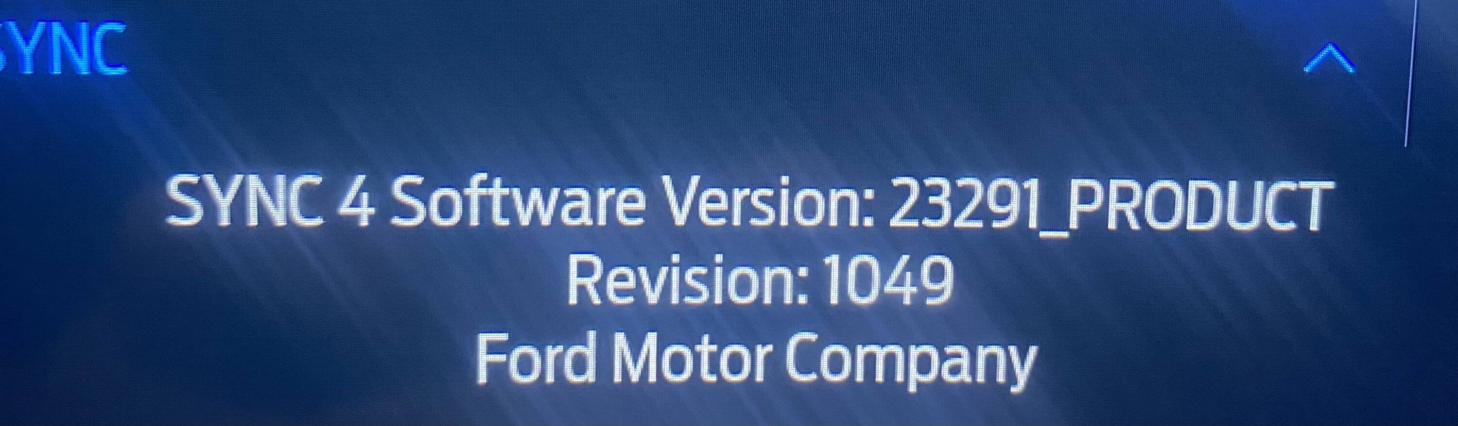

What version of SYNC is shown in Settings > General > About?
I think this was fixed for me in Power-Up 6.2.1. I don't remember what version is shown on the About page for that. Hopefully someone else can post it.
I think I have 6.2.1 based on the updates screen? I’m not 100% how to interpret it!
