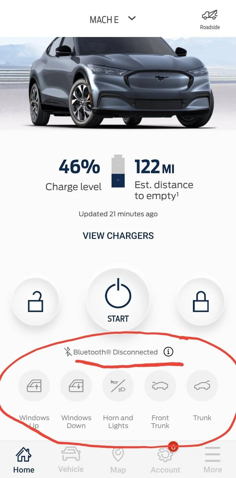

Ford Mustang Mach-E Frunk Open Button (via App) Update Screenshot_20210819-081244_FordPass
These smaller buttons I believe only show up if PAAK is set up. This is because these buttons ONLY work when FordPass is connected to vehicle via Bluetooth (must be within Bluetooth range). If it says Bluetooth Disconnected, those buttons won't work. If it says Bluetooth Connected, they will work (except for front trunk at this time) the front trunk button shows up with a Body Control Module update that was just released this week.

This was the result of a Body Control Module update performed by your dealer. (Unrelated to PAAK update)

Please see previous posts.. the frunk icon will only currently show in FordPass if a dealer updated your Body Control Module this week.
