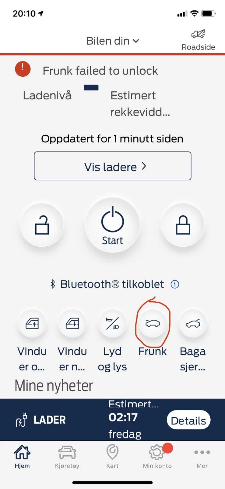

So it’s great that we are all talking about this new exciting feature that maybe a small number of people have gotten (those with the Dealer-installed body control update)…. But from what I gather from this thread, nobody has actually confirmed that the frunk open button on the app actually works!
From what I read there’s a button on the app, when pushed gives an error message. Somebody tell me that I’m wrong???

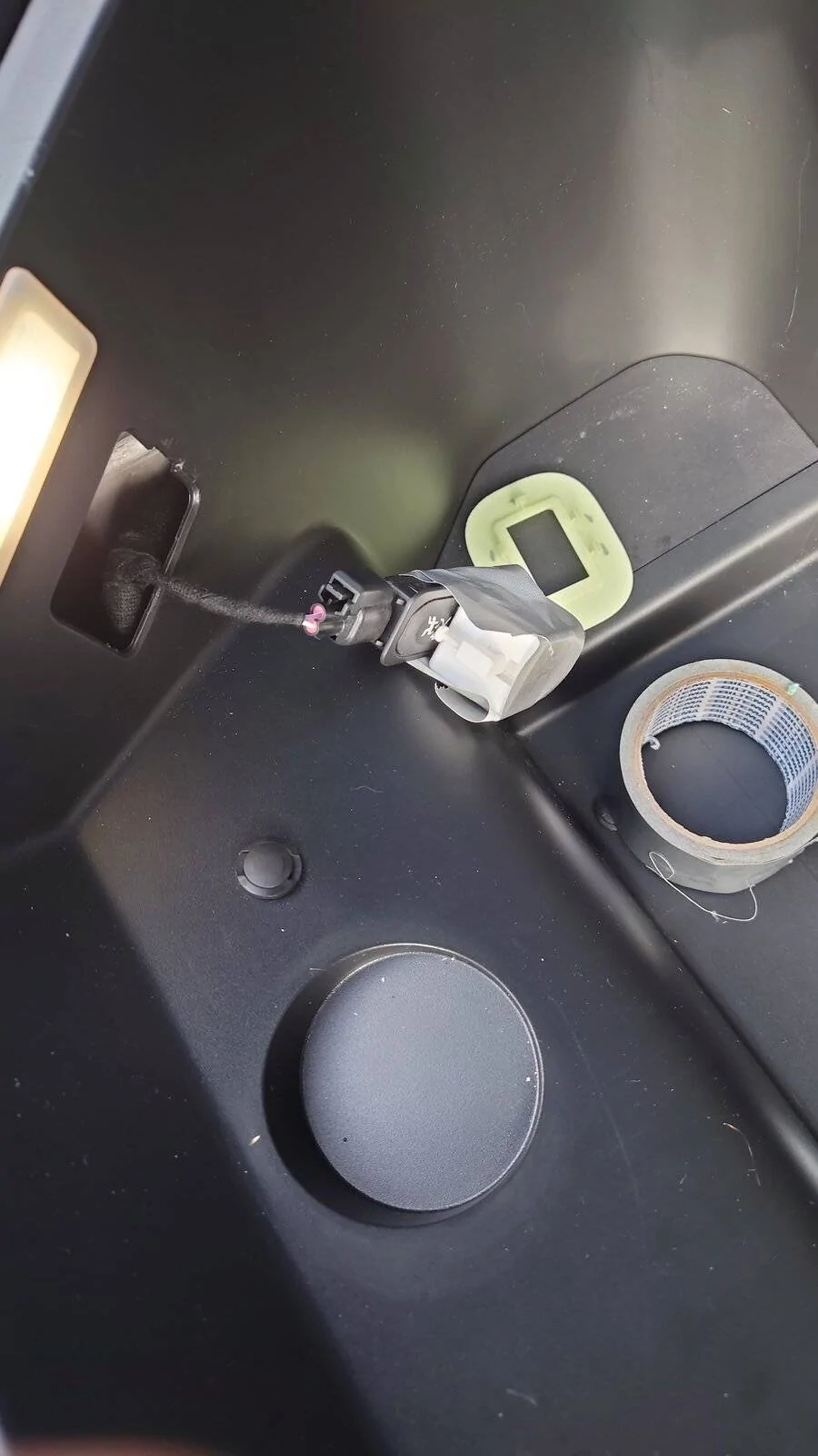

Has anyone ever tried to activate the in-front trunk button while the front trunk is closed (either by some clever mechanical way like a coat hanger), or by somehow bringing the switch outside the Front Trunk?
I tried with a Fingerbot. Nothing happened, so it seems to be deactivated for now.
I think Ford has acknowledged that is is inactive. Hence the frunk divider.
Yes and as Jon said, that button will not open the front trunk. It is connected to the BCM and needs to be updated to allow it to operate. I tried changing the code for it in Forscan but was unsuccessful. I did not put a lot of time into it as Ford will be giving us an update at some point to make this work anyway.
On a side note, I was able to open the front trunk electronically by applying power to the latch actuator. However I did not add an inside switch to activate the front trunk hood like I did for the rear hatch ( #1 ) because unlike the rear hatch that will only open when the car is in Park and off, the front trunk hood will open anytime you apply power to the actuator which would not be too good when driving the car. You need a power source that is only active when the car is off and no such thing exists. I would have to make up a small circuit to make this work and since I have only used the front trunk once in the 4 months I have had the car, not to interested in pursuing this.
