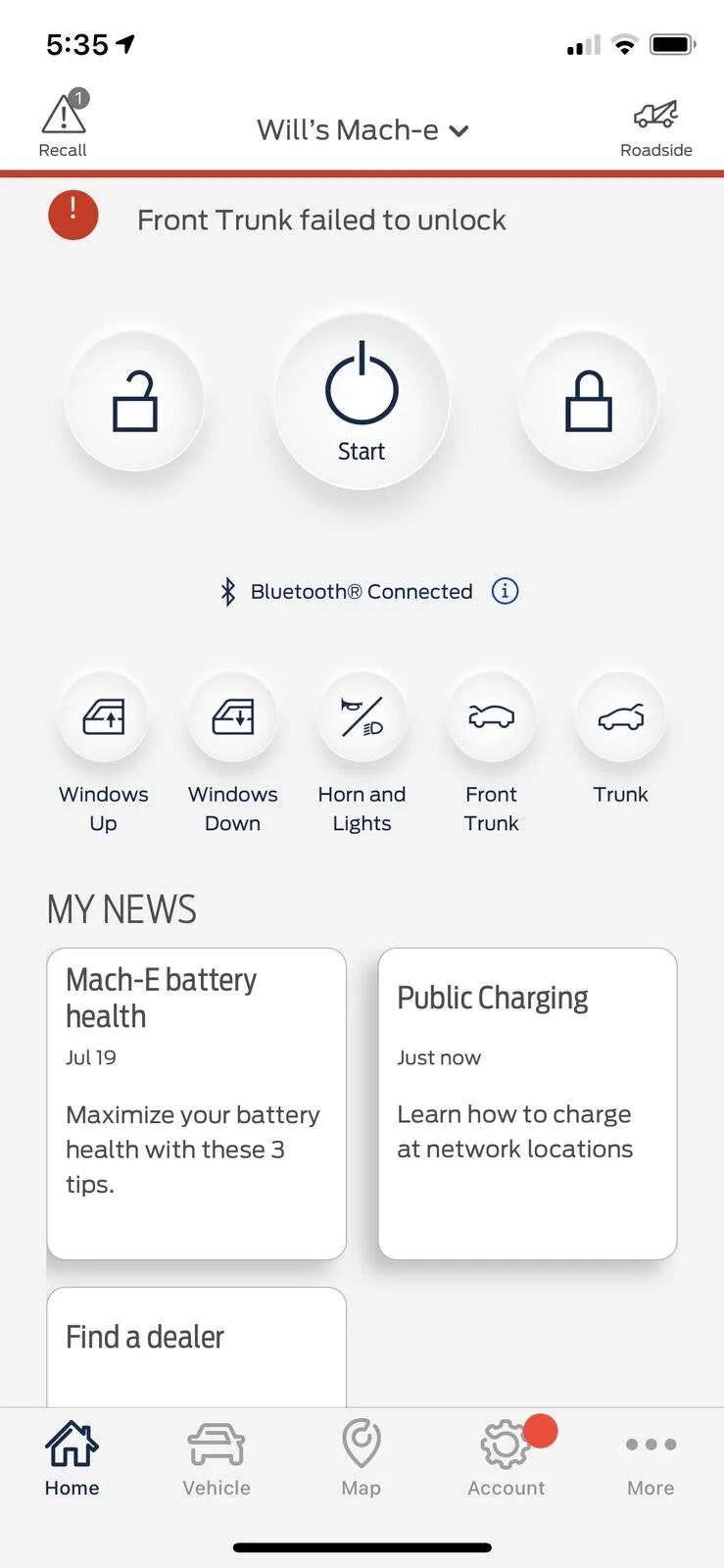

Took my Select AWD in for the PAAK update and after it was done, noticed a Front Trunk button in the app next to my Trunk Release button. Tried it out. …so close. Lol

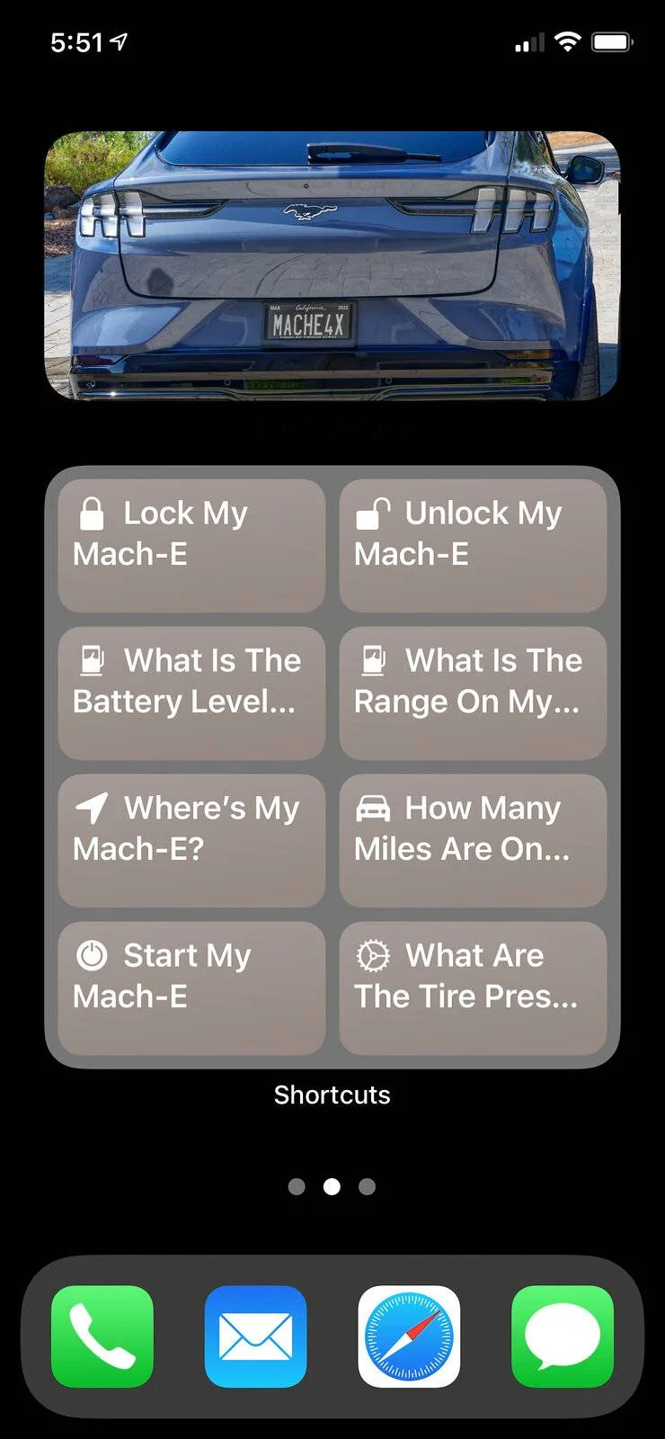

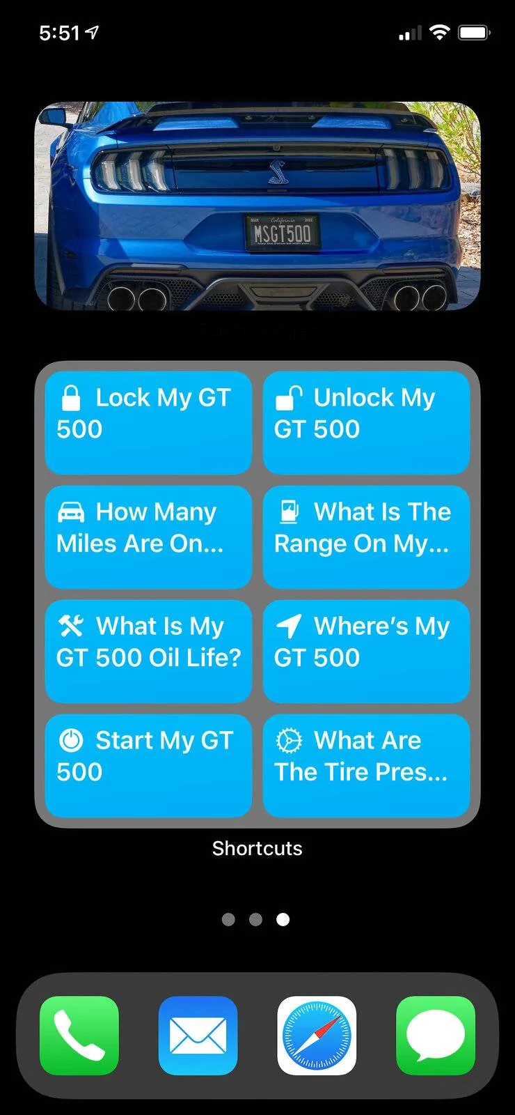

Last year I created shortcuts for my GT500 then added widgets on my home screen for lock/unlock and start. I have since added more and just gave it its own screen. Then did the same thing for the Mach-E. It's easier to use these widgets since you don't have to open the Ford Pass app and they are also on my Apple Watch. Even though I created these screens on my phone, I really don't use them as I just ask Siri to run any of these shortcuts so I don't even need to get my phone out.
yeah I’d love an iOS widget with range information and app icon quick actions for lock/unlock start
I made up two shortcuts/widgets that give range information and battery level.
I have explained how to create shortcuts for some commands and then you can create widgets for the ones you want. #5
Below are the two screens I made up but like I said, I just use Siri and never really go to these screens.

Whoa, those widgets are pimp! Have to try that after I get my GT.

Yes and as Jon said, that button will not open the front trunk. It is connected to the BCM and needs to be updated to allow it to operate. I tried changing the code for it in Forscan but was unsuccessful. I did not put a lot of time into it as Ford will be giving us an update at some point to make this work anyway.
On a side note, I was able to open the front trunk electronically by applying power to the latch actuator. However I did not add an inside switch to activate the front trunk hood like I did for the rear hatch ( #1 ) because unlike the rear hatch that will only open when the car is in Park and off, the front trunk hood will open anytime you apply power to the actuator which would not be too good when driving the car. You need a power source that is only active when the car is off and no such thing exists. I would have to make up a small circuit to make this work and since I have only used the front trunk once in the 4 months I have had the car, not to interested in pursuing this.
