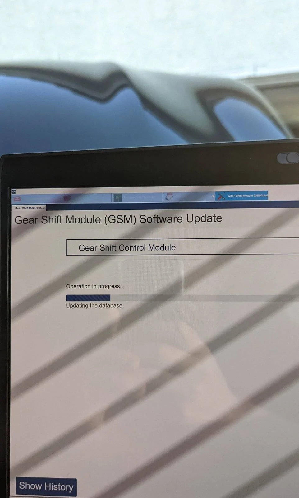

I just updated mine. Thankfully I didn't have any heart attack moments like @ProximusAl. It took the update without issue like all the previous without any DTCs after.

The one thing I noticed when I did mine, is Sync 4 kept running playing music. Normally it shows "Vehicle Communication error". I wonder if it didn't shut down all the modules properly before doing my update which caused my issue. Usual washing machine noise from the frunk was present during update.

This is because the GSM is on HS-2 CAN and likely that is the only CAN bus it put to sleep. As long as the APIM and BCM can talk the APIM will stay on and run. Most functions of the car will keep running.
This is normal depending on what module is being updated.
