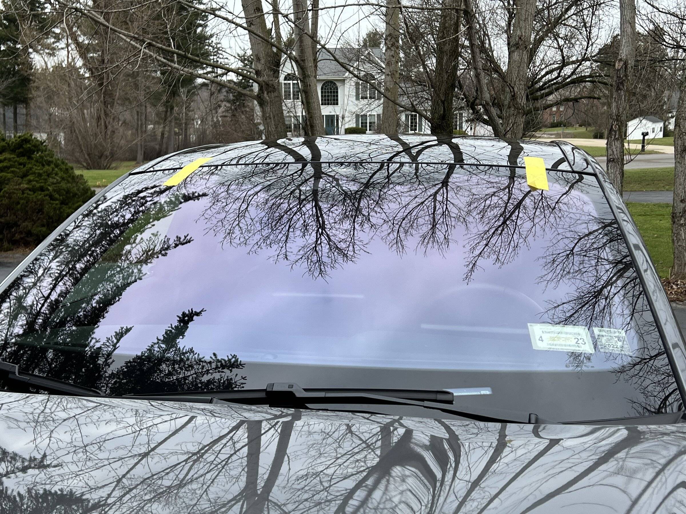

BTW, I took Marlin in for a Monday reservation (Dec 6), got him back on Thursday (Dec 9). Apparently they had trouble getting some of the modules to install and had to try it repeatedly. They said they finally got them all
This will be a problem for Ford to get PowerUps to work in the future, especially for complicated installs. It makes sense that Ford has so far kept each PowerUp to a module or two.
What did they say about your windshield and roof? I remember you said they wanted to inspect them first?

Will the recall replace the windshield or just use a new sealant? I have an IR tint on the inside windshield so will I need to get another tint done or will they use same one?
BMT1071
Mar 21, 2021
3,197
4,377
Glendale, AZ
21 MME SR RWD, 23 MME GTPE
EV Technical Trainer
Unless they break it during the process you will not get a new windshield.
