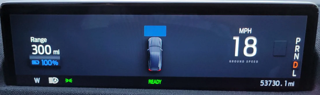

If you are getting 30 miles or better for every 10% of charge then you are right on track.
The GOM gets better the more you drive it. I have never reset my driving history. All that does is put you back to square one and you have to build a history again. My GOM is very accurate.
Ford Mustang Mach-E GOM estimates wildly off or battery issues? 1666222678979
