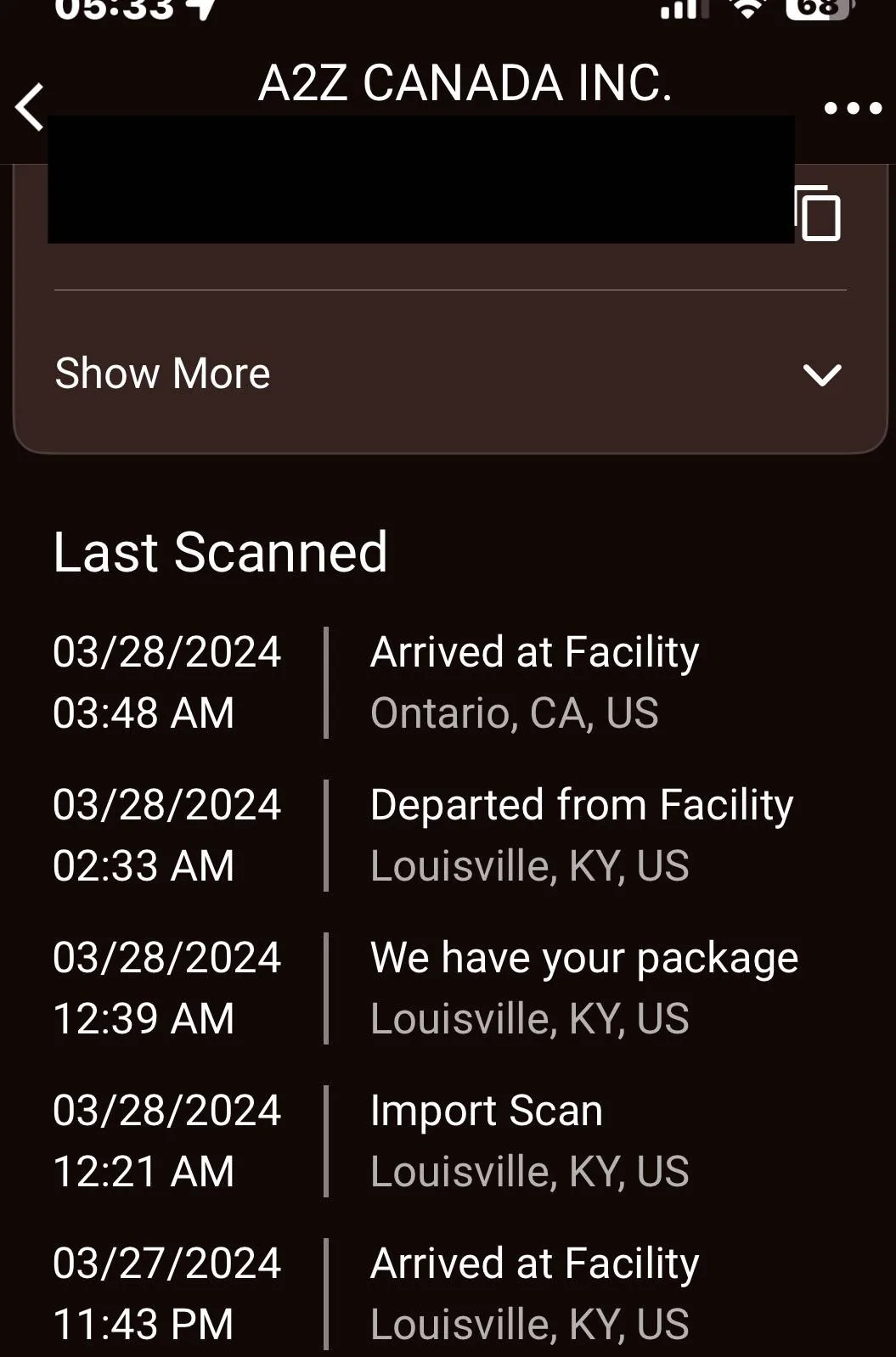

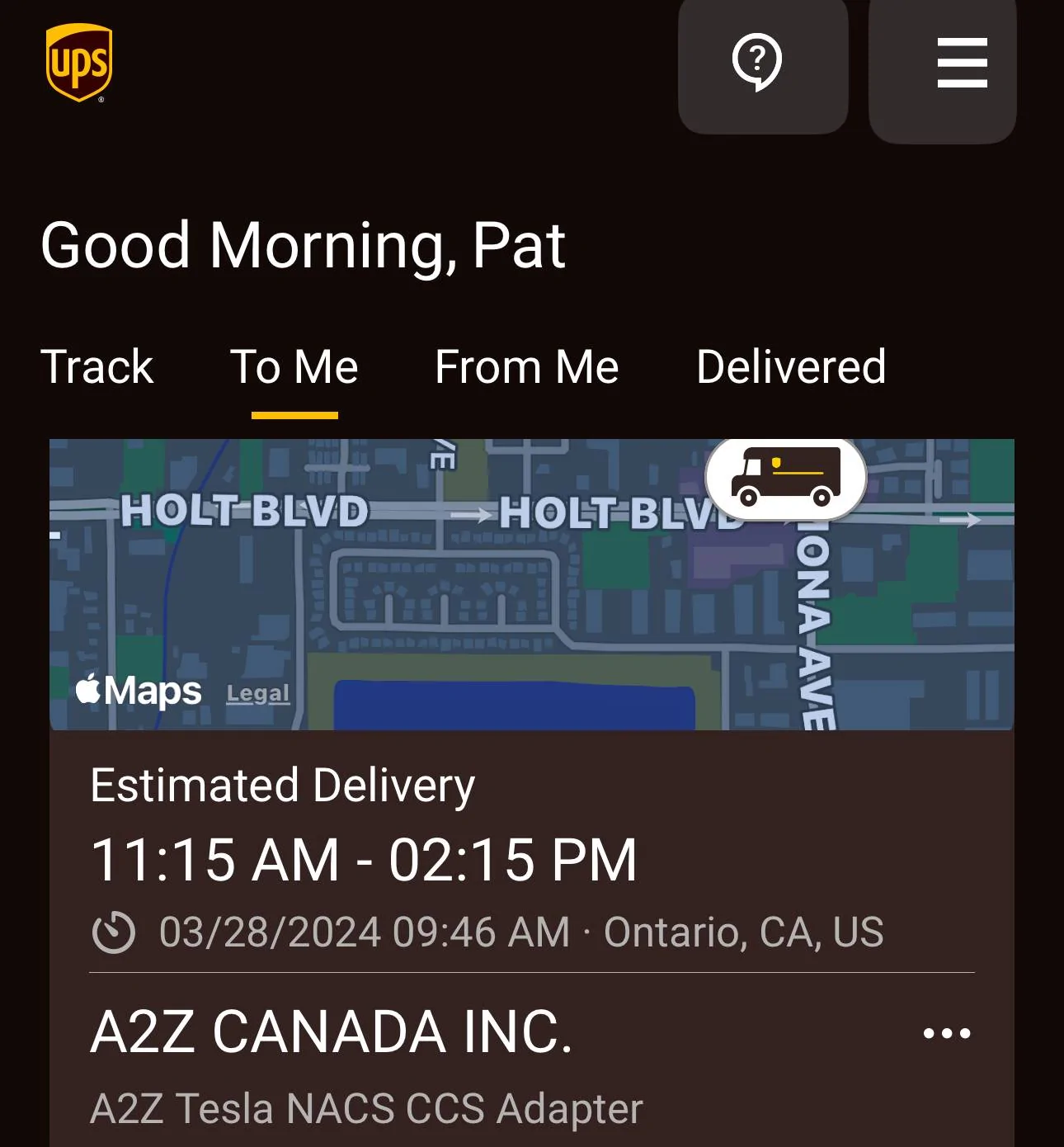

Getting Tesla Supercharger to CCS adapter from A2Z which is arriving today!
Perfect timing as I am going on a road trip this weekend and can't wait to use more conveniently located Superchargers off the freeways.
Past trips involved having to drive miles off the freeways to find open Chargepoint & EA which have been difficult.
Ford Mustang Mach-E Good Enough Substitute Until Ford Tesla Adapter Arrives? A2Z UPS overnight
