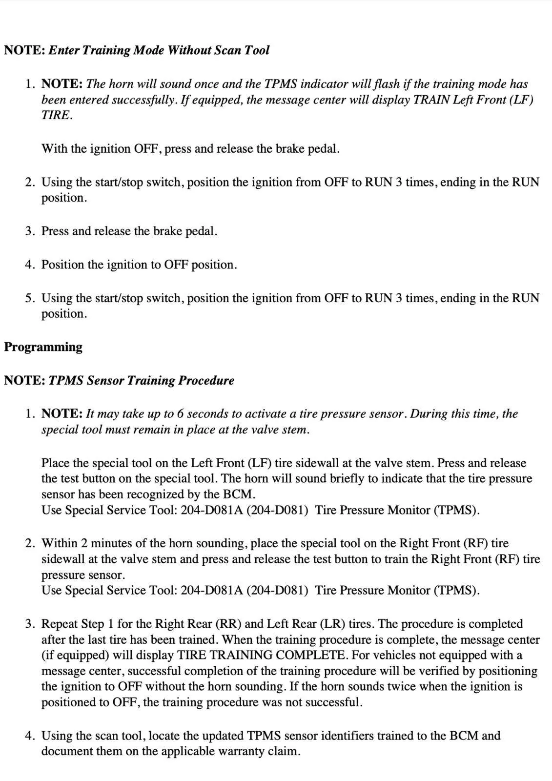

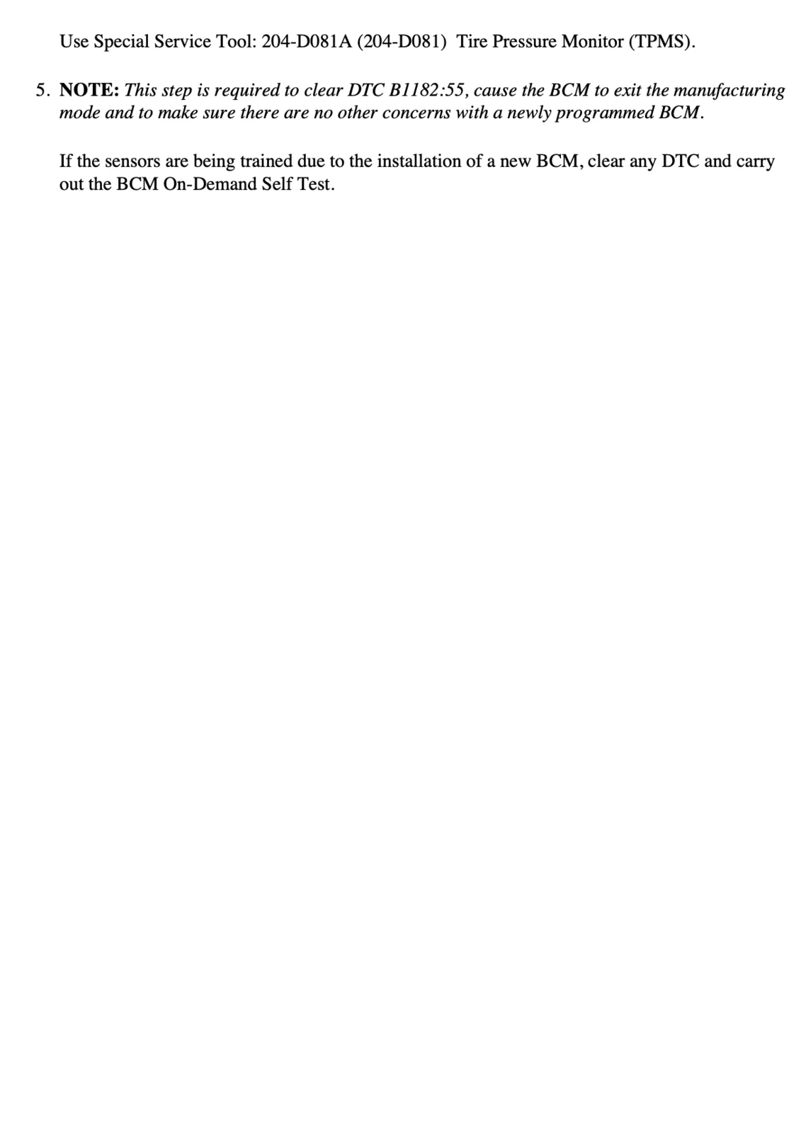

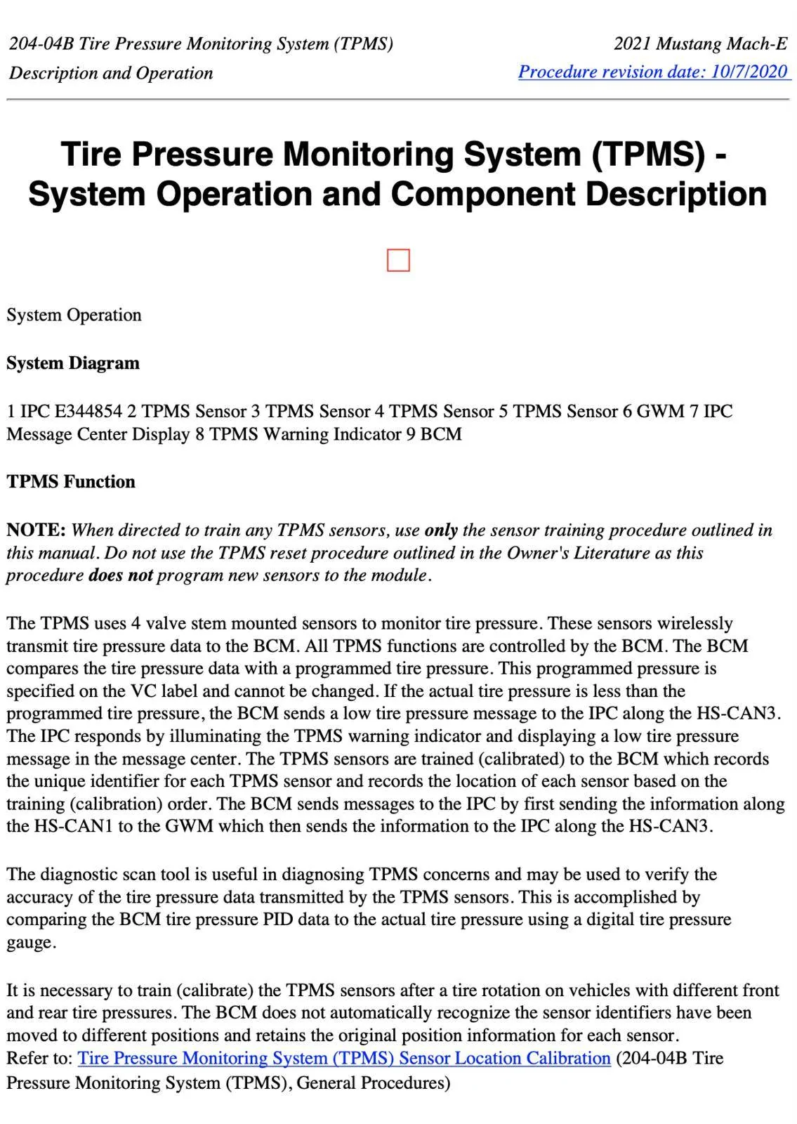

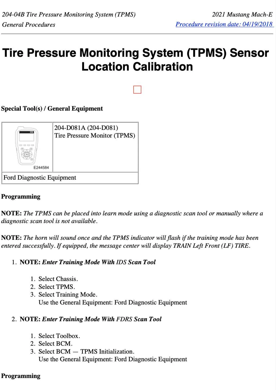

Actually this car (and all Ford's I have worked on at least) do not work like this. The TMPS's transmits data wirelessly direct to the BCM. There is nothing in-between those two devices. If you rotate your tires, the BCM needs to relearn what location the tires are in.
Below is from the Mach-E repair manual with an overview of how the TPMS works and detailed instructions on how to retrain the BCM to learn the location of the TPMS's. HOWEVER, there is a much easier way to retrain the BCM especially if you do not have the Special Tire Pressure Monitor Activation tool. Open the drivers door and turn on the ignition (do not start the car). Press the emergency flasher switch 3 times on and off. The horn will beep once and you will get a message on the center display "Train Left Front Tire". Go to the left front tire and let air out until the horn beeps once. This is usually around 30 lbs. Next go to the Right front and do the same thing, then Right rear and Left rear in that order. After you let the air out of each tire and it reaches around 30 lbs, the horn will beep once. When done, the display will read "Tire Training Complete". Turn off the ignition.
Just to make sure the car didn't not recognize which location the tires were in, I switched both front tires around to see if it knew where the tires were. I just got through swapping the front springs out on the car (I will post this in another thread tomorrow) and had not put the tires back on yet. I have 40 in one tire and 32 in the other. The car didn't recognize that I switched the tires.
On another note, I have in the past couple of weeks replaced the tires and wheels on the car a few times with new TPMS's in each set. They are not the OEM Ford TPMS's as I like the short metal stem once rather than rubber. I do not have to train the BCM to recognize the new sensors. As long as they are 315 MHz sensors, it automatically pairs them however you do have to train the BCM to recognize their location as I mentioned above.

Thanks for this. I had assumed the Ford TPMS system worked like Chrysler's but I guess that was a bad assumption. I just ran through the relearn procedure to test it, and it worked exactly as you described. I have an Autel TPMS tool, so it was easy to trigger each sensor without having to let any air out of the tires. I'll just add that quick relearn step when I change over to my winter wheels/tires.

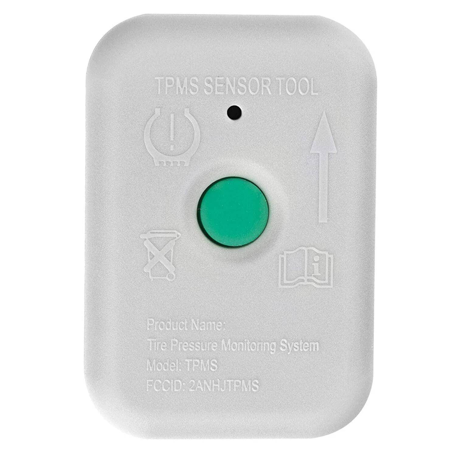

So I've got one of these left over from my previous Mustang:
Ford Mustang Mach-E Got my new wheels for winter 1618879492467
Which was used to train the tires with an identical process to that described above.
Any idea if this will still work on the TPMS sensors in the Mach-E?

If it’s 315Mhz it will probably work to trigger the sensors. If not, you can always fall back to the process of letting some air out of the tires.

I have one of those also but did not have to use it. I have run two different sets of non OEM 315 Mhz TPMS's and the car learned/paired to them right away. All I had to do was teach the system which tire was where.
