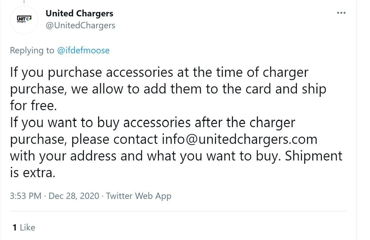

Disregard - I answered my question by searching Twitter...
Ford Mustang Mach-E Grizzl-E Lock? 1621447133671

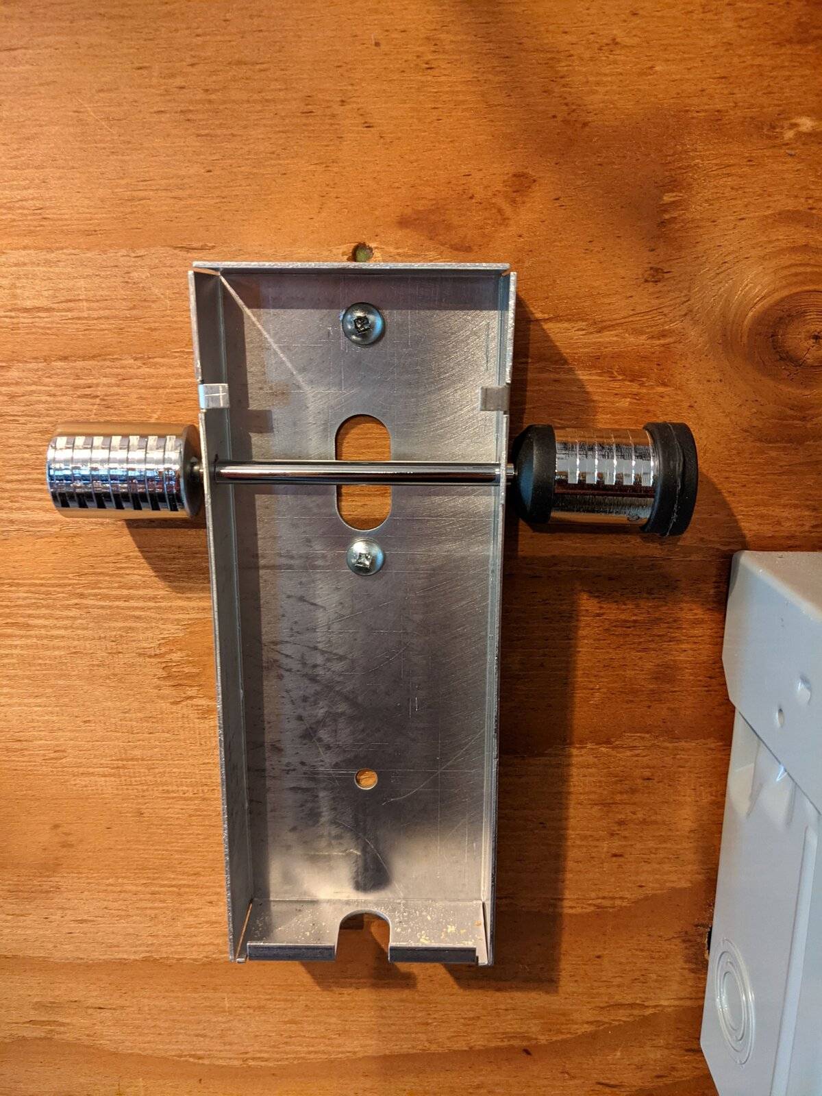

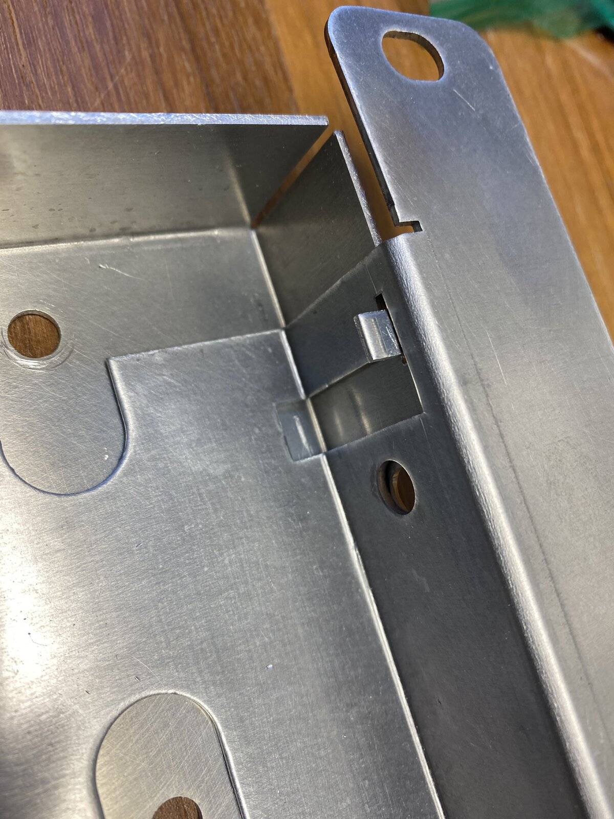

I’m not sure of an off the shelf solution…you need a long rod that passes through these holes on both sides:
Ford Mustang Mach-E Grizzl-E Lock? 1621447139889
However, the screws attaching the charger to this bracket pass through that slot at the top right of this picture…with the right tool, they could still be removed.
One way to lock it, though, would be to lock the actual NEMA 14-50 box. If using the common gray one, it has a hole for a padlock and once secured, the cover cannot be opened…and this will prevent the cable from being unplugged, tethering the charger to the box that way.

Hi All,
I have a Grizzl-E Smart EVSE that just shipped and, looking at the site, I just realized that I did not order the lock adapter for it and it looks like you have to order the lock at the time of EVSE purchase to get it. For anyone who owns a Grizzl-E charger, is there a way to use any other sort of lock with it or do I need to beg the company to let me somehow order the lock, even though the site won't let me?
This trailer hitch coupler lock works perfectly, I wouldn't be surprised if they designed the mount to use a coupler pin.
Ford Mustang Mach-E Grizzl-E Lock? lock1
Ford Mustang Mach-E Grizzl-E Lock? lock2

I placed it tight to the disconnect box and put the hairpin in between the two. Yes it was difficult to put the pin in with needle nose pliers and a mirror, but you would have to unlock the disconnect to remove it as well.
