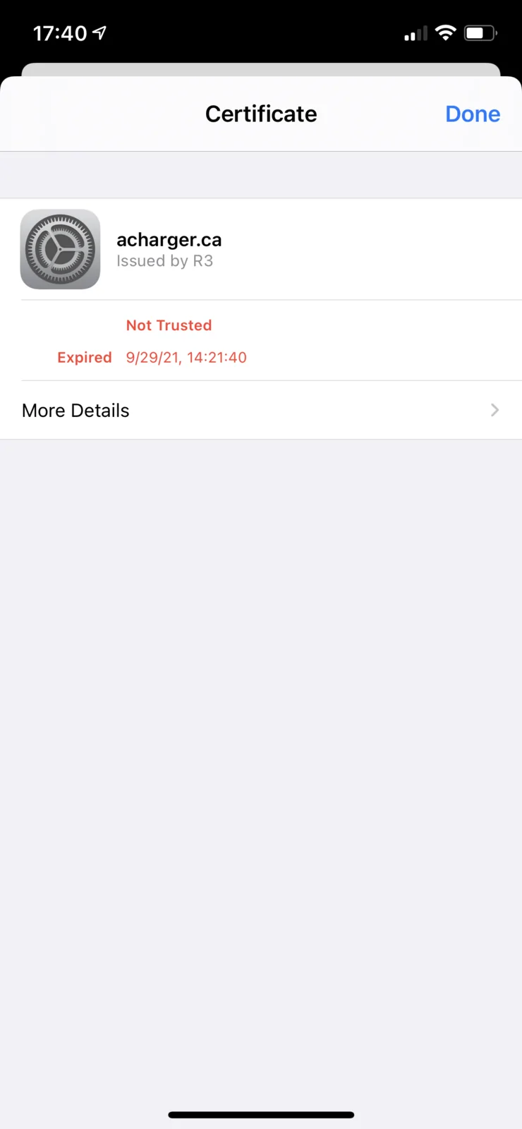

on another note - it seems the acharger.ca cert has expired. Has anyone tried to login to the portal recently?

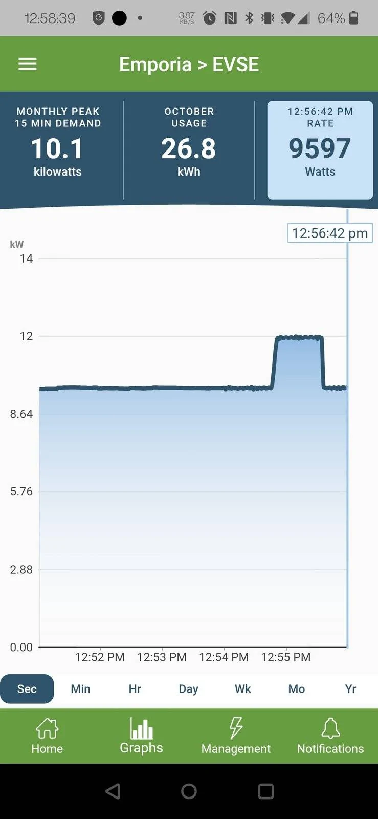

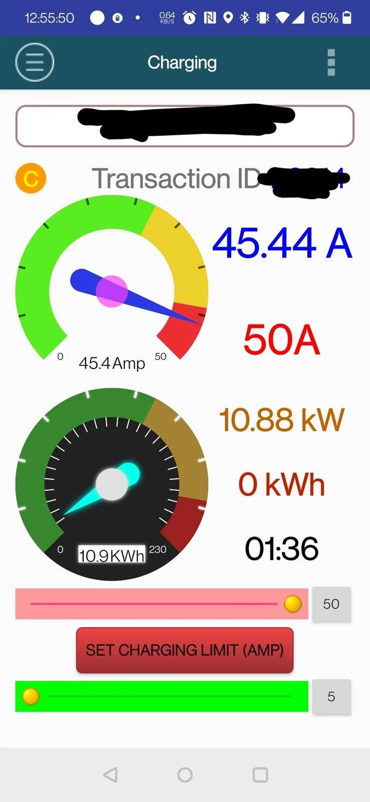

Anyone play around with the Smart EVSE app?
It allows for setting the max current to 50A...
Needless to say I did not leave it on there for long, but can verify that indeed, the Grizzl-E Smart can output more than 40A.
