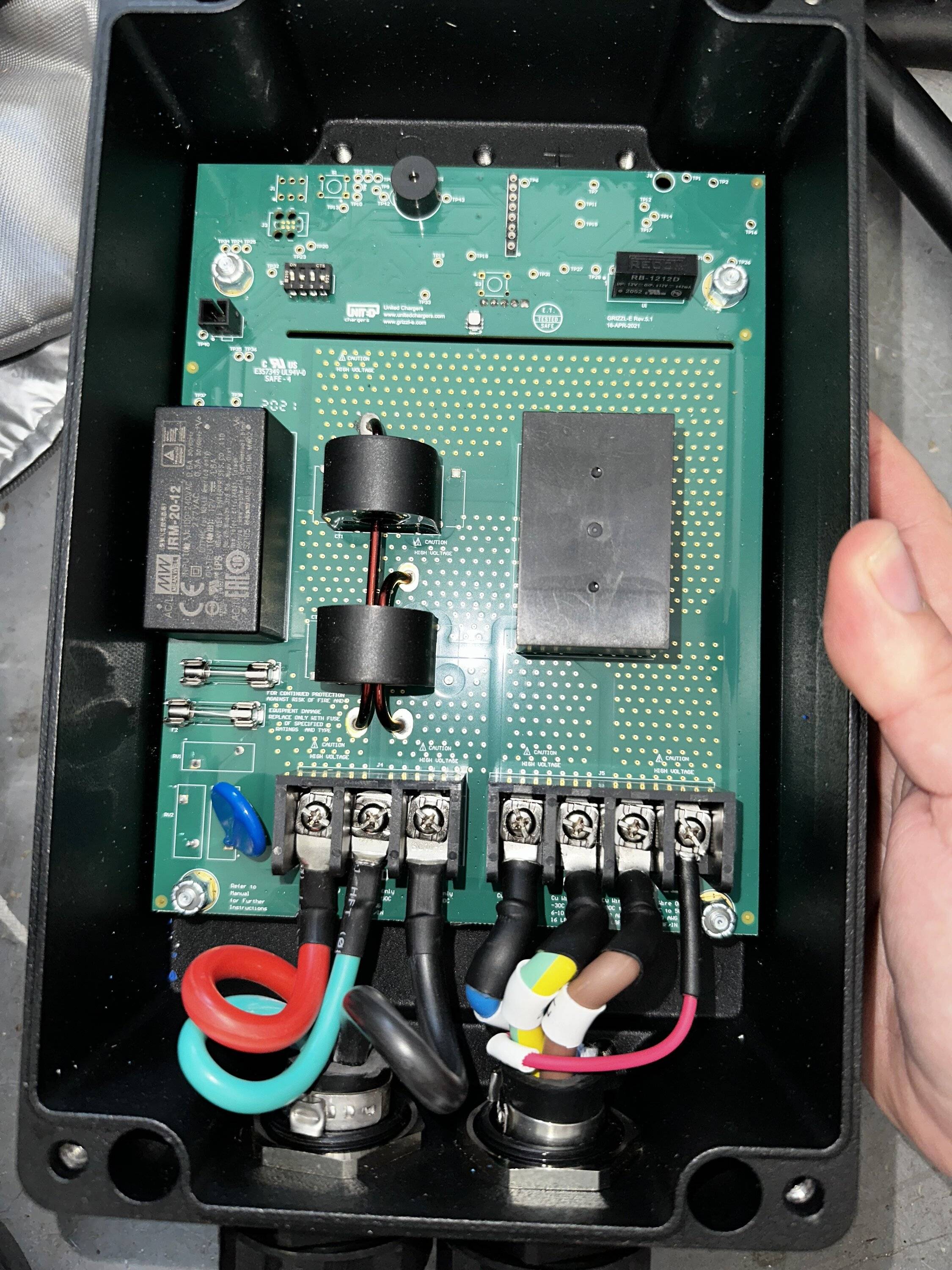

I’d be curious to pop the cover off and look for any burn marks.
I opened it up and don’t see any visible damage, my guess is the switch (the box on the left) went bad?

Take those fuses out and test with a multimeter. It may not be visibly blown.
I probably would do that if I didn’t already have one on the way, good to know if it happens again, thanks!

Tap on the relay on the left with a screw driver handle....the relay could be stuck shut and a little vibration might make it open back up. My dryer has this happen on occasion lol.

The cube on the left is a 12V power supply that powers the electronics, not a relay. If that’s dead, then nothing will work.
Ah I thought that was the relay, the issue is obviously not something I can see haha
Ah see, I follow caveman logic. Black box smash, me electrician.
