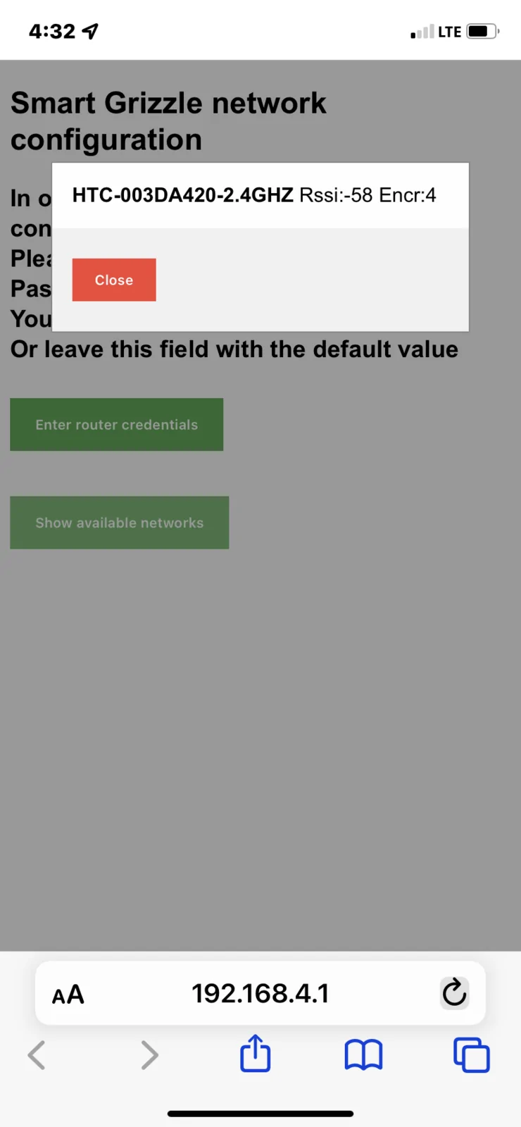

Here s a pic of the signal strength

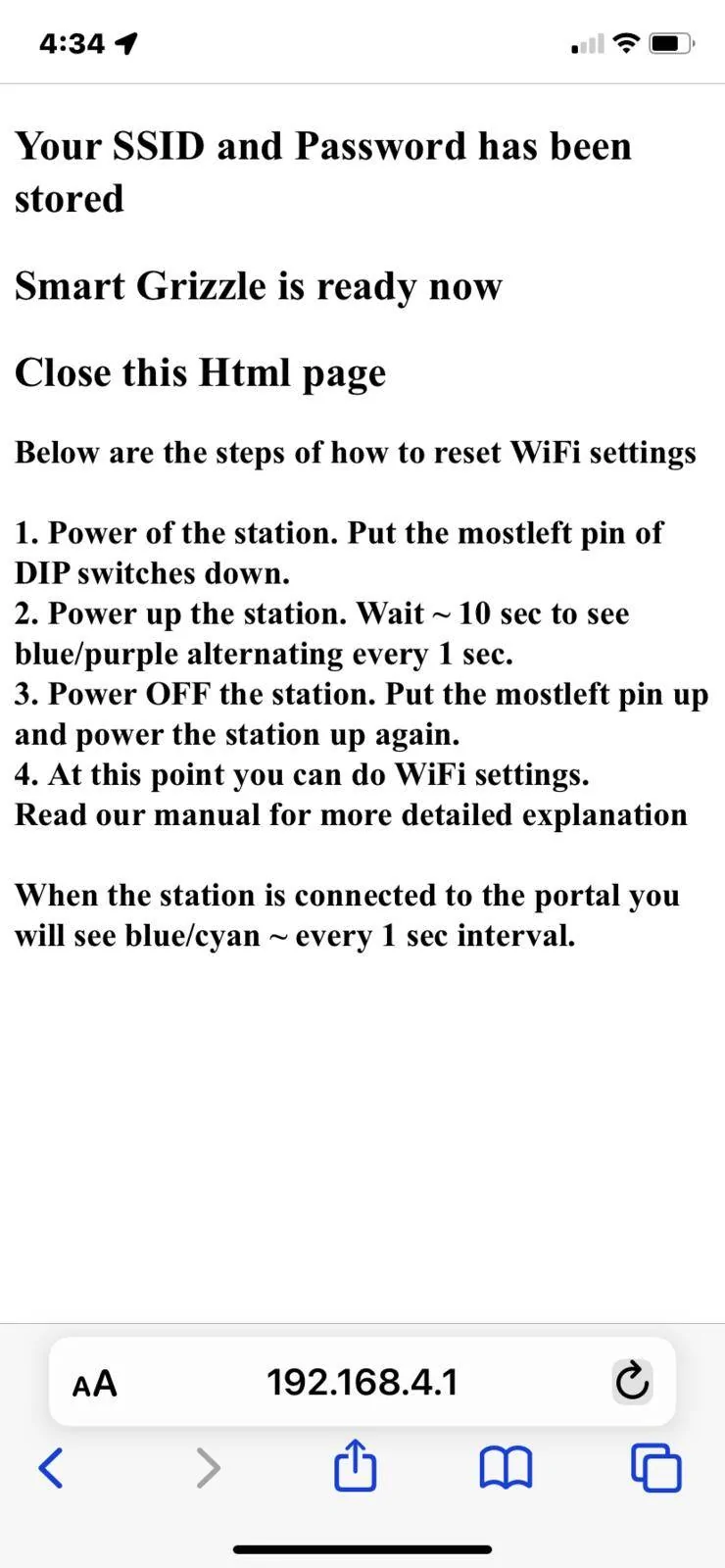

And here's the message I get after entering all the info
Ford Mustang Mach-E Grizzl-e Smart IMG_2045
It should work at that point, but ......no
