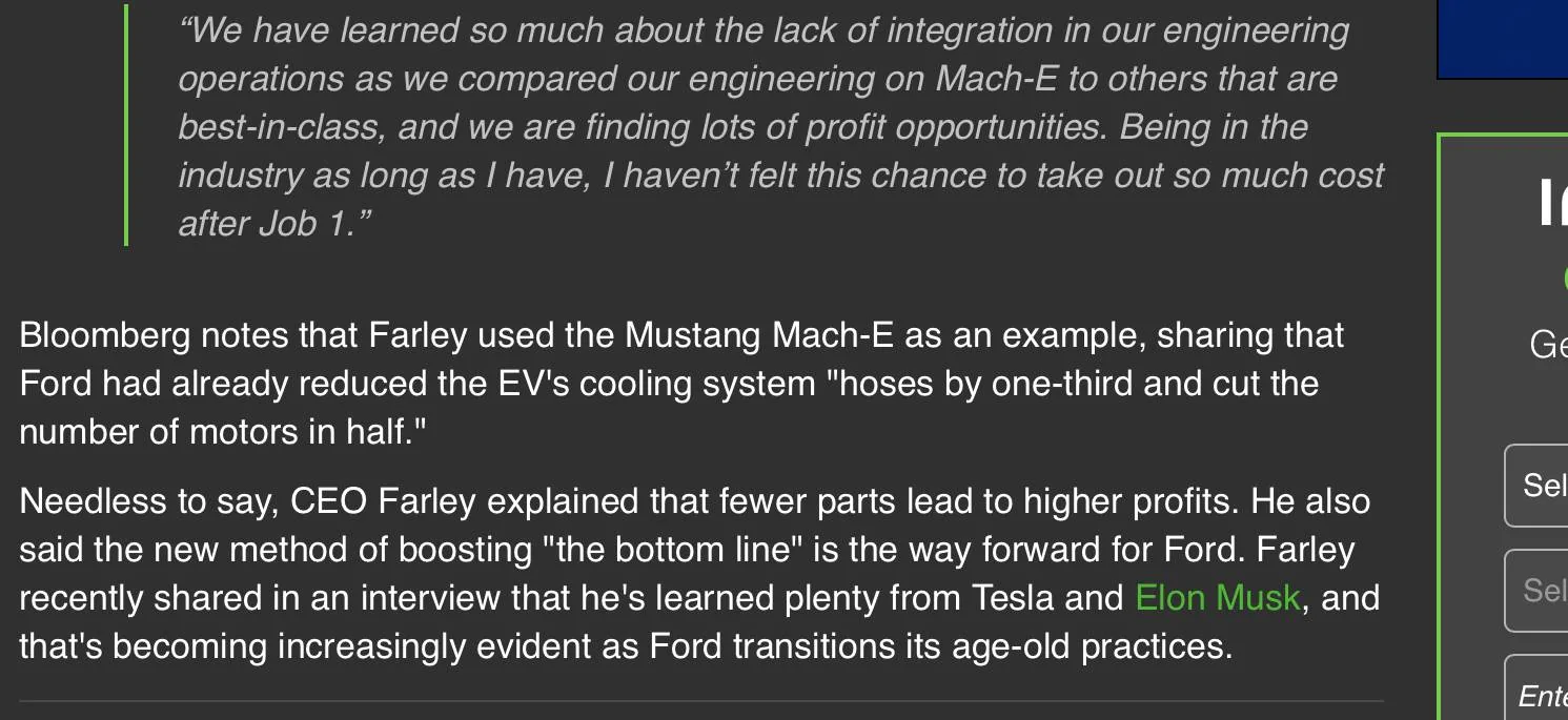

Wasn't the cooling system where Ford value-engineered out a bunch of components last year to save costs?
Edit - this is what I remember. Not sure it has any bearing on these failures.
Yeah I believe they went to one component (forget which one specifically) instead of two for that system, they said it was overly complicated in first builds
